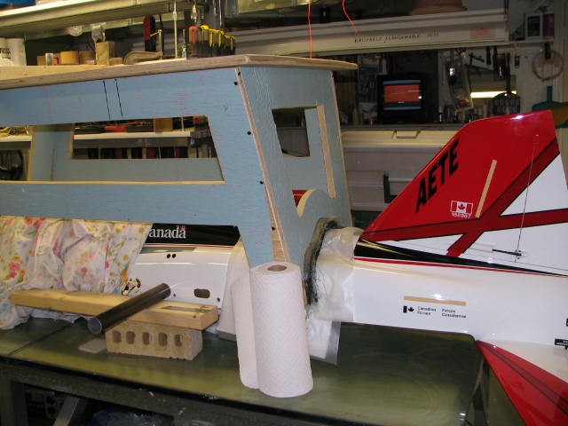

HI, I did the same the other day, just a tad less hardener and will not cure.
Best solution is to get MEK or lacquer thinner, remove as much as possible and grind the rest off. Start fresh or you will have a losing battle.
Rcpete

HI Rich, these are my transport stands, 3 made so far, 8 to go.
Rcpete
