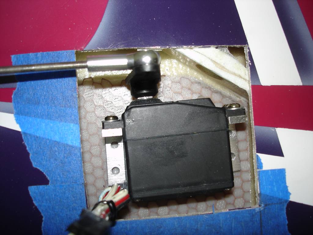

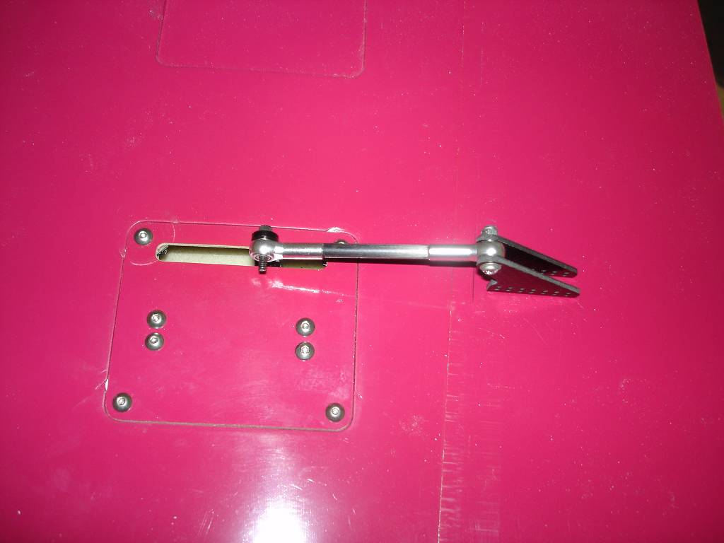

I use 4x40 thread rod all the way and insert it in to a 3/16 c/f pushrod and some thick C A and it work great for me

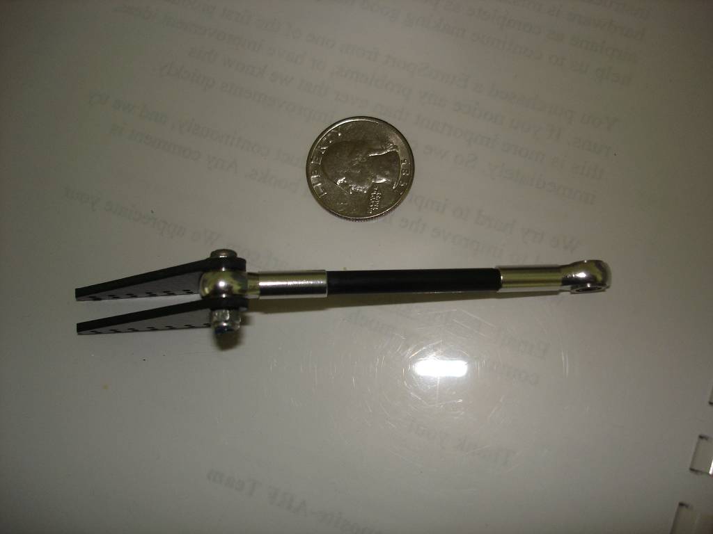

Tuan
Where did you buy those rod ends??

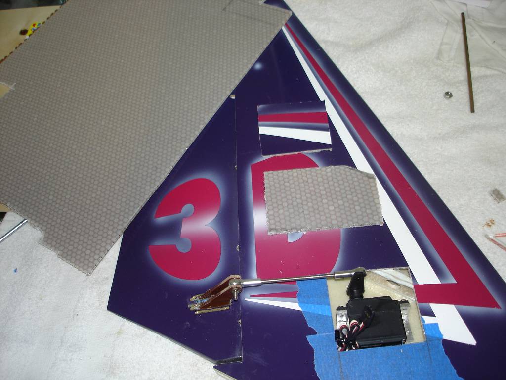

MEESH, I got it from Dream Work , I use them on my patern plane and all of my jet , no slope on your control surfaced specaly on the one I'm working on rigth now
