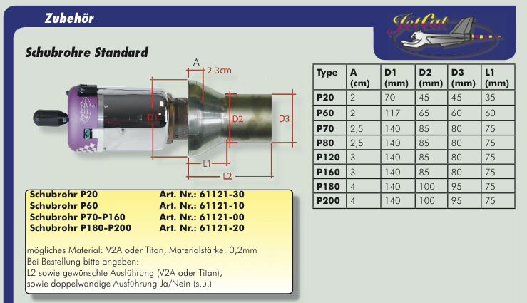

Hello everyone, quick question, I have been searching rcuniverse to find the correct spacing for jetcat p200 from turbine exhaust cone to thrust tube inlet, jetcat manual shows a p80 with a distance of 20mm but from looking at rcuniverse there is a variation of 20mm to 30mm any ideas?
I may just have to go for the average and place it at 25mm
Thanks in advance for feedback/ideas

On the Ultra Lightning/P200 25-30mm would be about right.

Steve, here is the JC info..
