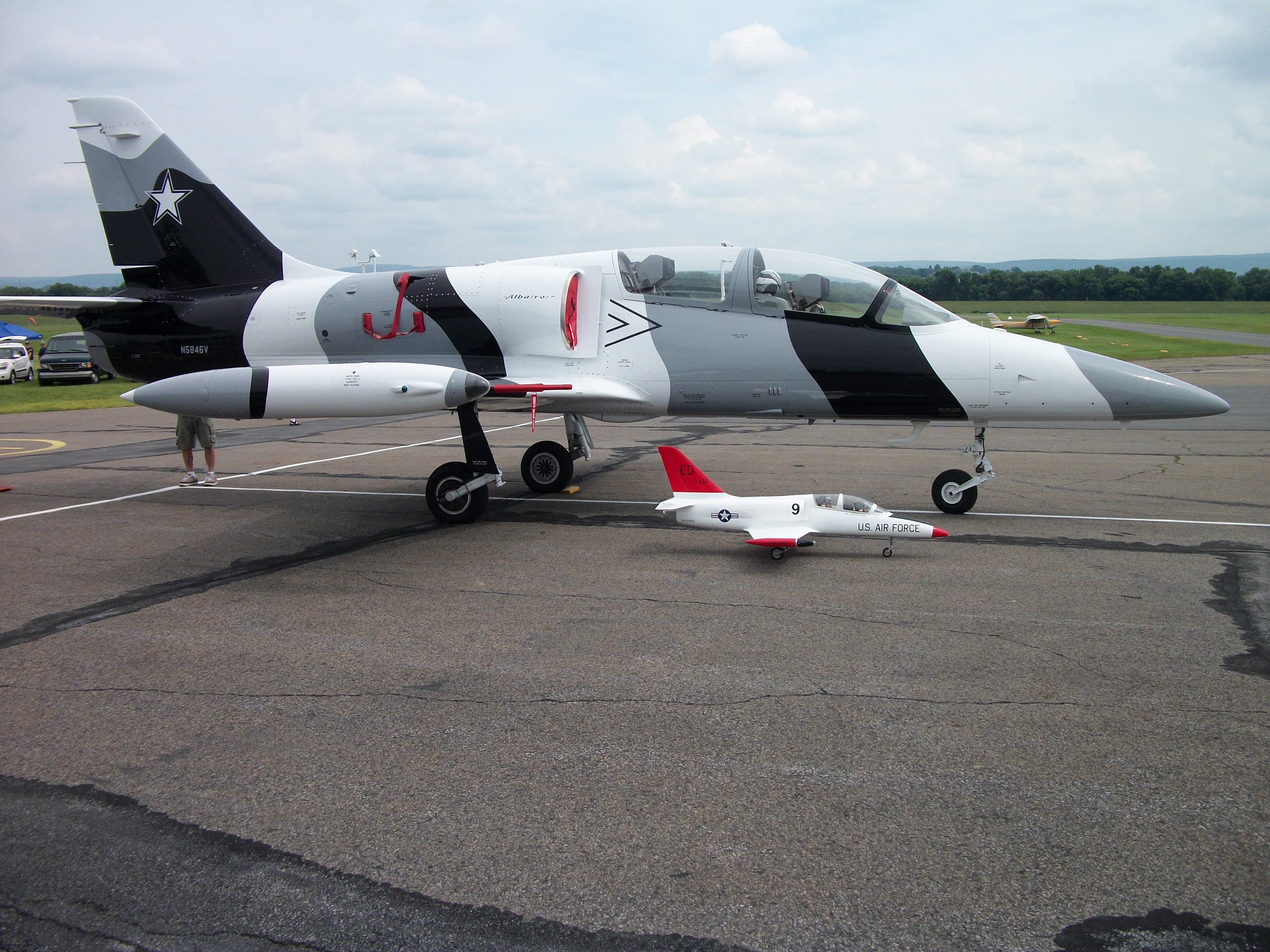

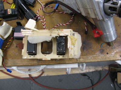

Had my SM L-39 out the other day, and just a static display, I started mine up and taxi'd it out to the tarmac to park it next to a full scale L-39. a few hours later I had to start it and bring it back. About 15 minutes later,
As I parked it in the pit area, I left the radio on, leaving the cool down sequence to finish, I walked a short distance away to watch the L-39 do some fly by's. I see over in the pit area a few guys around my L-39, then I see one of them running with a fire extingusher towards my jet. I get there, look for anything, pull all the batteries out, then I start digging.
What I found was a burnt out servo Hi-tec HS-5475HB. These were Flap servos....
Tonight i had a chance to really dig, not sure if the receiver went, servo went????? Both servos were locked up, no movement by hand, or by radio. I plugged two new servos in and it seemed just fine.
Anyone else have servos melt and burn up? curious as to why it happened........................

The fact that both servos were on the flaps and both burned up tells me they were binding....to have 2 servos both burn up at the same time "just because" is not gonna happen...I have seen that exact "melt" on the Hitec's once before....the guy had two of them on a rudder and they were fighting each other and smoked during taxi out....about 5 minutes worth...certainly no fault of the servo...it was 100% user error in his case.

The fact that both servos were on the flaps and both burned up tells me they were binding....to have 2 servos both burn up at the same time ''just because'' is not gonna happen...I have seen that exact ''melt'' on the Hitec's once before....the guy had two of them on a rudder and they were fighting each other and smoked during taxi out....about 5 minutes worth...certainly no fault of the servo...it was 100% user error in his case.
Totaly agree! There was binding against the end travel of the flaps.
.....it was 100% user error in this case.

well, I stopped at my LHS, who is also a jet jock like us, and went over a few things. Now, these servos have been in the L-39 for almost 2 years. never a problem.
1) battery voltage. I use Electro Dynamics Battery backer system, even with the 2 - 6.0 volt batteries my voltage to the receiver is constant at 5.50, there abouts.....
2) I used an inline meter to check the servo and the draw on power, making sure I was not binding.
when I started my L-39 and moved it up to park it next to a full scale L-39, everything was fine. and hour or so later, they asked me to move mine so they can start theirs and do some low fly by's at this event IU was at.
when I started it, I noticed the right flap was not moving, but left one was ok. I then brought the L-39 back by our trucks. I left it on maybe 20 minutes, forgot it was on while I watched this L-39 fly.
late last night, I looked it over and seems only damage is to the servos and nothing else.

NNo it is not, I bought this kit from Kerry Sterner and built it myself. also there is only 2 flights on the L-39, although built in the winter of 2009- 2010, just 2 flights on it last year and all went well. I have the same flap set up in another jet, I deploy the flaps a the same time as in all my jets, onlyy difference is the number on the servos, I picked up Hitec's 5645's today and tomorrow I will put them in the wings.
