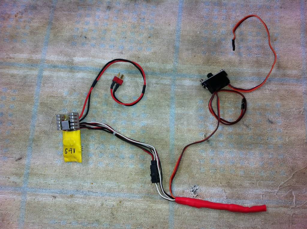

The builder certainly appears to have limited knowledge of RC models in general. The avionics fitout was a complete mess. I should have taken photos before I stripped all the valve gear etc out. The regulator for the receiver/servos is the dodgiest thing I have ever seen in my life. If I remember, I'll take a photo of it tomorrow and post it. All I could do was shake my head when I saw it. There were 2 lipo packs silicon glued into the nose, but no balance taps on either pack! I've removed enough 3-way tee fittings from just the cockpit area to be able to redo the entire model *and* have some left over, without counting the 6 or so more connectors I can see through the rear retract bay doors. The list of fitout issues is extensive......

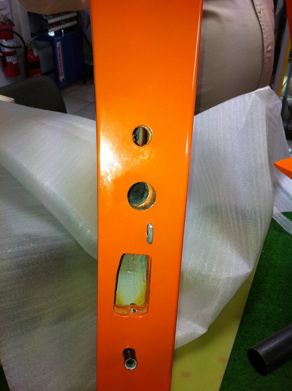

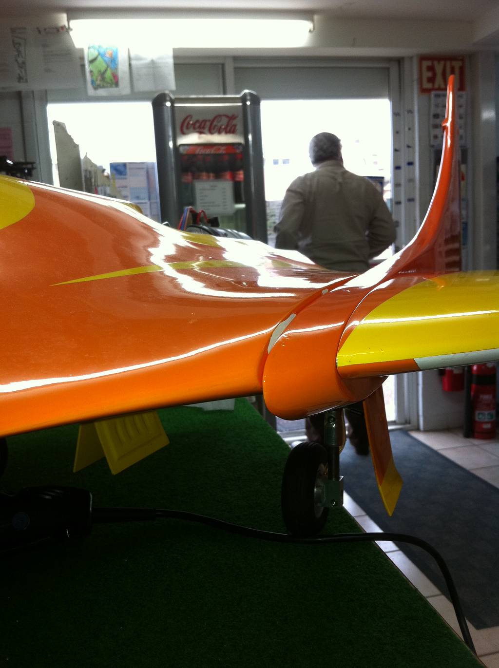

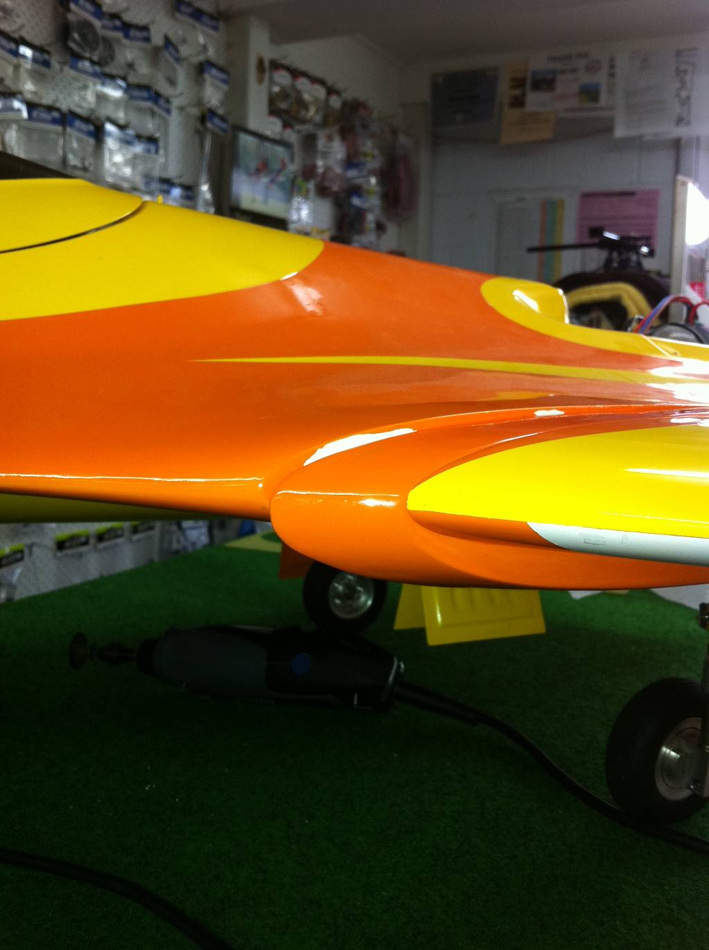

Well, the plot thickens.
We've managed to remove the elevator from the booms and then the booms from the fuselage. Unfortunately, he's really butchered the wing root on one side of the fuselage and he's stripped the screw holes in both wing retaining tongues [:@]. To compensate for this, he's simply screwed an angle bracket underneath both wings, bored a hole through each boom and bolted the bracket to the boom [X(]
I've attached some images for your viewing pleasure.
The regulator is a real piece of work. There's a single input with multiple outputs. All the outputs have been tied together via multiple double-adaptors and then into a single JR switch harness
The butchering of the wing root of the fuselage is what worries me the most. The hole goes all the way through the edge of the retract mounting box. So, the bottom corner of the retract mount is no longer there. I think this is probably repairable if the hole was filled up with hysol or something and then re-slotted for the wing retaining tongue, but both tongues will need to be removed from the wings and turned around so they can be re-drilled and tapped [:@]

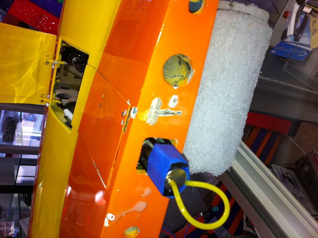

The plot thickens even further. We just received a new pair of booms from FeiBao, but they don't fit the rest of the airframe [X(] Pix attached to show the issues. I'm lost from here.....I really don't know how to go about rectifying this. I've emailed these photos to FeiBao but received no reply yet. There are some obvious differences between the old and new booms. Most notably, the new ones have the rudders live-hinged, whereas the old ones were mechanical hinges. Ditto with the new horizontal stab and elevator. If I lay a new boom over an old one, the holes aren't in the same place either. It's not far out, but it's obviously out enough that they don't suit the wings/fuse we've got
I suspect the Velox we've got is a very old version and had been sitting around for a long time before being sold.

If my memory is correct there is one incidence peg on the boom as well as the holes for the wing tube and the recess for the retract cylinder.Unless Feibao have done a major re-design I would think you could get away with re-positioning the incidence peg in the boom or fitting the incidence peg in the wing root and making a new hole to suit in the boom and glueing in a carbon tube to suit the incidence peg. Even if it's not very neat it will be covered up when the wing is fitted.
John
