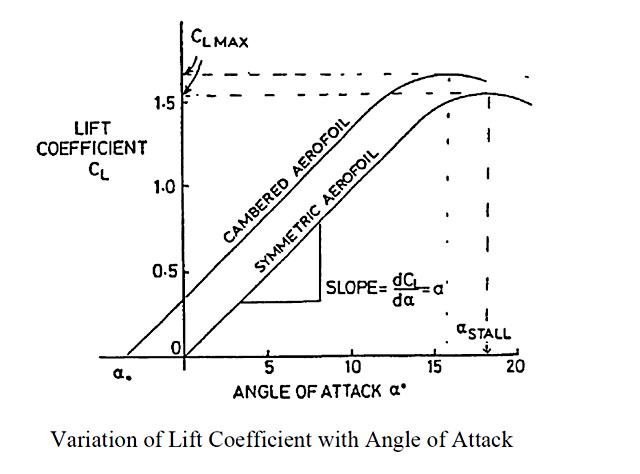

Interesting question. This is what I can say. When ailerons are in up position the lift coeffient (Cl) of wings decreases therefore stall speed is higher. Drag benefits on ailerons can only be achieved when alpha is low. The only advantage you'll get is higher stall angle. If you want to slow down on landing don't use this on final or instead use it moderately on opposite (downside like flaps). Advantage: higher Cl, higher drag at high alpha. Disadvantage: lower stall angle and rearward center of pressure (pitch moment down). You may use this braking method (crow) with flaps on low alpha descend with caution.

The reason you might feel for a lower stall speed is because of the center of pressure shifted forward where you got higher lift at positve angle. Sometimes we feel losing lift when deploying down flaps due to moment effect but the reality we gain lift, opposite to the crow.

The increase in stall speed with reduced camber is an aerodynamic fact. Your perception might be different though.
I hate to add my aerodynamic explanations here as there are others who are far more knowledgeable than me. However, using crow effectively reduces the camber of that area of the wing where the ailerons are. As seen from the graph below, reduced camber will cause a reduction in the maximum available CL before stall. This means that the aircraft will stall at a higher speed. However, the angle of attack at which this will occur will be higher.
Therefore, I guess it is possible that you may have the illusion that the model is flying slower due to the higher pitch attitude but in reality it isn't. The theory is probably irrelevant anyway as the numbers will be tiny for the situation we are discussing. This is made somewhat more irrelevant when combined with the knowledge that most people make their approaches miles above the stall speed anyway.

Flexing BOTH ailerons up makes "lift in a downward direction" along the portion where the ailerons are located on both wings simultaneously. Still with us? You sure? Great, you're almost there, so hang on.
With both ailerons flexed up part of each wing dedicated toward making "downward lift", and there is less wing on each side still making "upward lift".
There is no way, none, that an aircraft in this configuration has a lower stall speed. That. Is. Physically. Impossible. It may indeed be flying more slowly than without the reflexed ailerons simply because of the extra drag, but the stall speed is higher. Not lower. Period.
Sorry, I'm not picking on anyone. I promise. The physics just is what they is.
If I learned anything from the now infamous "Downwind Turn Myth" thread though, it's that some will deny the truth at all costs rather than even contemplate the possibility that they have been operating under false impressions or assumptions. Them folks just is what they is too, so God bless 'em!
Why is washout so important on modern airplane (with reflexed airfoil, ((only towards the outboard span of the wing with a negative incident)) ? A: to improve low speed handing
Perhaps you could use a electic foamy and increase lift (incident) on the outboard only, to find out it will do nothing but to snap into uncontrollable spins like crazy at low airspeed
