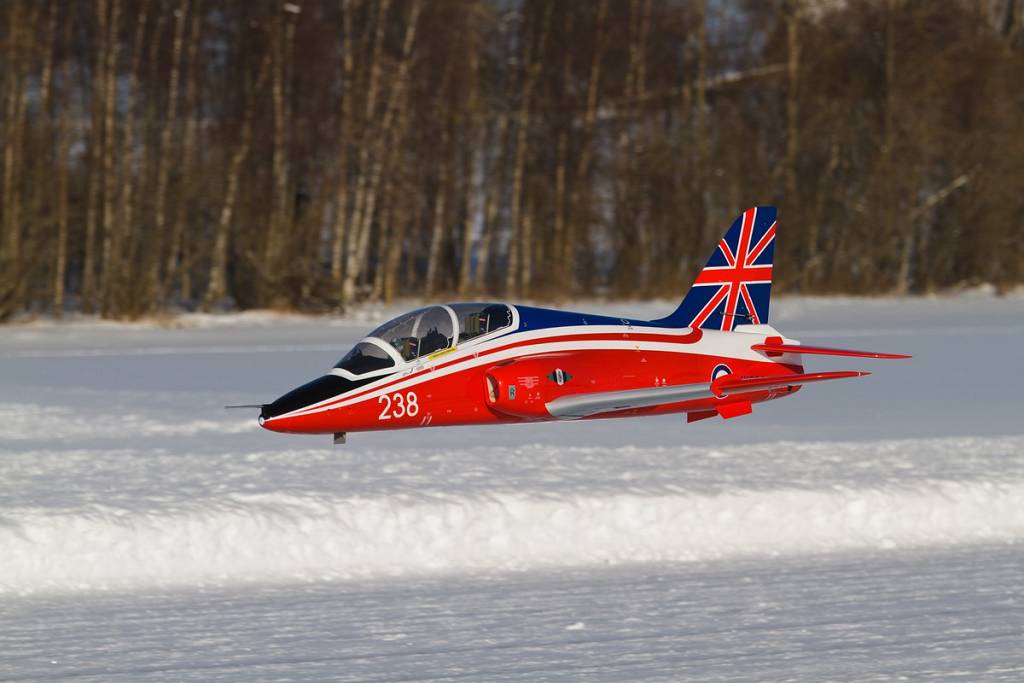

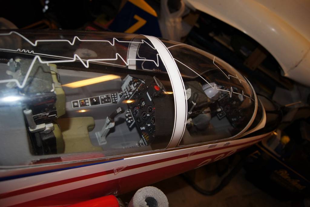

The large Skymaster Hawk cockpit fits very well. The only drawback is that the chairs are a bit low - the pilot should be higher to be scale like:-)
Here are some pictures of my old Comp-arf hawk
Thomas Lorentzen
