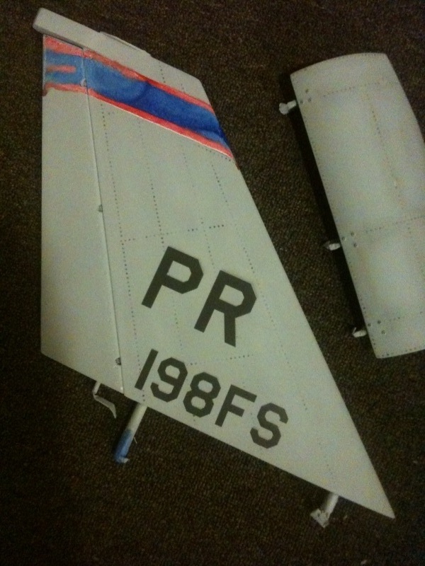

Tried to flat clear my Aeroloft dry transfer on my F 16, & this is what happened[] It took the steam right out of me.. Has anyone seen this before? Any good techniques to help me avoid this?
Thank guys!!!

My guess would be that the clear was put on too heavy and too quickly not giving it time to burn off the solvent which then went after the transfer. I have had this happen many years ago. I don't use Aeroloft but I would think that most dry transfers would work about the same. You need to apply it in light coats to keep it from floating off the transfers.

Unlike Pro-Mark transfers, Aeroloft transfers are susceptible to dissolving in alcohol, acetone, and most ethyl-groups. When you get your transfers from Cindy in the mail, there are instructions included on what NOT to use. Did you per chance have any solvents in your clear? If you used something like Krylon, Rustoleum, etc, 90% chances are there are solvents in them.
I coincidentally just applied my Aeroloft transfers for my Stars and Bars to my BVM F100 last night since I decided against using the Paint Masks that I got with my Pro-Mark transfers (too lazy ) I had to use a non-acetone based Matte Clear on them.
I had to go to an art store and purchase special clear that is "odor/acetone/alcohol free". Aeroloft transfers are quite different from Pro-mark transfers (which I also happen to have on my F100 for nomenclature purposes). The Pro-Mark are much more resilient and can handle an acetone based clear.
Kelly is a master at detailing and adept at Flite-metal and in fact was a great aid in getting my Pro-Mark transfers to work for me, but Aeroloft is just more delicate. Make sure you read the back of the can you are using. I suspect that is the problem.

Because of the fragile nature of the Aeroloft transfers I never use anything other than Pro-Mark. Yes, as Kelly said it is all due to the solvents in the clear. If you use the Aeroloft you need to mist on the clear for a number of coats to get the job done. The Pro-Marks cost more but are much better in this case overall.

Thanks for all the help guys!!! It was pretty easy wet sanding the messed up transfer off. I tried ordering promark 1st, that what I've always used, but it was complicated to order from Jerry this time.. I forgot why, but I tried twice. I thought Aeroloft was the same, but now I see different.. I'll post if next shot on the opposite side works.. I reordered both sides again incase it doesn't.

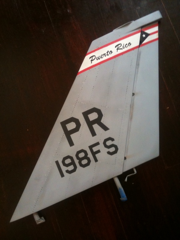

Yeah, I guess you can say it worked. I ended up using a combination of David's (Falcon wings) & Kelly's techniques to get it to semi work with the dullcoat. The edges of the red still bleed slightly, & very lightly faded even with light coats. I may get the red monokote tape & place it over the red, but since I'm doing a battle worn 16 anyway, the fading is kind of growing on me. This is the 1st and most likely the last time I'll use Aeroloft transfers.. I'm use to Promark's, buy it, press it, clear it, fly it. I've never dealt with this & it's scary knowing I still have an entire plane/armament to deal with this mess

Hey looking good!
We need to do some formation flying one day!
Dough!! I sold mine. :-)

Lol.. Thanks bro.. Not bad for a stripped down Tamjets $550 "scratch & dent" kit
