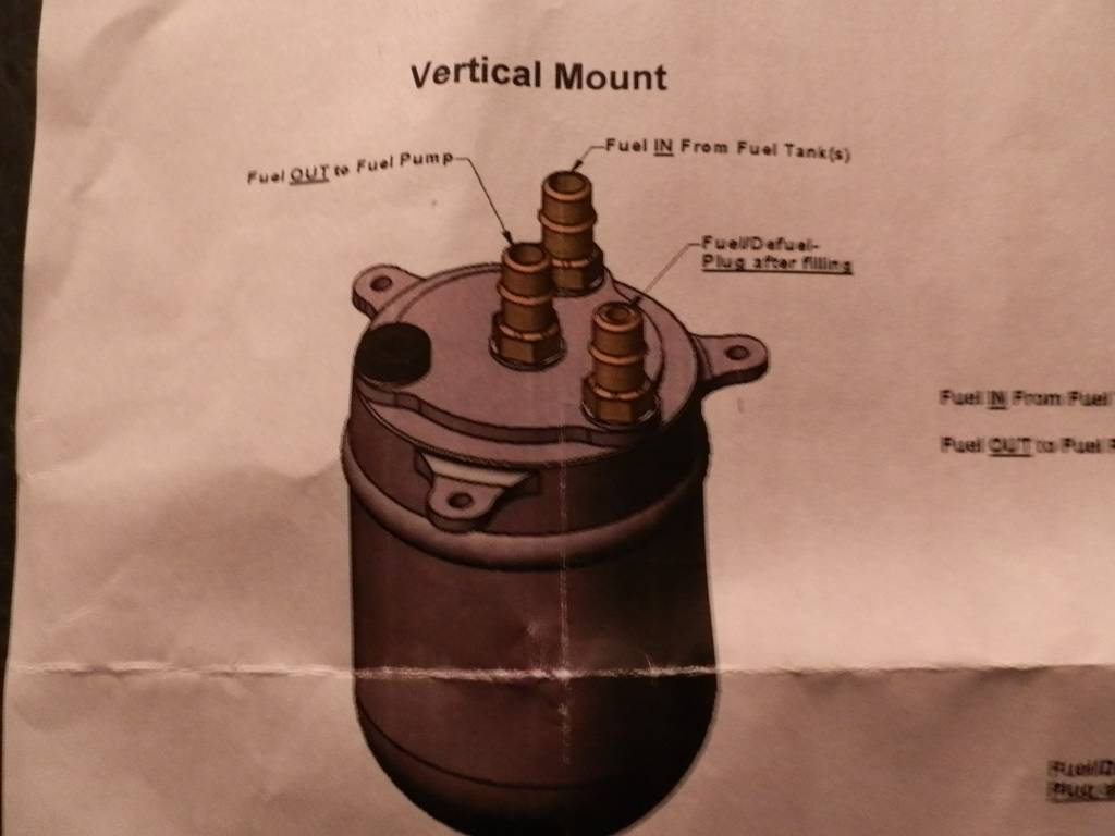

I am installing a JMP accumulator with a p200sx... can I have the instruction sheet that came with it? Need to know which nozzle goes where....

This should do it.

thank you..

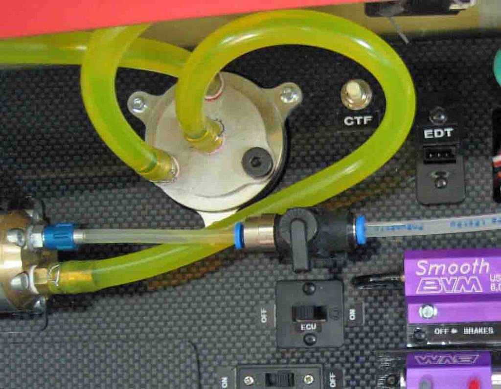

any preffered method of installation?  Vertical, horizontal etc..

JMPmakes them specific for a vertical or horizontal mount. - You need to find out what version you have. I may be wrong, but I think it's just a matter of what fitting isupon the horizontal.

Probably easier to mount it vertically, if you have the space. Here's how mine looks in my UB.
