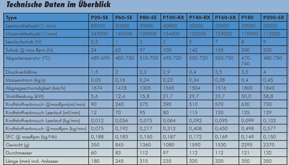

Hi, just a couple of points I've noticed, the 100 is the length of a p-60, and the width of p-70.. It's surprisingly light, with a small downside being the fuel consumption, at wot I believe jc state 390ml/m, compared to the p-80, that's a big difference.

The Jetcat website states 350ml/min at full power for the P100. In comparison the Wren 100 is also shown at 350ml/min and the Merlin 100 is shown as 360 ml/min. Neither of the latter 2 are considered to be thirsty engines so, if the Jetcat specs are correct then it is ok. If I was a betting man I'd say that the P80 specs are not accurate and it is actually thirstier than Jetcat claim. My (very old) P80 was certainly not very fuel efficient.

Figures mean nothing unless you fly flat out the whole flight! Yes, P-80 was much thirstier than stated. The P-80SE and P-100 are close, my flight times are very close

I had a non se p80 and replaced it with a p100. My fuel burn is very similar to when the 80 was in there but performance is very much improved.

I saw that originally but in the p-100 manual it states 390, in the jetcat catalouge, it also states 390.. Maybe a mistake somewhere along the lines but either way im not running it @ 100%.
screen shots added from the catalouge...
