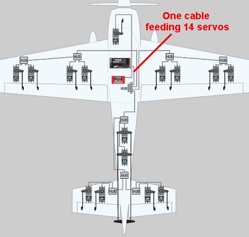

For years now everyone building jets has been obsest with big powerful servos and powerboxes with dual batteries and even using two receivers etc, all to increase safety and reliability. And now for some reason Futaba have conned futaba users into thinking it is a good idea to run all the servos on one lead!!! Just Crazy, loose that connection and your plane is dead!
With a normal standard and safe system, if you loose one flap, one aileron, one rudder, one battery etc and you more than likely will get it down wth no issues, but with Sbus it is a crash full stop.
Both the pic and diagram below come from futaba one example even has 14 servos all being fed from one wire coming out of the receiver, this one wire is also giving the power to the 14 servos which is even more mad especially if they are high torque digitals.
Can you imagine when using a standard receiver setup, having 14 servos connected in a multiple amount of Y leads, and then connect all that to one extension lead ! craziest thing I have ever heard.
Now of course futaba tell you you can remotely power the servos by plugging a battery into the hub, yes great idea to put a battery in the tail, really helps with CG does that!
Please someone tell me the advantage of Sbus, yes one servo lead from your wing would be nice but again do you really want to run 4 or 6 servos in a wing on ONE lead and connection ?

Why do so many people think that one battery can only be plugged into one hub?
The battery leads can be as long as you like. The battery(s) can be placed wherever they need to be for balance, then you can run heavy gauge wire back to the hub(s).
The heavy gauge battery lead can then be tapped off of in several places to attach to multiple hubs. (think power bus)
I'm thinking I might used one battery attached directly to the receiver to power the receiver and any PWM servos attached to it, then another battery to power all the Sbus servos on the starboard side, and another one to power all the Sbus servos on the port side.
Not a perfect system, but it is still simpler than running long servo leads to each individual servo, and it has some redundancy (much more than I am running on any of my current airplanes), and it doesn't pull high amp loads through the receiver's bus.
I will also be considering the Robbe power system too, since it offers true battery redundancy.
Bart is talking about the Robbe version of the SBus power system, it has all the nice powerbox features but using SBus setup

plus they have another version that is designed more for large 3D planes, a simple hub/power supply.
ORIGINAL: Kevin_W
Why do so many people think the battery has to mounted right next to the hub?
ORIGINAL: Xairflyer

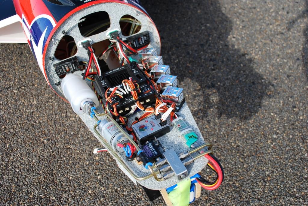

Fenderbean<p class="MsoNormal">I am actually trying to fit the Lado stuff into my F4 at the moment although I am struggling with room. The Lado works fine with S Bus and only needs the Futaba SBD-1 type decoder.</p><p class="MsoNormal">Xairflyer</p><p class="MsoNormal">I don’t feel that this is the worst thing to hit Jet fliers, and I certainly don’t feel conned by Futaba, we all have choices.</p><p class="MsoNormal">Whilst I can appreciate your concern of trusting one cable, I think that is only small when compared to trusting the tiny power track on the board of a receiver or the even the battery plug plugged into the receiver. Of course you could use two receivers but you don’t get diversity unless you use a Powerbox style system, so then you have to trust those electronics including the single power regulator that supplies power to both the receivers.</p><p class="MsoNormal">Our jets are full of items we have to trust to keep the plane in the air and allow a safe return; the “single lead” setup is just one of them.</p><p class="MsoNormal">Personally (and because I have a choice) I am extremely happy with my selection of the Futaba S Bus supported by the Robbe/Futaba hardware, it is extremely robust and well thought out. I also have no problems using the standard Futaba system in my 12 kg or less jets.</p><p class="MsoNormal">Before using this system for the first time, I did my due diligence testing (quite extensive) to ensure the product was suitable and that I understood it before installation in my SM Cougar. This testing consisting of 6 x S9074SB servo’s (20 kg/44 lb Stall) all cycling at the same time through a full sweep. Each servo was loaded up with a constant 13.5 kg/cm of torque (187 oz/in) and 3 of the servo’s were connected to a Futaba 4 way hub (4 way Y lead) that in turn was plugged into a Robbe S Bus terminal/node with a STANDARD servo extension lead. All of this was powered by the Robbe battery backer that displayed actual current draw.</p><p class="MsoNormal">There is a very grainy (bad upload I guess) You tube video http://www.youtube.com/watch?v=MhkRT...p;feature=plcp of the functioning and shows the actual current draw of each battery. Total draw was 15 amps which means that the standard extension lead was carrying 7.5 amps, this was the limit of the standard servo extension lead as after about 5 minutes of continuous operation the 3 servo’s started to slow and struggle, but let’s face it our jets don’t see load like this, they see intermittent peaks except maybe the flaps. If you’re not sure about the load relationship, sit a 20 kg mass on your elevator in line with the elevator horn and operate the servo, I reckon the mechanical structure of the elevator will fail before the servo stalls.</p><p class="MsoNormal">Anyway, personal choice is just that. As an experienced modeller, you need to build to the absolute best level you can to ensure safe flying, if you feel there is risk using the S Bus system then stay with what you know works and is reliable.</p><p class="MsoNormal">Fender, have sent a PM with some other info.</p>
