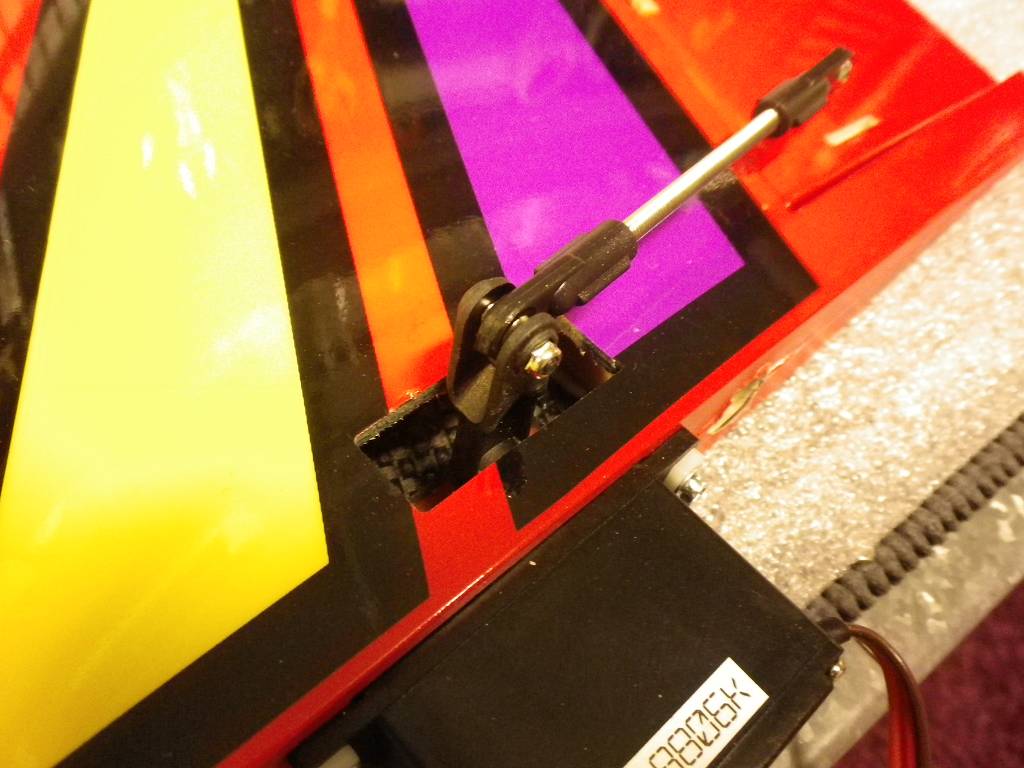

No, its the servo arms that have a forked end which a plastic ball link link is fitted between, this provides an even pressure around the link as its braced from both sides rather than just one on a conventional servo arm.
marcs
Old 02-09-2012 | 03:34 AM
marc s's Avatar
Joined: Jan 2007
Posts: 3,294
From: farnborough, , UNITED KINGDOM
Default RE: servo linkages
Here is one fitted to a current build......
marcs
