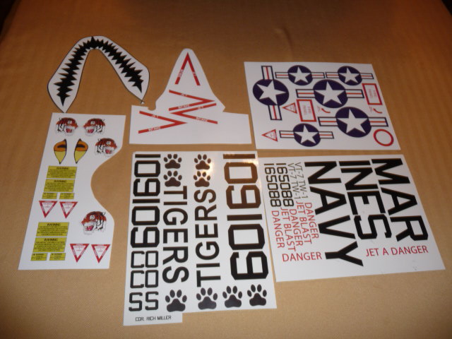

If you have any graphic software or cad software you can make your own quite easily.
I use the laser jet decal sheets with fantastic results
http://www.decalpaper.com/category-s/3.htm
I would not recommend ink jet paper as you must seal the decals with clear before applying them.
If you don't have access to a good color laser jet printer you can go to any office supply store that offers printing services.
If you are printing anything that requires a white background you have a couple of choices
1) Paint the background white on your model, it may require making a mask of the outline of your graphic image
2) Purchase the White water Slide decal paper, this requires you to trim at the edges of your graphic image
3) Find a provider that has an Alps printer, they can print white on the clear paper
Here is a sample of some stars and bars I made in AutoCAD,(see PDF file) if they are the right size you can use it to print some
I hope this helps

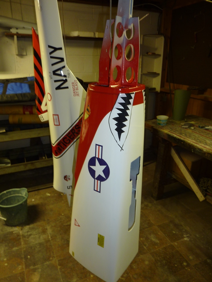

Oh I just found some photos of my Reaction project, the color is Automotive base (NASON) and the Clear is also NASON.
All the graphics I created were printed on water slide decal paper with clear applied over them except the tail, the tiger stripes and the "A" were painted using paint mask's I created in AutoCAD

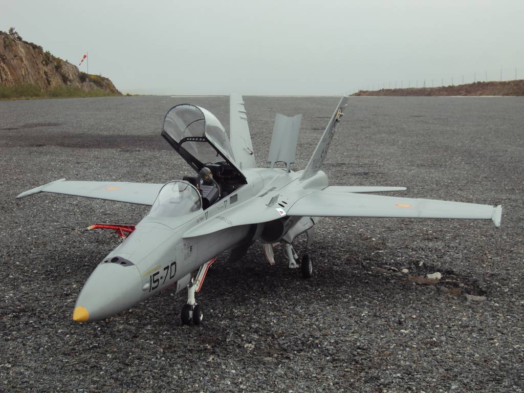

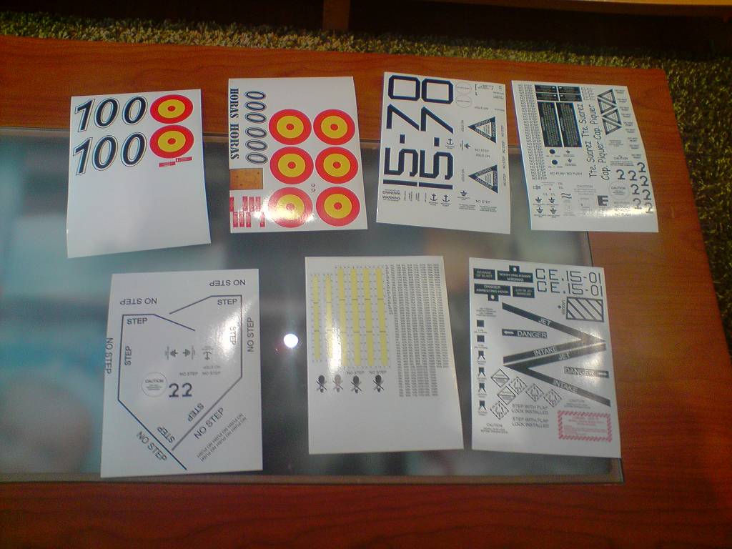

I make my own decals with inkjet printer, you can see the results in my F/A-18B.
BR from Spain.
Carlos Márquez.

Nice work. You are self-sufficient. That saves you lots of time and money.
I have a color laser printer. Just wish I knew how to design these decals. I'd be making my own rivits and decals if I could.

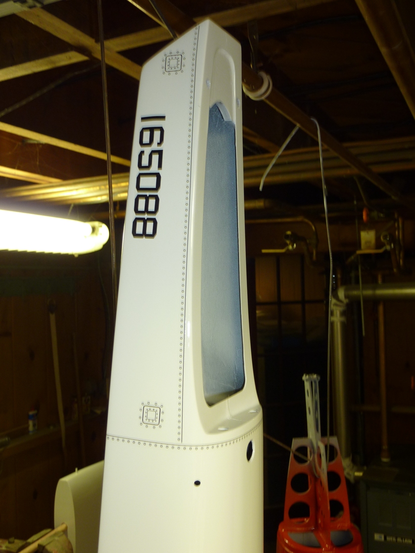

Here are some rivets I made in AutoCAD, see PDF files, print these on clear decal paper
Here is a close photo up of what they look like applied.

Hi friends:
But, the question is really if you need pay the money for something that you can make. This is a hobby, I think that all thing you can to buy it, but really is more interesting make it, not ?
If you put your RTF jet full equiped in the club airfield for fly, where is the job of the hobby ??? It is a hobby for fly only or built and fly ?
I make my own decals in Corel Draw, are really easy to make, is only question of time and dedication, of course is more easy to buy it, but... is possible that not fit perfect at first time, but wich thing is perfect at first time ???
BR from Spain.
