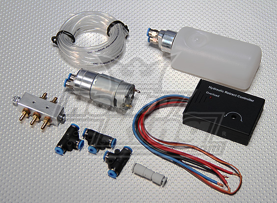

Hey everyone I ran across a conversion at hobby king and I have seen these before it looks like I nice alternative to air and a LOT cheaper than electric conversion.
I was wondering if anyone has used the hobbyking version I did see one review for a FEJ f15 using it but not sure what size.
If I tried a system like this can I run everything like my gear doors on it as well? im trying to come up with a system that doesnt require so many different things.
I refuse to use air for my landing gear but its fine for doors, canopy, brakes and stuff like that. I like the electric gear but converting 9 gear doors to electric and speed brakes to electric would just be crazy so I figured this may be a better alternative.
You can use it for brakes and you just use your current air cylinders, I would probably have to get a bigger oil tank for all the extra parts.
just some feedback from people who use it now.

Here is a link
http://www.hobbyking.com/hobbyking/s...Retracts_.html
looks good value for money but it will add quite a bit of weight

I have been extolling the virtues of hydraulics for years now, I have five models which have been converted I don’t have the slightest problem with any one of them, one in fact is a quarter scale Jerry Bates Sea Fury has hydraulic landing gear wing folding mechanism and hydraulic doors.
The system depicted in that picture is the UMS system from India, the price looks comparable with what you would pay direct from the factory. In my view it has one weakness and that is the ECU, so I did away with it and made a simple accumulator from a discarded U/C ram, this ram has a spring fitted to the air/rod side (this spring determines the switch off pressure) the rod operates a micro switch which controls a radio controlled relay which operates the pump. This system is utterly reliable and doesn’t leak!
Right now I am flying the 1:7 FB F15e which has hydraulic gear and doors, the gear system has been converted to 4mm pipe and unions the doors are still 3mm and work perfectly. You can get away with two valves if you leave the doors open gear down although mine has three valves to enable three doors to close gear down. You can use a two cell LiFe (A123). I use a three cell which gives good speed and you won’t overheat the motor as it only runs for 7-9 seconds. The other good thing is I can get 30to40 cycles from one charge and the up and down speeds are the same.

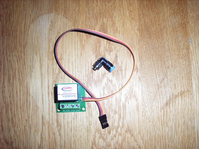

tow, totally impractical I don't think they would last long with oil in them. Incidentally I run Citroen LHM hydraulic oil in my system.
loucel, picture shows relay used and Festo for retract cylinders 5mm thread 4mm hose. Barb fittings are more than adequate, the system uses around 160psi although these pumps will deliver 275psi so be careful you can burst the neoprene hose, that's why I use nylon hose.
roy, I did have two of the ECUs fail and because they rely on pump amperage feedback they are inconsistent, plus the fact that with my system you can control it from the transmitter, I have a timed delay to run the pump plus an override switch so the pump can be run at your demand.
The second picture shows the accumulator and micro switch, the switch interrupts the negative wire to the relay so when the micro is "open" the relay is inoperative.

Interesting, so your system with this accumulator and microswitch is designed to shut the pump down at some certain pressure so it does not over pressure the system or the pump keep running?

roy, you need to remember the transmitter determins when you get the pressure and the accumulator determins how much. It is also true that because the accumulator has a reserve of pressure U/C mechanical up and down locks are rendered unnecessary.
All things considered the extra weight is in the order of 8oz which is the weight of the pump, the valves, the pipes, the cylinders and the oil tank are present anyway.

Mick would be very helpful if you could provide info on the specific accumulator you used, where it can be purchased, and a wiring diagram for how you rigged this up. Roy
