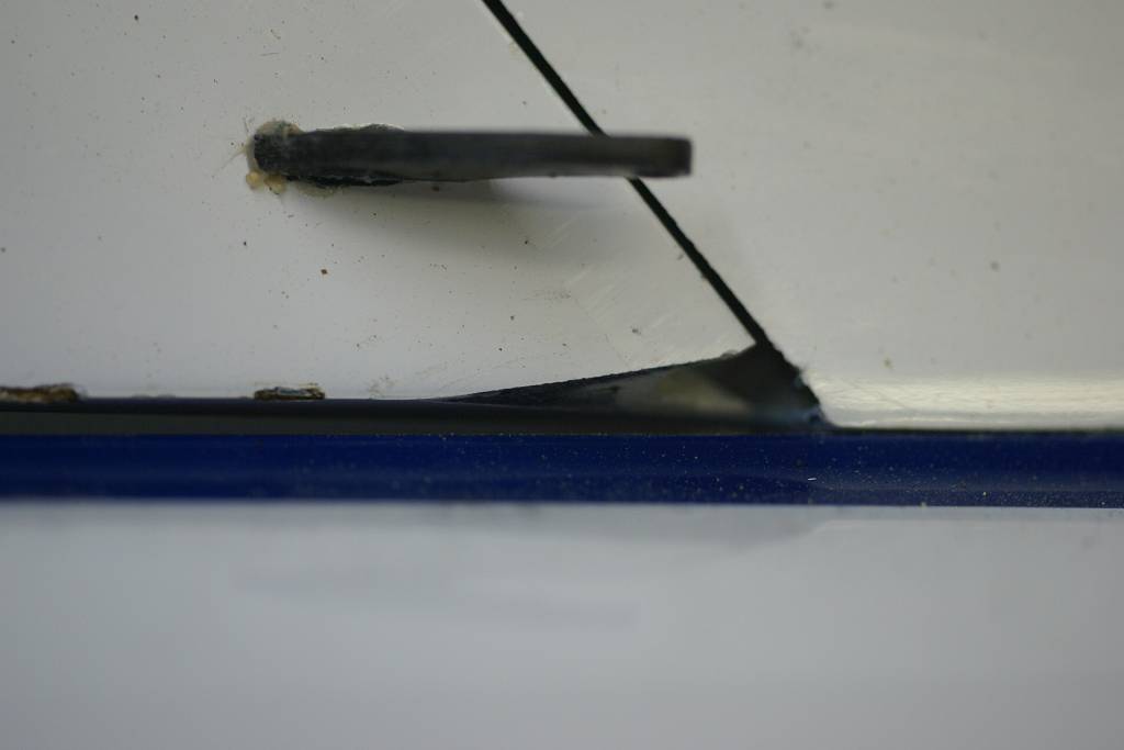

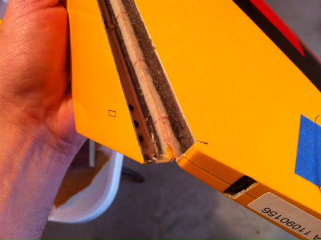

Anybody ever run into this?? When the vertical fin is mounted, I havent glued it yet, I get very little left deflection from the control surface. It hits the fuse and I only get 10-12mm out of it. Manual calls for 1.250"..I guess I could sand but as you can see from one of the pics there is not much material there..Hoping someone has run into this..Thanks..

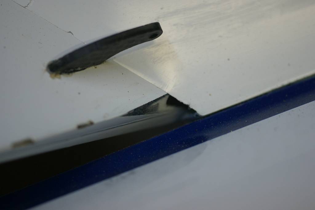

This is how it is done.
Sand a small bevel on the right hand side of the bottom surface of the rudder as shown in the photographs.
A small amount is all that is required to keep the bottom of the rudder from running into the fuselage.
