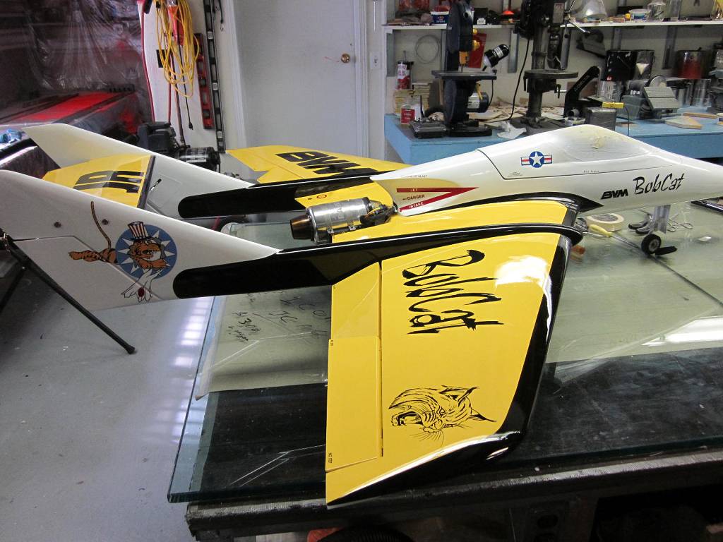

HI all, just finished my fourth BVM Bobcat, this one was to replace the one I lost at Kentucky Jets. I call it my American Bobcat.
Last two pics, are my deceased old faithful Bobcat.

HI, my first Bobcat was a standard, 250 flights,sold it to Jack from PA.,he then sold it to Walter of Long Island NY. My second was a XL,more than 250 flights, when Ilost it at Kentucky Jets, got really too slowand lowafter a manuver, snapped in.
Still flying my 3rd, and just finished my forth, both XL's.
Checker"s are done, with 3m 1/8th, fine line tape, on a white fuse, then sprayed black, plus clear.

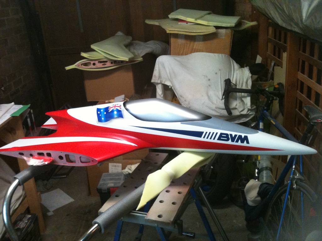

Hi Pete,
I have just dragged up this old thread from last year, because I am interested in Balsa Bobcats. I am just about to finish one, nearly ready for clear. Mine is a std. Really nice work on yours. You certainly do have the "Killer Cockpit"
I see that you modified the wing, and fitted flaps in favour of the full span ailerons, which I have also done.. Other mods I have done is to make the centre wing and fuse one piece, and have fitted a gear door on the nose wheel.
Question for you, how effective are the flaps??.. I was planning to not use the main wheel strut air brakes hoping that the flaps and a bit of crow will be enough to slow it down.
roger

HI, on both Bobcats, I do not use flaps, no need, in fact, even the smallest amount of flaps, pitches the nose down.Both Bobcats are excellant flyers. I've always used a gyro on the rudder for landing.
