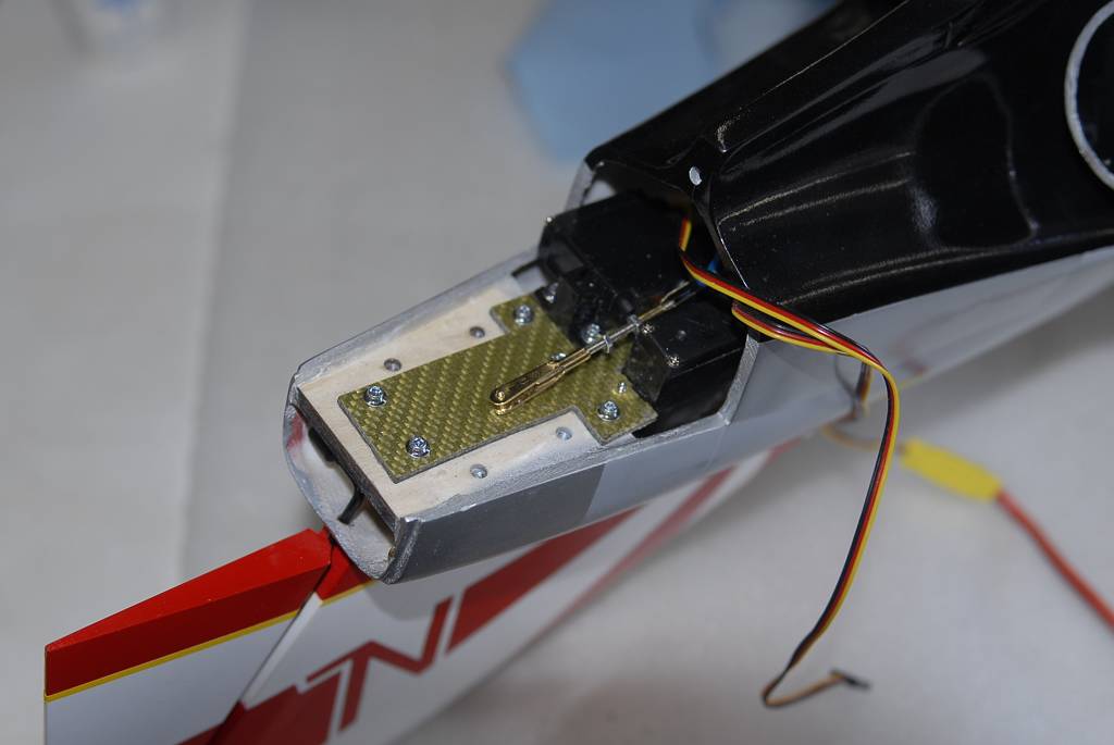

Here bunch of photos how I built my.

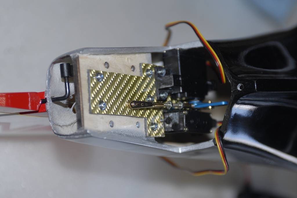

Elevator set up.

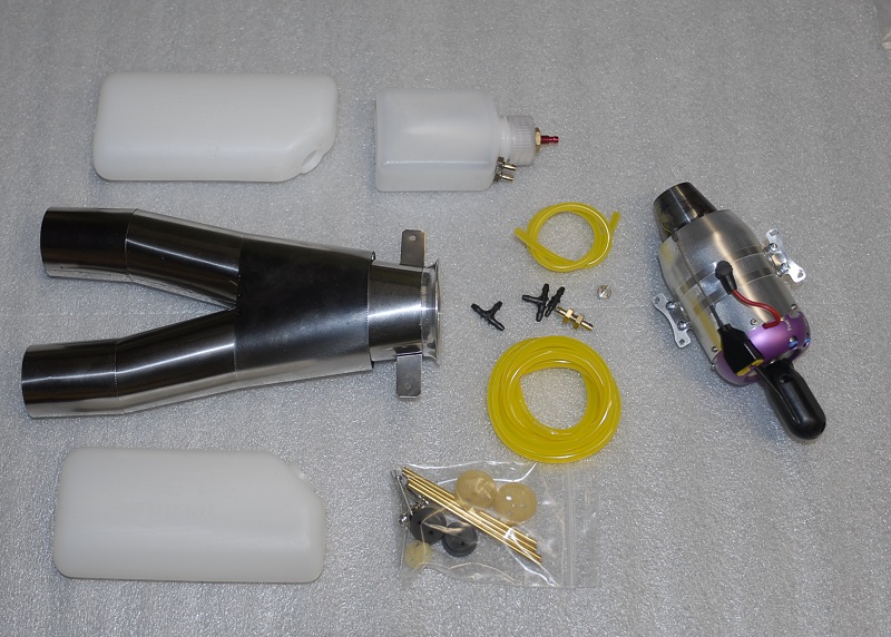

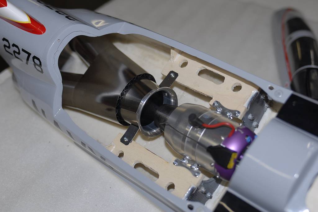

Remove stock fan mounting rail and made new mounting rail for turbine.

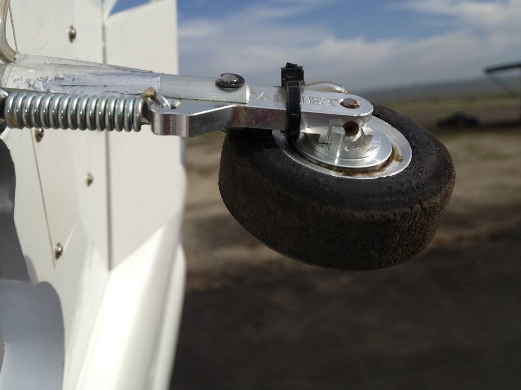

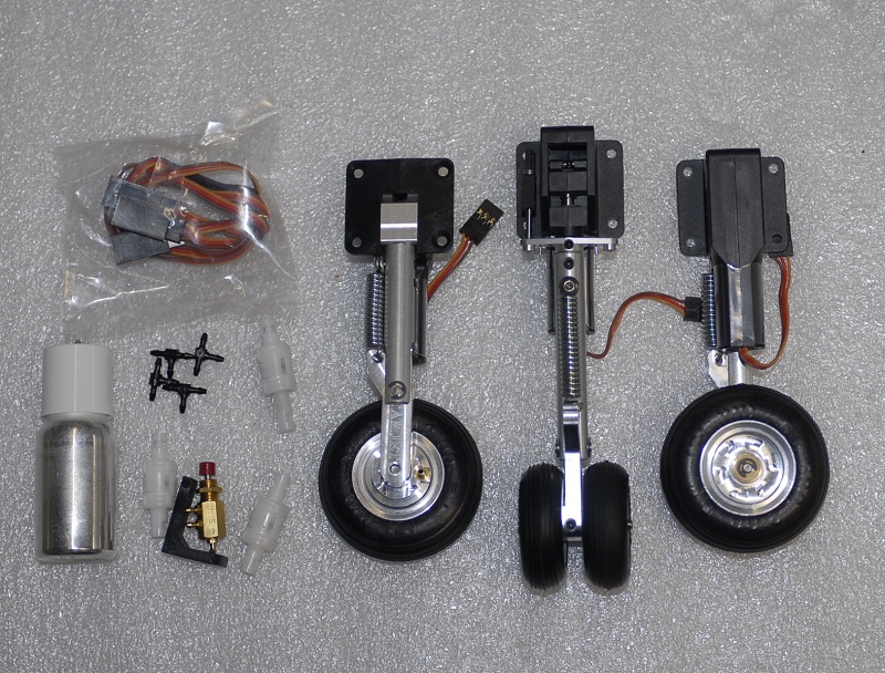

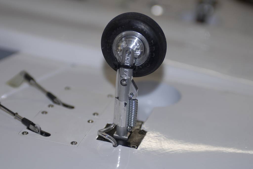

E-flite retract upgrade with trailing struts and wheels/brake.

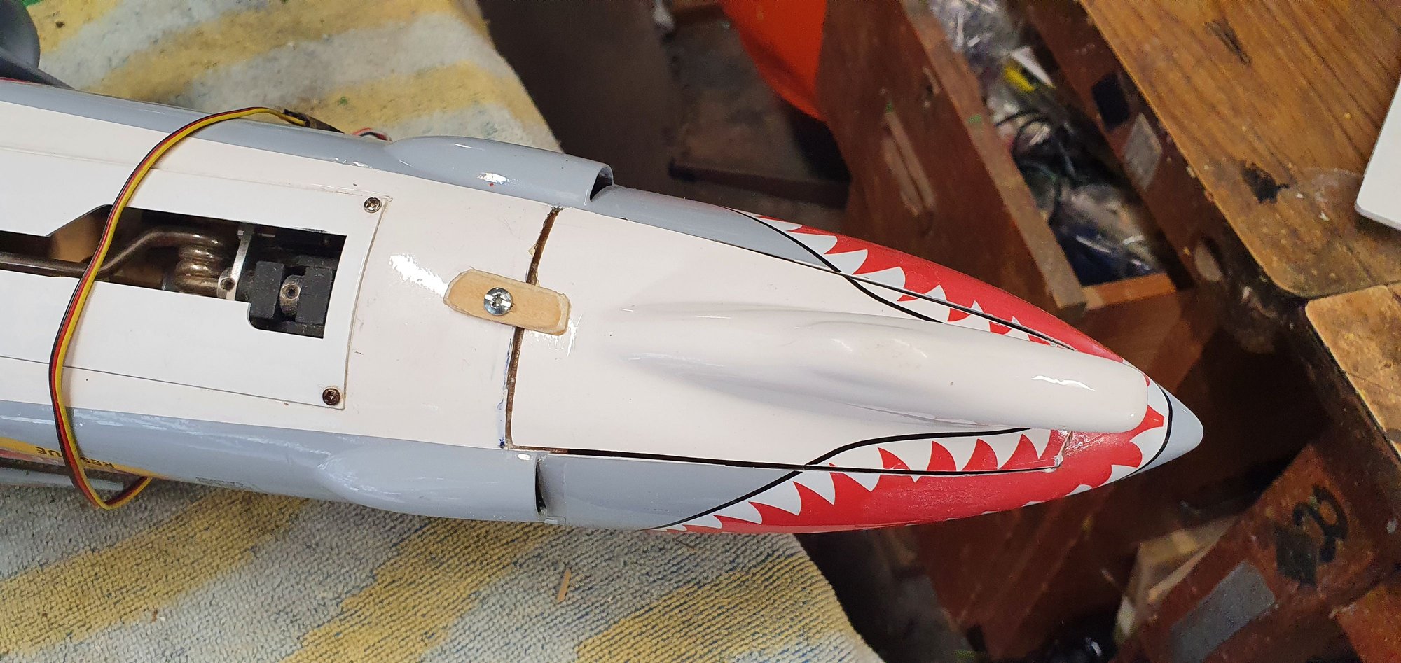

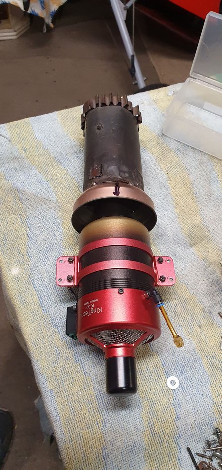

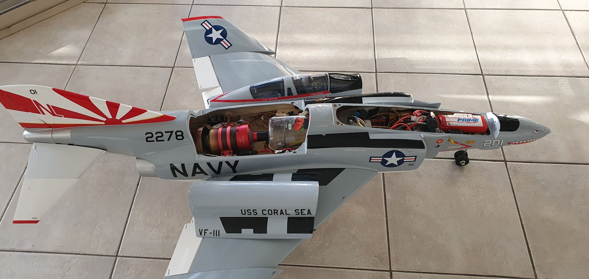

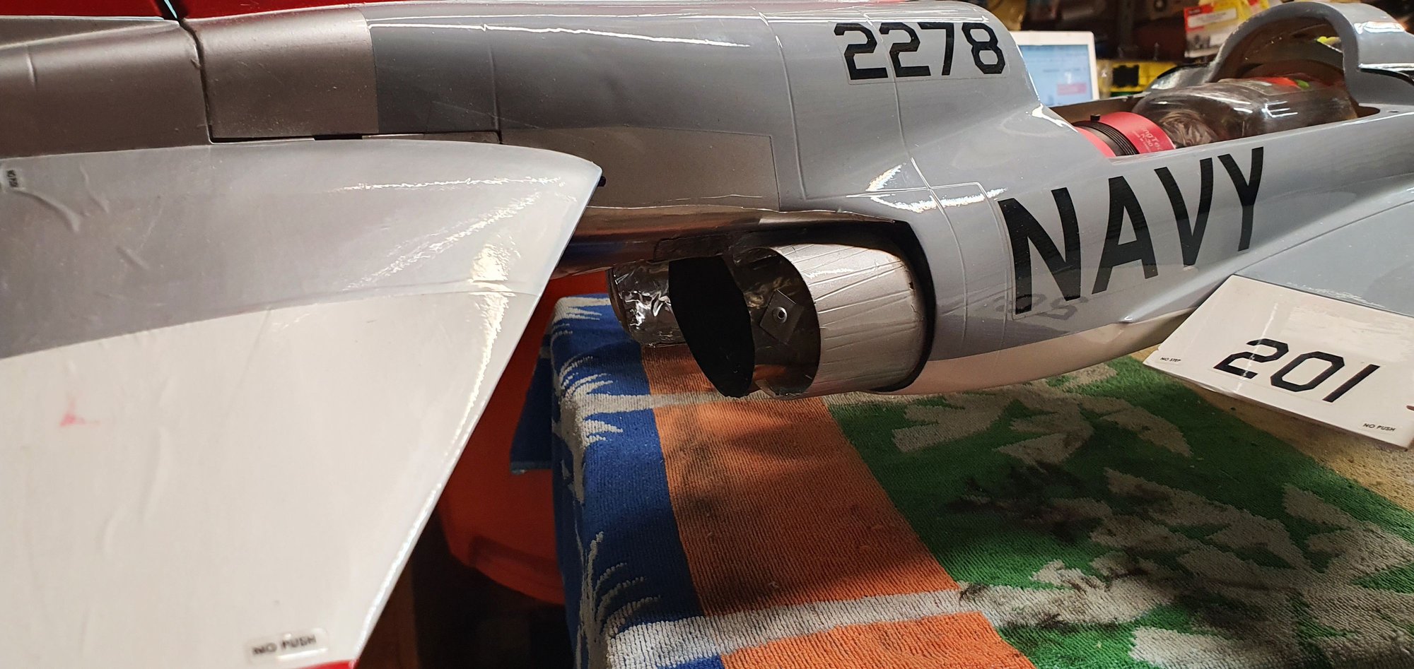

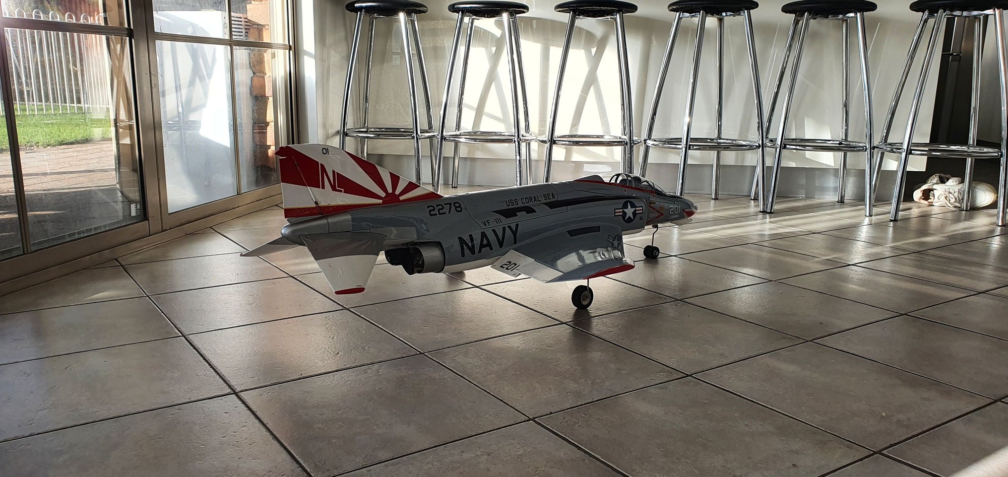

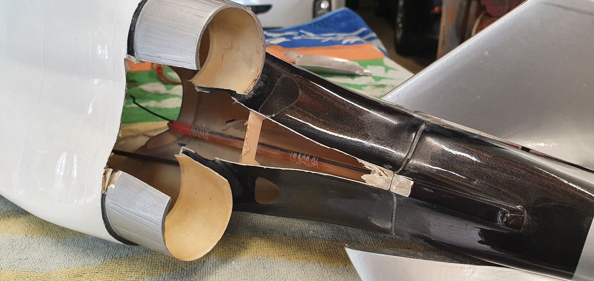

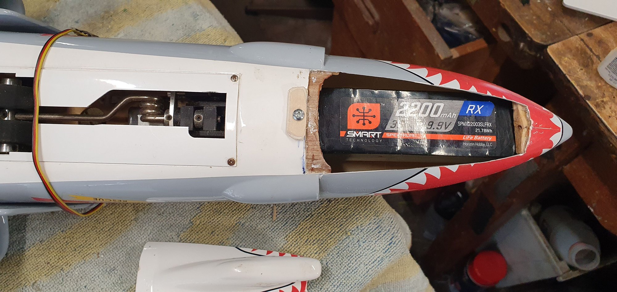

Hi guys, I realize that this is a pretty old thread, but I picked up one of these very nice jets and converted it to K30 power and a single pipe. One litre tank over the CG and total weight only 3kgs. Still finishing it, but hopefully the maiden flight soon!
Home made pipe and Ebay welder
With ECU battery in nose, balances without lead.
A bit of touch up paint coming.
3 axis gyro fitted and RX battery over the nose leg.
One litre juice bottle, felt clunk.
Pipe is sort of hidden away.
Nice composite micro jet!
3kg empty, 3.8kg TOW.
