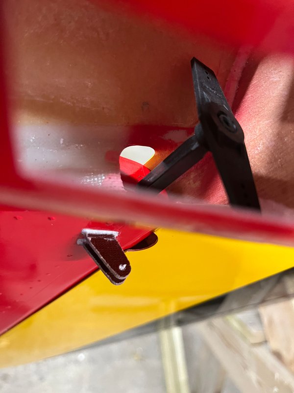

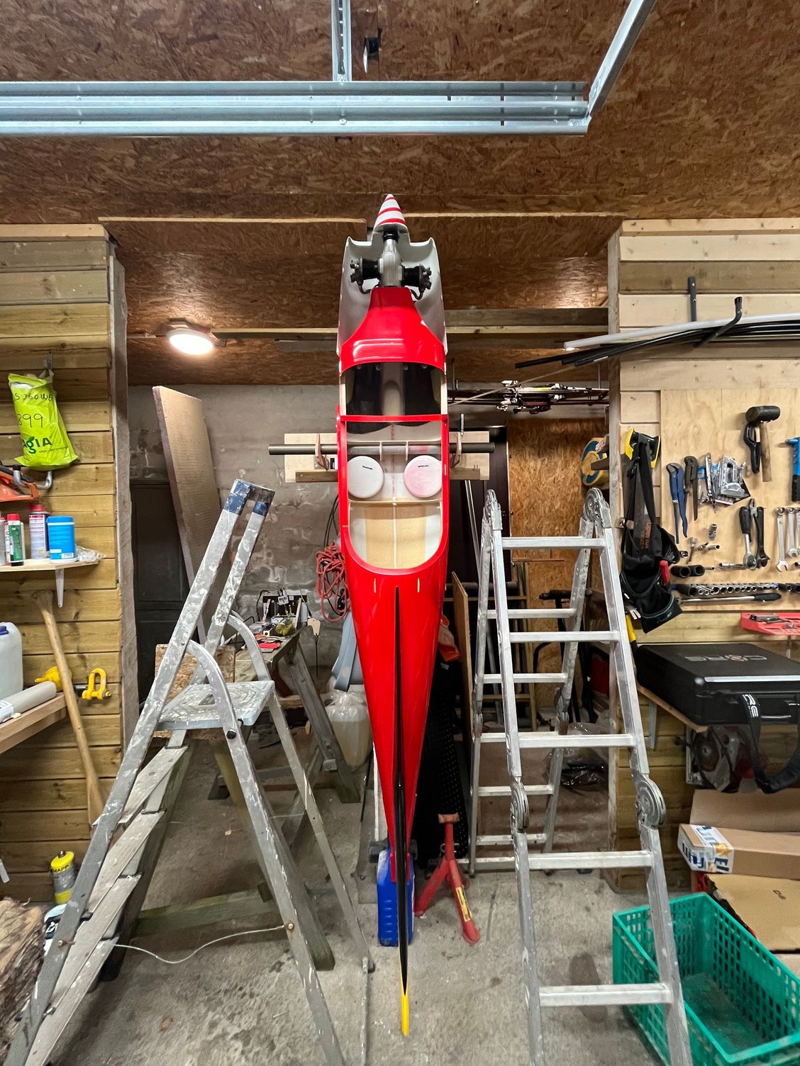

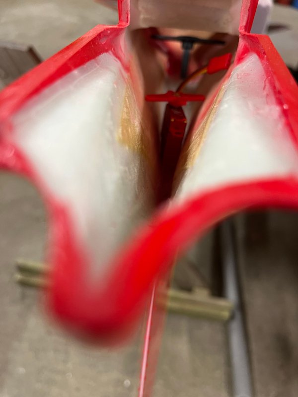

Well, now I have collected all the parts for my Marchetti. The Moki100 arrived this week, so now I am ready for the assambly process to start. Where originally planned to get a DA100 in it and got the MFM exhaust for it, but decided against it as I decided not wanting to make to much curring in the fuselage.
The layout will ge
MOKI100
Electron-Retrracts SF-260 Combo ER-50 W/ GS200
8 Savox SB2290SG - may be replaced by Chaservo (TBC)
Powerbox Mercury
Powerbox Smokepump
Powerbox SparkSwitch RS
Powerbox Batteries
One thing I consider is to install the rudder servohorn directly to the rudder so that I avoid the horns sticking out of the vertical fin. Anyone done this or similar and have any experience with it?

The modification that I am considering is like this.. Just "mock up" to see if it fits. The servo may need some more work to be secured as well. :P

I think the moki will sound better than the DA. I like your idea about the rudder, maybe you attached a pull-pull system and put the servo up front. Keep posting photos of your build.

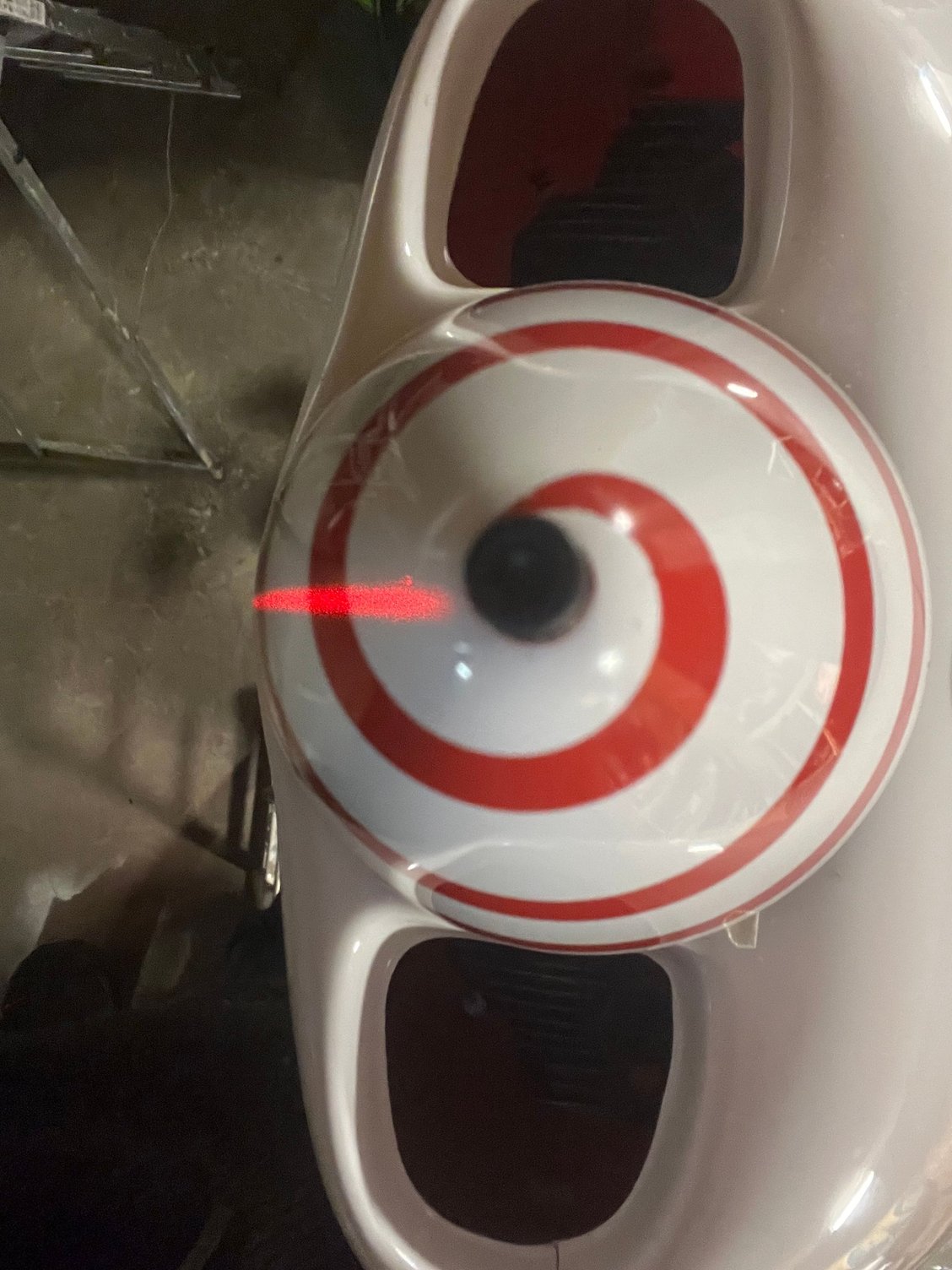

I will do! Currently the wings compete and about to start on the fuselage. Installing the MOKI next.
Not confident that I got the alignment right, so will seek a second opinion..

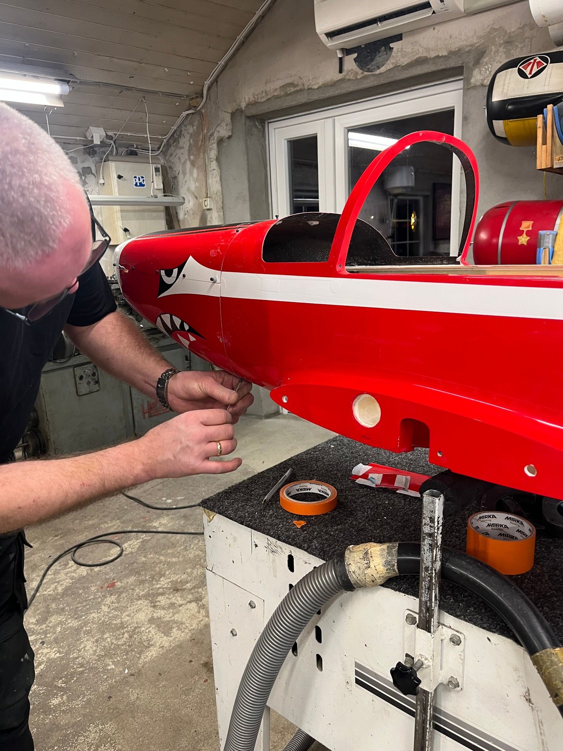

Cowling installed and Moki tested…

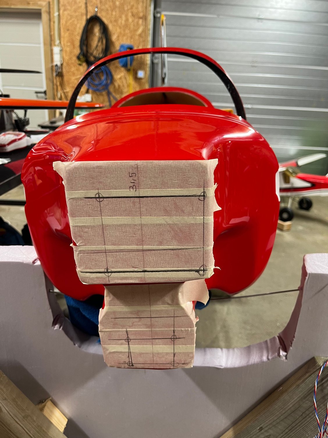

Progress.. engine installation in progress
Aligning the engine to the frame.. using spinner as guide
snapman (06-24-2025)
