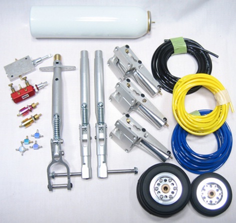

I see a lot of people having success using this reasonably priced trainer jet called the "Tornado." It is an ARF made by Modellbau with carbon fiber spars and carbon fiber reinforced booms...designed for turbines, not a wooden pusher-conversion. Composite fuselage and CF reinforced balsa wings and booms/tail section.
If you know and like TBM: http://www.troybuiltmodels.com/items/MBATORNADO.html
This trainer jet, along with all the gear to outfit it, costs in the neighborhood of $4000 RTF if you buy everything new.
Turbines: http://www.troybuiltmodels.com/items/K-80E.html
Landing Gear System: http://dreamworksrc.com/catalog/mode...bo-p-2533.html
The reason I chose to post these links was a common retailer with a lot of parts and competitive pricing...TBM...and a trainer jet that is being produced that you're likely to get a ton of support on the forums for...since you probably don't have a lot of jet pilots nearby. Being able to get help on a like aircraft and turbine is extremely valuable when getting started.
Use the "Search this thread" option after clicking on this link to get info on this Tornado Sport Jet: http://www.rcuniverse.com/forum/m_10095724/tm.htm
This aircraft will go fast if you leave the power on, but will slow down to a crawl for landing. Believe it or not, this price is extremely competitive...the turbine itself and landing gear really don't go down in price when you buy a more expensive airframe.
I am not affiliated in any way with TBM or Dreamworks, though I've bought their products in the past. This is AN option...there are many more.
Anyone have another idea with some links and pics?

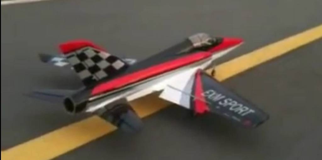

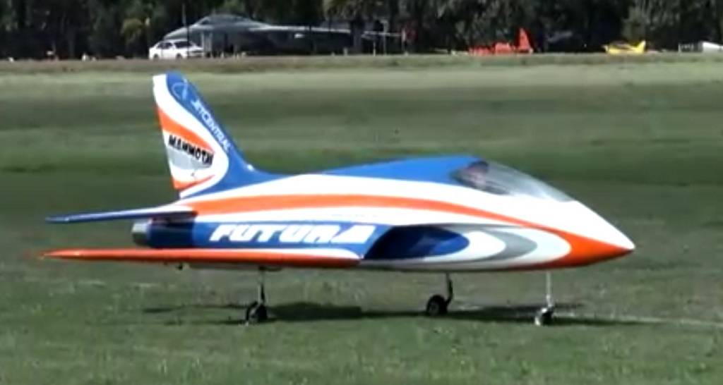

I've been hearing a lot about trainer jets lately...some people just don't like "twin boom" jets...so here are some alternatives:
EXM Sport Jet, all wood construction, built like a modern 3D plane and it can the stress of high Gs. Nice thing about this one is that a smaller turbine can be used since it is light for its size.
Shulman Aviation Turbinator, all wood construction with purpose made gear mounts that are a little stronger for grass and the occasional harder landing. Also can use a wide range of turbine sizes.
Futura, all composite sport jet with light wing loading. This plane flies like a pattern ship and is has a large frontal area on purpose to take advantage of the drag to keep a constant speed during aerobatics.
All these jets slow to a walk for landing and can be flown with 1/4 throttle on final with the flaps down to minimize spool up time for a go around. Even more drag can be generated with the use of "crow" (up ailerons) if a higher power setting is desired on final and into the flare.

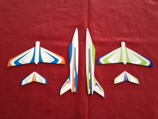

Looking for a good first jet?
380 bucks, builds quick, simple configuration, looks good, flies slow, doesn't need expensive servos or powerboxes, flies on a small turbine.
Give some serious thought to the Mick Reeves Super Reaper. Just put some sort of drag device on it. It's easy to do. Just look at the pictures in this thread.
Here's the thread with a link to his website: http://www.rcuniverse.com/forum/m_11431284/tm.htm
