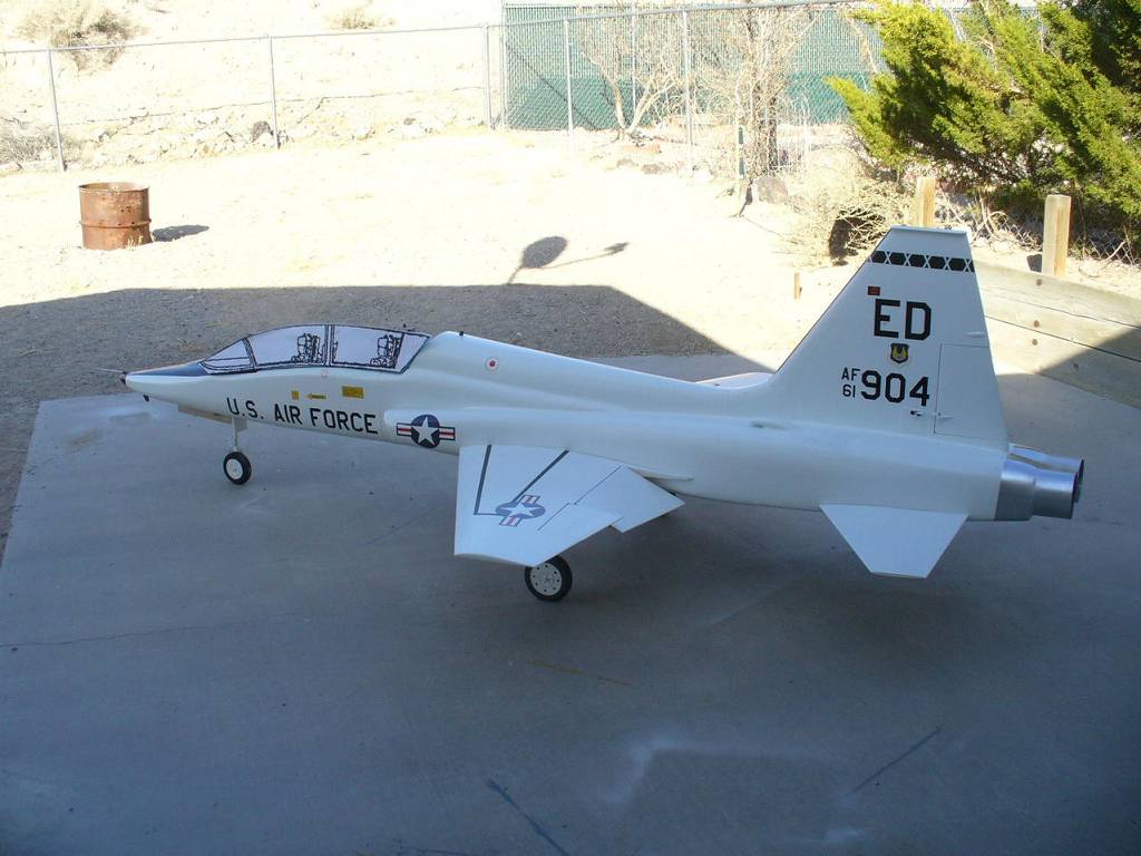

Hi Guys,
I scratch built a big 12 foot long T-38 and it fly's pretty nice with EDF power but is a little under powered. I was considering converting it to turbine. The plane is built entirely out of foam. AUW is 41 pounds
The plan would be to have a custom double wall bifurcated pipe made but my main concern would be protecting the internal foam structures from heat and was wondering if anyone knew what the average internal fuselage temperature got to on inside the fuselage of a turbine jet in the vicinity of the turbine.
Thanks in advance
Andy

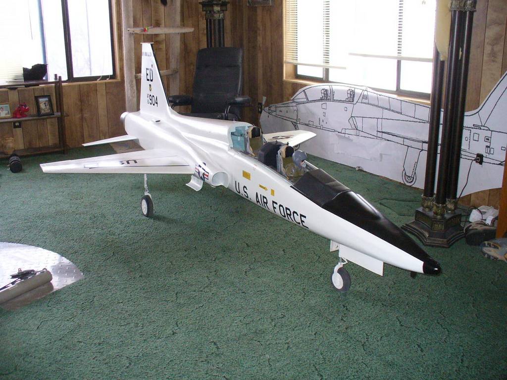

Here are a few pics of the plane.

Its not the turbine are you need to worry about, its the area around the pipe. If you dont have good airflow around the outside of the pipe you can get some pretty high radiant heat temps. The warmest outside fuselage temp I ever got was on a BVM t33 at the end of the pipe. It was pretty tight there and it got to about 142 F. I would probably get some thermal insulation and line the foam around the pipe and turbine exhaust cone. Keep as much clearance between the pipe and foam as possible. Remember that much less heat transfer takes place >1/8th inch from the source. Scotty
