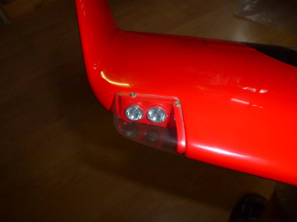

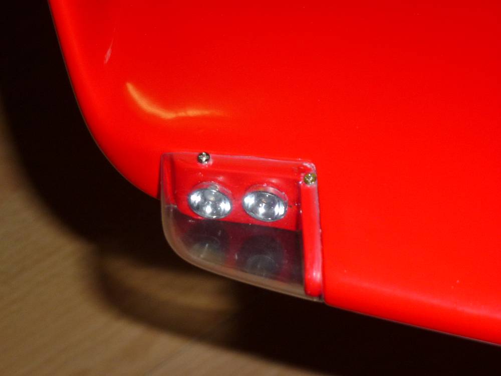

Hi all,
this Saturday should be the maiden flight, but the weahter condition is very bad.
Rain and a strong wind.
I installed landinglights in the wings.
I used little reflectors and very strong 5mm LED's. The LED's can be powered with 1S LiPo.
Christian

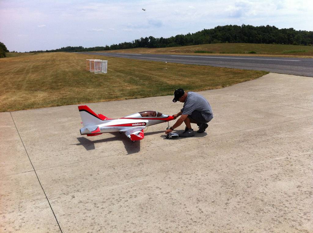

Here are some photos of Viper at Kentucky Jet. This plane is really simple to setup. We got it on Thursday and made it ready to fly by Sunday. The T12 turbine is very powerful. This plane has unlimited vertical and you will really need to throttle back otherwise it will disappear on you quickly. I think a P100 or any 100N size turbine would be ideal for this Viper.
This plane is a great step forward to meet pilots, like me, who don't have the time to build or just want to fly.
Mike
