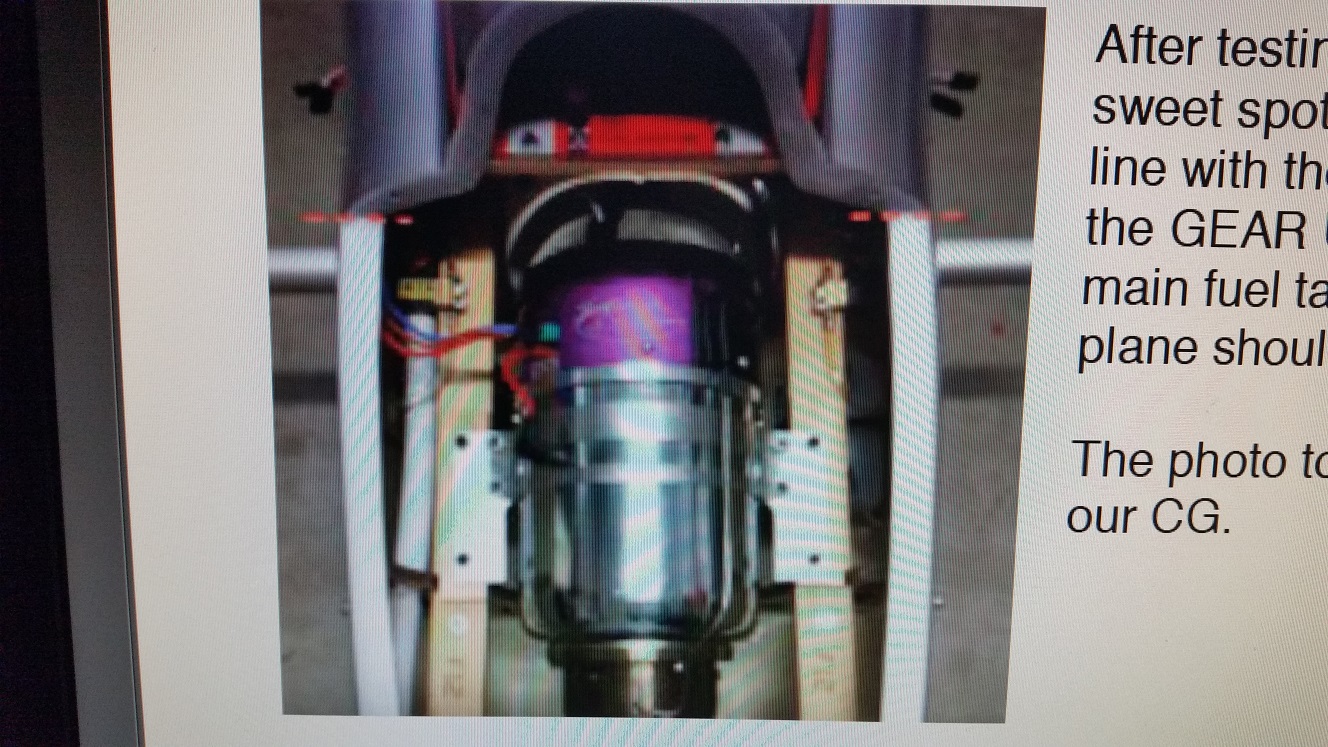

I just picked up a jet legend viper with a k80, I love the look of it
looking for any and all information of what everyone has been using for the
CG
how much travel on elevator's, rudder, aileron & flaps,what they use on the D/R & Expo Just something to get me in the ball park.
it also has smoke tanks,
I haven't started setting it up yet and was wondering with the CG UTI full all the time / kero tank empty & then kero tank full how much will the CG change, should it stay the same because someone once told me CG starts off good when full then after flying CG will become tail heavy.
thank you
Robert
