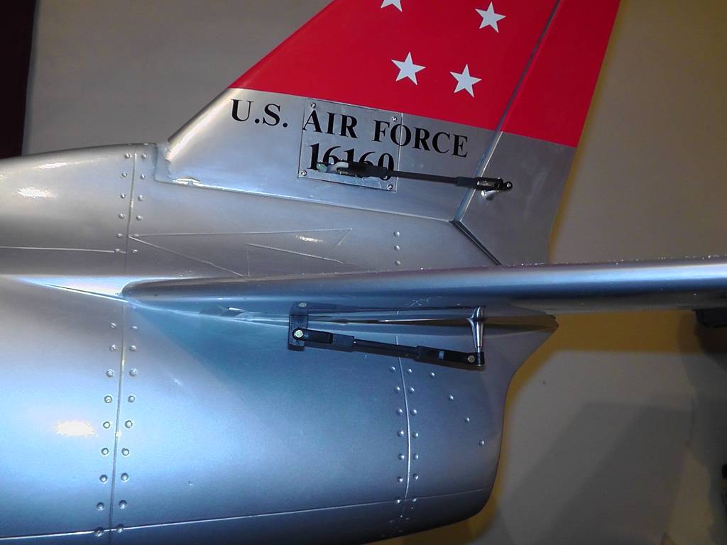

This is the STOCK elevator push rod from my Skymaster F-15. I feel that I dodged a bullet here.
On the second flight of the day I noticed that the jet would roll slightly to the right while pulling up elevator. Before the 3rd flight, I re trimmed the Right elevator to match the left. The 3rd flight went uneventful and I packed up for the day.
While unloading my truck, when I took the F-15 out, the right elevator fell to the down position. I thought I may have stripped a servo in transport on the way home. When I pulled the servo cover off, I found the push rod broken in two. This makes sence as to why the trim change.
The way the push rods are set up in the jet is they pull for up elevator. So if this rod was slightly bent were it broke it would pull that elevator to the up position. I really got lucky on this and I replaced both push rods with 6/32 push rods.

It looks as if it broke due to you soldering it which caused the cut threads to become weak and brittle. I would suggest that you use loctite instead on the new one. Glad to see you found this on the ground instead of it finding the ground for you.

That is not solder. It is Ca glue. I know there is a lock nut on it but I always put a drop of Ca on the threads for peace of mind.
Where it actually failed was at the threads right after the lock nut.

You are a luck man !!! Most guys do not check control linkage's in preflight including myself until my " Incident " .. By God I check them all now !!!! Glad to see it didn't cost you like it did me !!! I had a rod break identical to yours on a Tam F-16 on the elevator.. It too showed itself on the ground when the stab went limp.. I has to be a issue with the rod quality, brittle metal.. Scarey !!!!

McMaster-Carr Stock Number 1272T12 @$4.85 each, it is stainless steel 3 mm dia. rod in a 1 meter length, also get yourself a 4-40 Die and you can make any length push rod your want that will not break!

Thanks for all the comments. I am not sure why the rod failed because the first flight there were not any trim changes. On the second flight, I did add the Center line smoke tank tank empty to see how the F-15 would fly with it on. During the flight I thought the trim change was due to the tank. It was only after I landed That I noticed the Right stab slightly higher then the left. The third flight I removed the tank. Only thing I can figure is it was damaged in transport.

The hardware looks good. I would NOT use the 4-40 all thread. It is too flexible to make a good push rod. Hanger 9 makes a turn buckle titanium push rods at different lengths.
