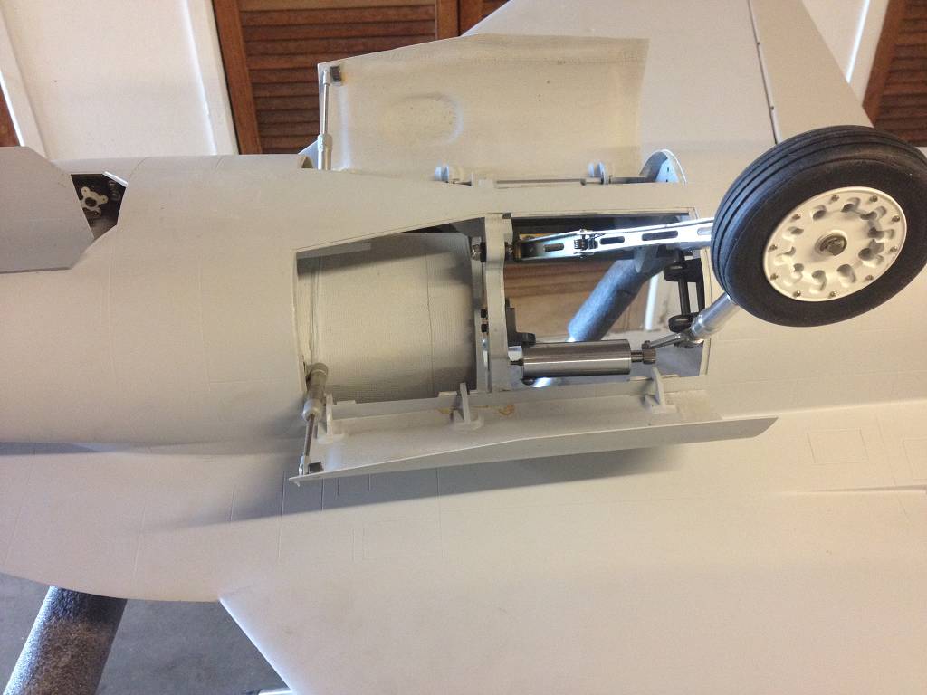

Bumping an old thread - maybe there is a more recent one, but with 3 different versions of BVM F-16s everything more recent I could find pertained to the 1/6th and 1/5th models.
Anyways, anyone have any tips on disassembling the main gear to either add a spacer or at least replace the spring? Working on one now and it basically bottoms out the main struts when sitting on the gear, springs are super soft or worn out I imagine. I haven't weighed the airplane but it's no pig. This one was originally converted and flew on a P-80 with the centerline tank, I've got a Jets Munt 70 in this one so it will actually be on the light side as far as a turbine conversion go, though I have not yet weighed it.
Is 7.5-8" from the wing leading edge/fuselage break about right from what I've found?

The springs are ok! They sit on block on the ground, that is then stabil for crosswind and so on.
Mine is only 6,2kg and nearly to light for the original bvm springs.
My cg is 150mm.
Still my favorit plane...
Good luck and fun with yours!
regards Martin
Thanks for the reply Martin - I haven't gotten this one on a scale just yet, but I suspect it will be a bit heavier than yours. If they are springs, they can certainly wear out just like any other spring. This main gear will compress 100% with just a slight load and will not unload without lifting the tail by hand.
When you say 150mm, I presume you are measuring straight back from the leading edge of the wing? If my eyes were right when I checked that yesterday it looked to be about 8.5" (215mm) down the leading edge, so just a bit behind the 8" BVM suggests.
Yes straight!
They are soft. On the ground and at the start they are always compressed. They do minimal damping when you land, also because of the lead of the wheels, i think.
