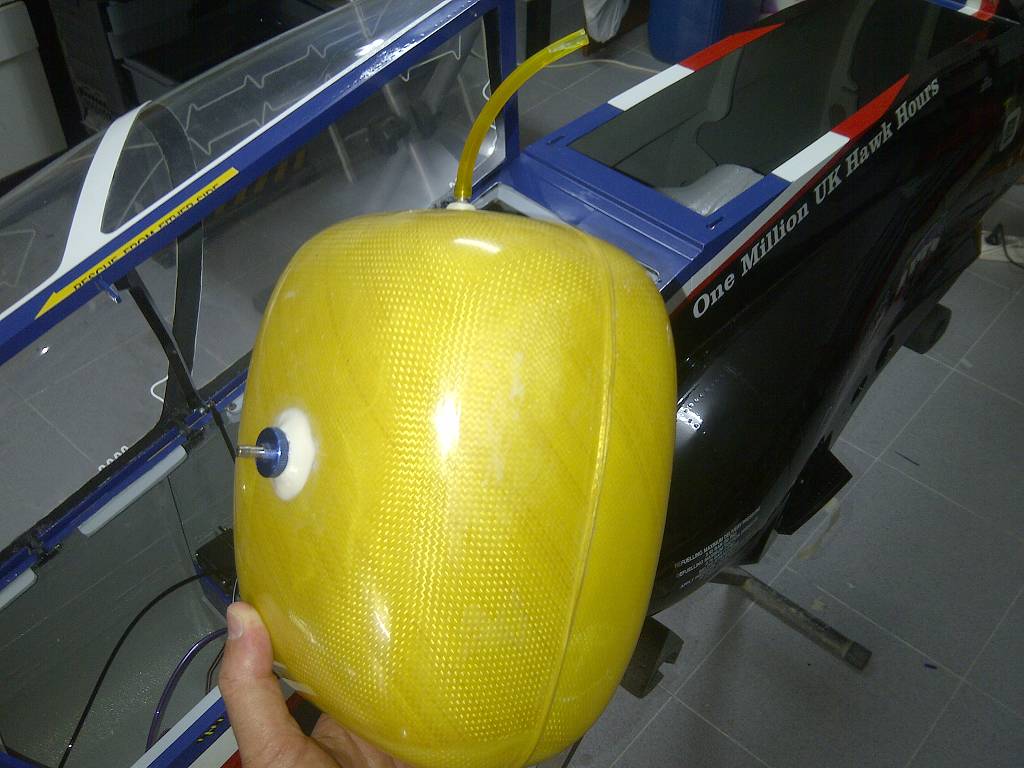

Hi i am on my third FEJ large Hawk not that i have broken any but people just want to buy them,i just can not live with out one,with the new full composite constuction and every thing is in the package that you need it is good value for money,down side is just a little work on things like the aeiral on top of the model which is far to thick and you would have a very nice model.No problems with retracks or air rams all three of mine have all worked perfectly and fly great on a good 160/9minute flights are normal with fuel left for a go round,upload for pics not working will try later regards Keith
Tanks hold 5 LTRS approx

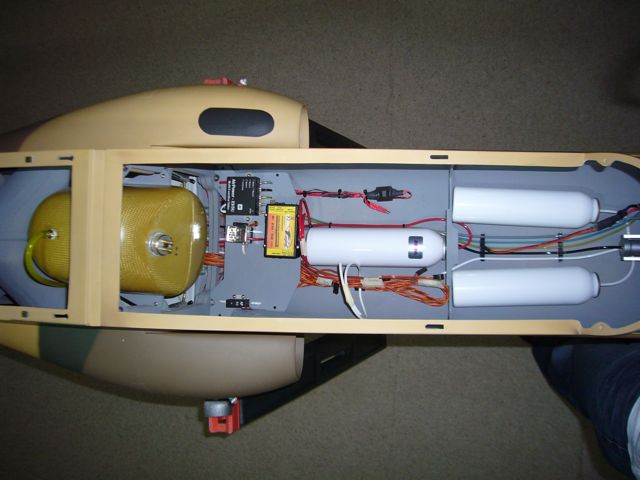

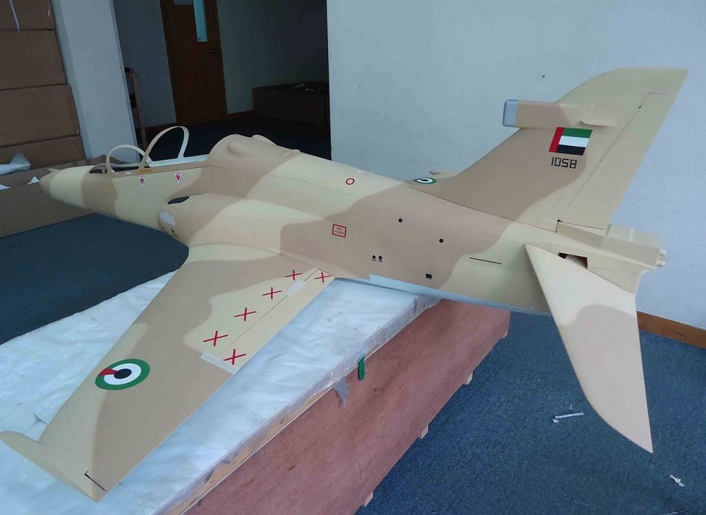

Hi,
Im an FEJ Hawk100 owner , and there are few things i'd like to share about this model.
First of all, customer service is not the best specially when it comes to product delivery....I have to say, Skymasters and Feibao are both very good in terms of fulfilling their promise.
For the price, surely does not show the quality one would expect from models one will see from Airshows or displays.
Good paint job, i requested a custom painted scheme....but takes time before they can really figure out what a customer wanted.
I was expecting more details on the model itself...but nah, i soon forgot about it. I just want to assemble and fly the thing.
Landing gears are very strong, strong enough for Grass runways....BUT, the springs on those struts were probably built from THIN wires. The Airplane weight flattens the struts down to the other end.
CG balancing this FEJ hawk was easy...very minimum movement of components.
Setting up those push pull Control horns for the Flaps were not that easy for me.
I flew mine with a P200sx onboard.
If Im going for a Second 1:4.5 scale HAWK ...... I will go Skymasters this time. For a start, i got a 1:5.5 from SM custom painted.
Goodluck !
Juan

We are using two (2) extra Dubro tanks in our Skymaster Hawks in order to get more autonomy. Don't have pictures with me right now, but for sure I can take some over the weekend. Three (3) of them flying at our club right now and they are great. I'm expecting to maiden mine this coming Saturday.
Here is how it looks (without the weathering and all the details from details 4 scale and decals from tailormadedecals)
Gonzalo, where are you putting the extra tanks and what's the capacity?

yes we run also a p160sx with the single stock fuel tank and we get 7min of flight with lot of reserve.No problem.
Dont use more tanks. There is a reason for the single one there.Its close to the C.G. so the jet has the same tendencies from takeoff to landing.
With more tanks further forward the jet will get heavier and harder to rotate and take off,and will change tendencies while you burn fuel and become more tail heavy.
There is no reason for extra tanks IMHO . just land on 7 min refuel and takeoff!
my 2c
my 2c
Where do you get the 3 litres volume of the SM large Hawk kevlar tank? I checked mine with water when assembling my plane a few years back - it was almost exactly 3.7 litres...don't think it has shrunk on the way either - 8mins timer with Booster 160+ and always plenty of fuel left when landing. Have they changed the tank at some point? BR, Janne

The earlier Big Hawk models have different fuel tanks. Maybe yours is an early one and those were bigger
The mod was made, to allow to install turbine in a forward position and avoid adding too much nose weight
Compare the one in my previosly pic and the ones I have attached from another plane: Maybe Del Gato is an early one as well, if you fly 7min. Can you or Anton can make a comment why was this mod made, but I don't feel comfortable with only one of these tanks using a P160.
Last pic shows a New fuel tank and intake mod with a second fuel tank that SM says it is not available (don't seem to affect CG that much. Seems the better setup, but where to find this tank??????
