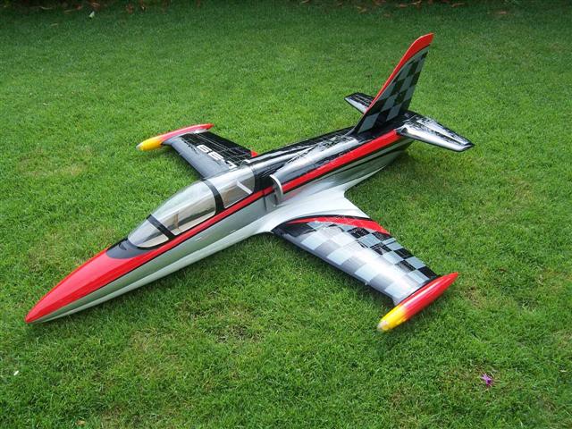

I could not find a thread about this model so I start a new one.
When I saw this model for the first time on Jet Power 2011 I was in love with the model itself and the 2011 Italian striping.
Then I new this would be my new plane in the near future.
I build a Jet Legend L-39 for the shop and like the size but not the weight, we fly that one with a Jet Cat 120SX, but I have a old Jet Cat P120 gasstart, so the JL version is to heavy for my engine.
Now on Jet Power 2012 (where we also were with a stand) I saw the model again and talked to Bruno about it.
But first I had to sell my Philip Avonds F-15.
And that is finished last sunday, I directly ordered a Big L-39 at C&C Models and I hope it will arrive next week.
make: C&C Models,
type: L-39 Big & Light
scale: 1:5,5
span: 1710 mm
length: 2200 mm
gear: electric + electric brakes
opties: schaal cockpit, speed brakes, ligths & smoke,
weigth ready: 12 - 13kg
turbine: old Jet Cat P120 gasstart

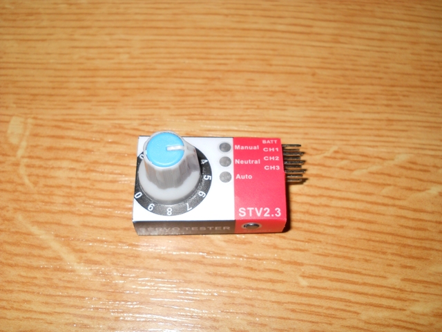

I also ordered the electric retracts and electric brakes, something new for me but have it a try.
This model will also be used for shows and meetings we visit with the shop and therefor will have some extra`s on it.
I`m planning to:
- install the speed brakes, these works fine on the JL and are awesome to see opened in the air,
- a complete light system, landing lights / nav. lights / beacon lights,
- a smoke system,
- opening canopy (I guess).
I will update the thread when I can and if some of you has information about his model just post it here.
Grt,
Berto.

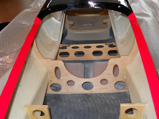

Old 10-03-2012 | 12:43 PM
Joined: Apr 2006
Posts: 500
Received 5 Likes on 2 Posts
From: Notteroy, NORWAY
Default RE: C&C Model L-39 Big
I have the Cmodels MB339 (2x2) and went for all electric retracts/brakes and LADO actuator option. So far only good experience, both in setup and operation. the electrice gear/brake setup, uses just over 100mAh per flight (timer set to 6 min)...which is far less than I expected
Only problem now, is to remember to refill the air system air on my other jets, before each flight. The all electric option is great imo.. (I know it has it´s cons as well....)
Kim
Old 10-03-2012 | 01:00 PM
Joined: May 2006
Posts: 617
Received 39 Likes on 23 Posts
From: Zeewolde, NETHERLANDS
Hye Kim,
that sound good, I`m looking forward to my experience with the electric retract set up.
Will let you all now.
Grt,
Berto.

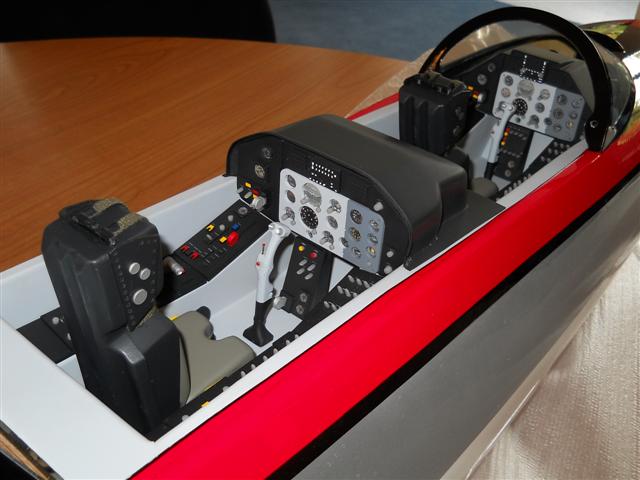

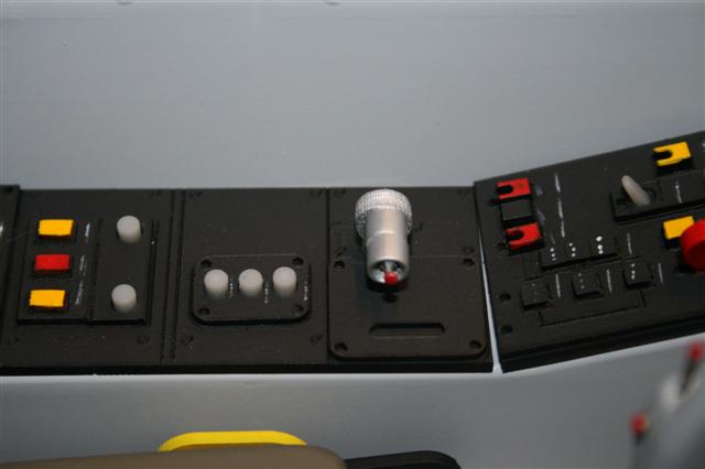

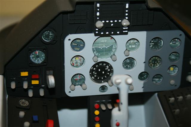

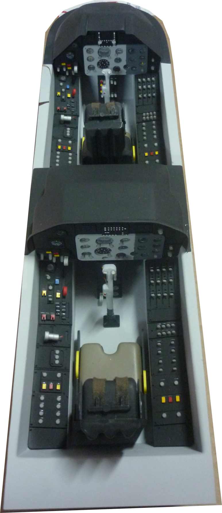

The cockpit, first pic. on the left the C&C version, right the Mirage 2000, the rest the L-39 cockpit.

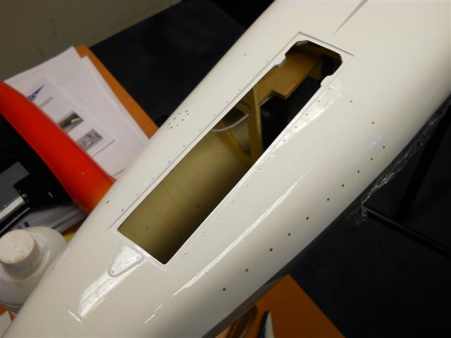

Old 10-13-2012 | 12:54 PM
Joined: May 2006
Posts: 617

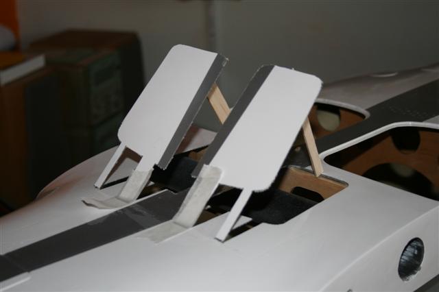

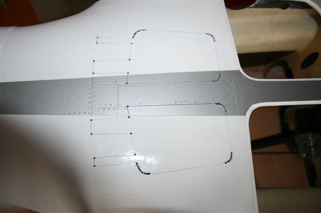

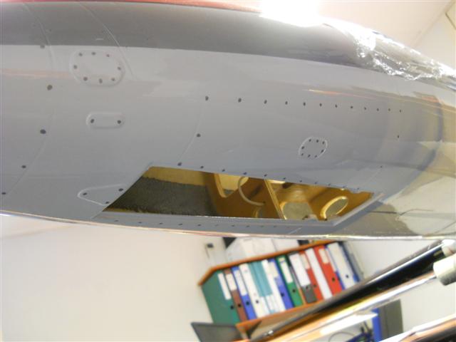

Sppedbrakes must come here, easy to locate with the panel lines.

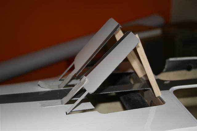

Old 10-14-2012 | 05:56 AM
Joined: May 2006
Posts: 617

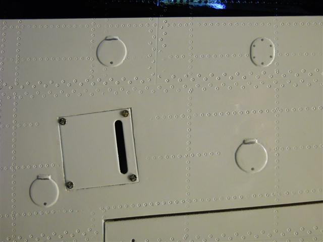

The easiest part of the speed brake modification.
ID:	1811086   Click image for larger version
ID:	1811087   Click image for larger version

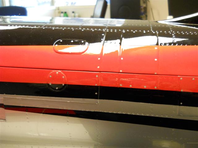

Old 10-26-2012 | 01:52 PM
Joined: May 2006
Posts: 617

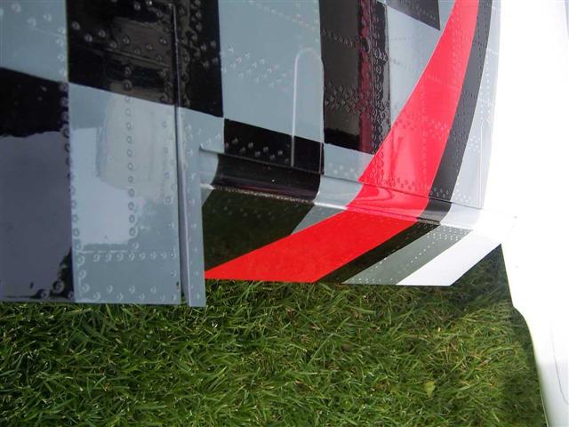

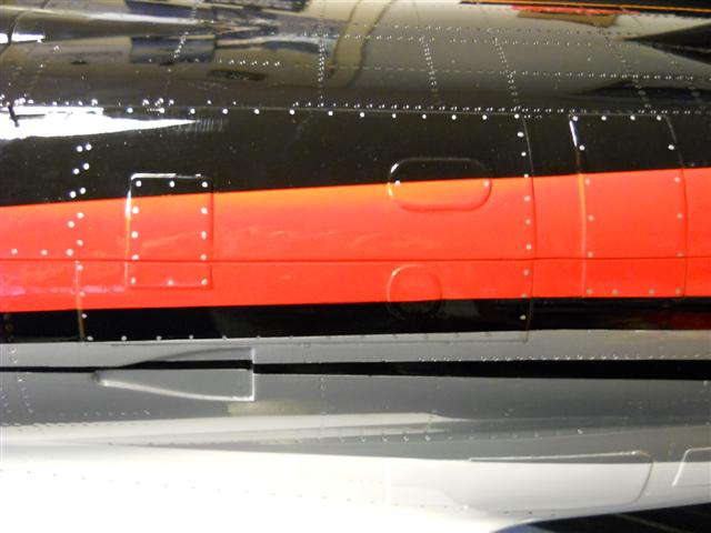

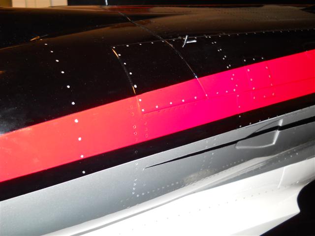

Started with adding some details.
ID:	1815040   Click image for larger version
ID:	1815041   Click image for larger version
ID:	1815042   Click image for larger version
ID:	1815043   Click image for larger version

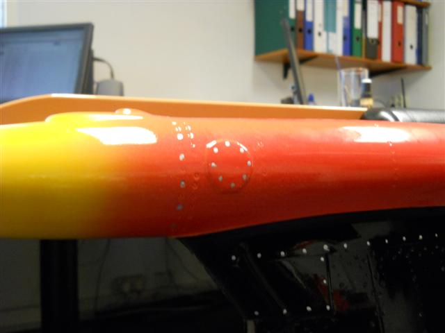

Old 10-27-2012 | 02:51 AM
Joined: May 2006
Posts: 617
Dots, dots, dots and more dots.
ID:	1815178   Click image for larger version
ID:	1815179   Click image for larger version
ID:	1815180   Click image for larger version
ID:	1815181   Click image for larger version
ID:	1815182   Click image for larger version
ID:	1815183   Click image for larger version

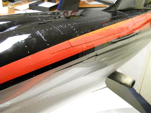

Think I`m finished with dotting.

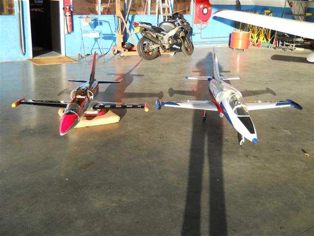

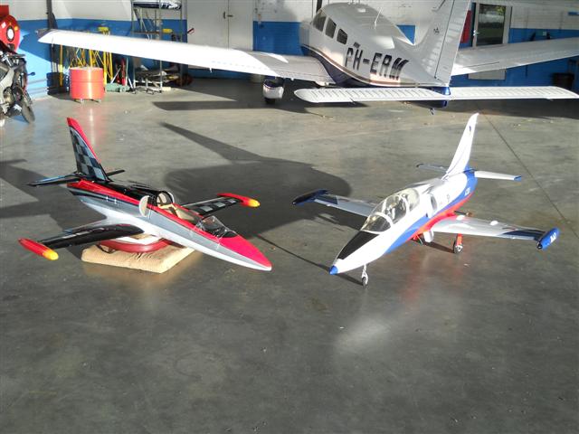

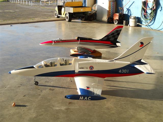

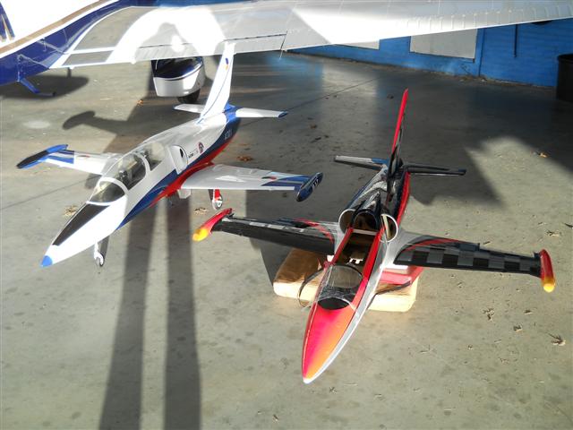

Next to de Jet Legend L-39
ID:	1815239   Click image for larger version

Besides the Jet Legend L-39:

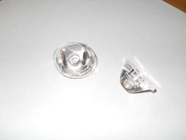

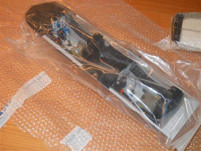

Today recieved the ELCU.
Also 2 lenses for in the tip tanks.
+ a servo tester.
Off course I needed to play with the gears:
[youtube]http://www.youtube.com/watch?v=vVaDrcUCCR4[/youtube]
[youtube]http://www.youtube.com/watch?v=6Nxbgq1a7-Y[/youtube]

Where are the lenses from?
Old 11-08-2012 | 01:55 AM
Joined: May 2006
Posts: 617
Got them from C&C Models, are I 27 or 29mm in diameter.

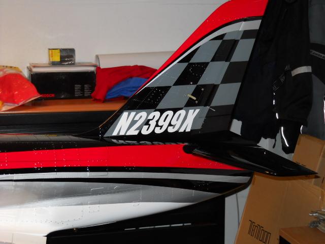

Registration added.
