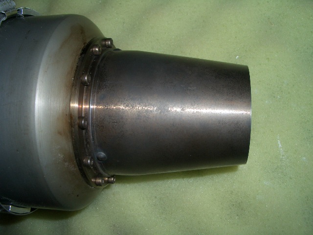

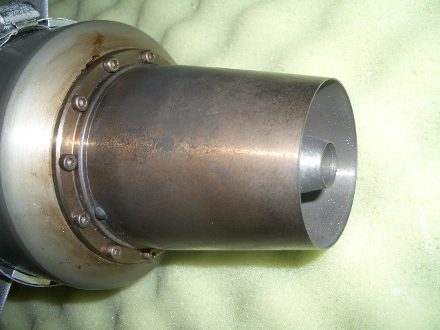

Here are a couple of pics of the 750 cone(s). That is why I am confused! Modern advice says usually 1/2" to 1" from end of exhaust cone to pipe but the manual drawing with this 750 cone shows 1" from base of the can, not the cone...

As stated I would not recommend running the cone inside the pipe, the exhaust will not generate the venturi effect required to pull cool air into the pipe and keep temperatures reasonable, I would use at least one inch from end of cone to start of pipe (not including the intake ring radius).

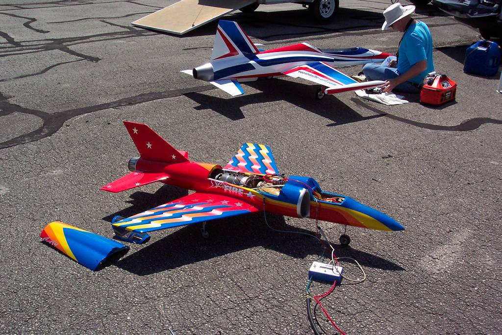

I ran my RAM 750 inside the exhaust tube bellmouth for years. Mine RAM 750 also had the long cone on the end of the turbine. Never had a problem. Heat was not an issue either. See pic.
Terry Jacobs

Thanks guys for the input. Seems that anywhere from the manual distance to the 1/2" to 1" measurements work. The airframe/pipe combo I'm using won't allow me to have the cone outside the pipe... SOOOOO, I decided to add a pipe support to my turbine test stand and see what I get. I ran the turbine with the max distance away from the pipe I can get (which also helps with the CG) all the way down to the 1" from the can that the manual describes. From a temperature standpoint there was no difference in pipe temp among the various distances. Warm at the tip of the pipe (not hot enough to burn my fingers) and cool at the bellmouth end. I have no way to measure thrust so don't know how the measurements affect that! The pic shows the farthest out of the pipe the airframe bulkheads allow me to position the turbine so I will go with that and see what happens...

It looks ok from here, looks like you should have enough clearence to get the hot air moving into the pipe.
