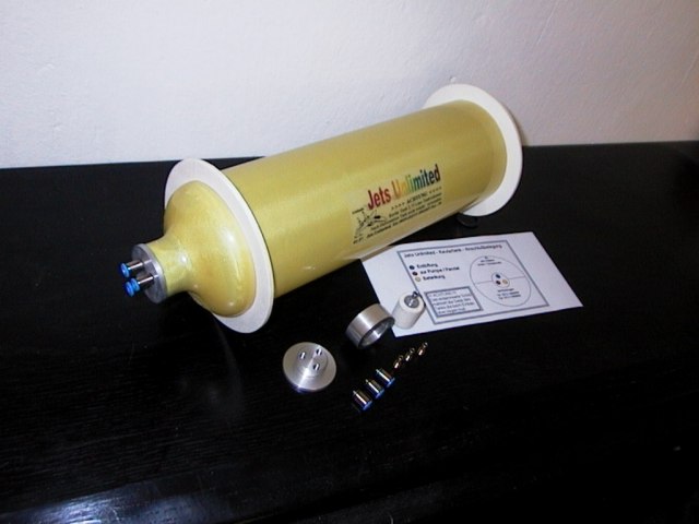

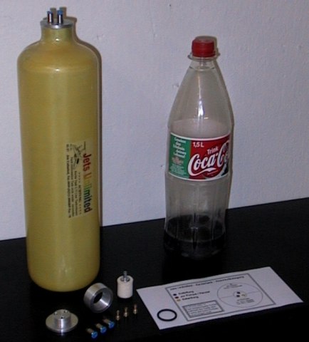

I wonder how you can copy a model that is still under production by the legal owner
Also the tanks are very close to the tanks that i produce for the hotspot since 2001 ...

Hello Steven, really I not will make a copy, I will make a own version of this model, I hope best than original. I like your tank, look very nice, but mine it's own design, no copy of your tank.

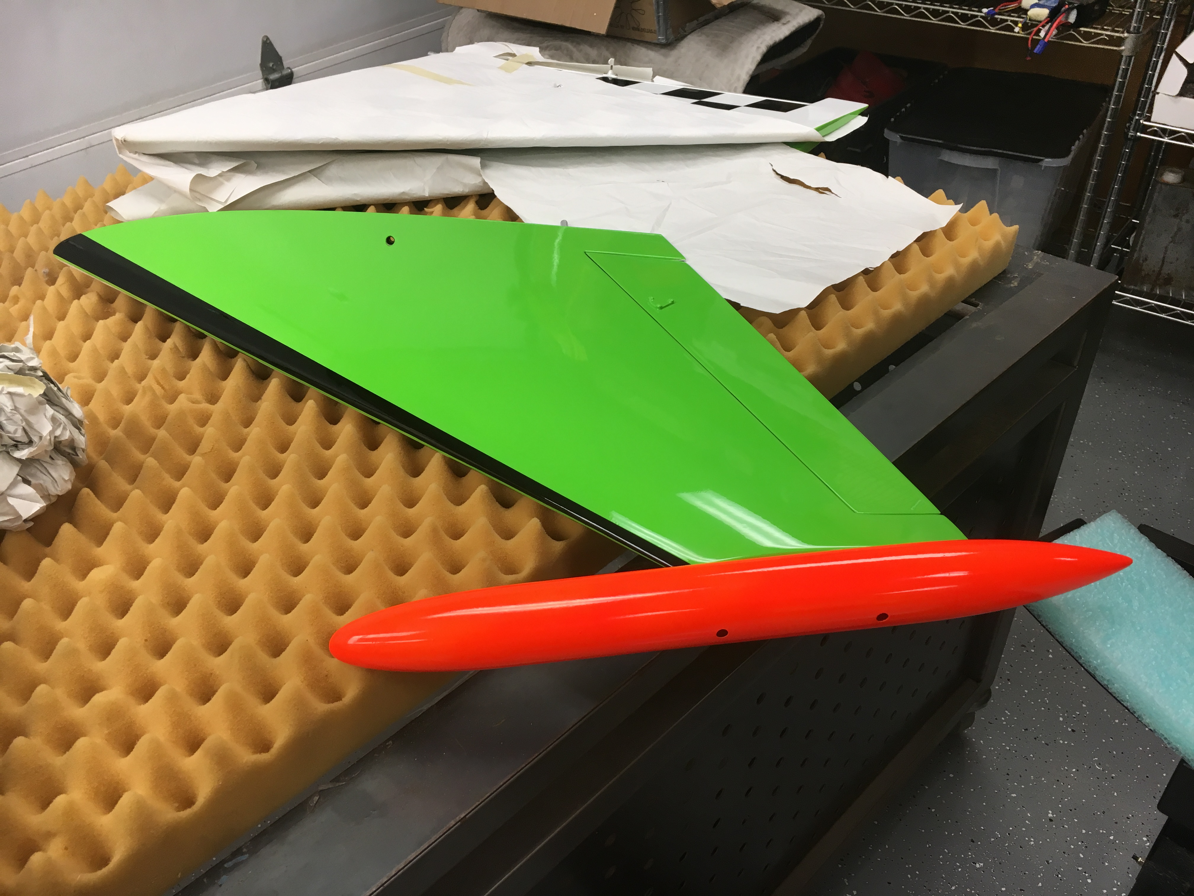

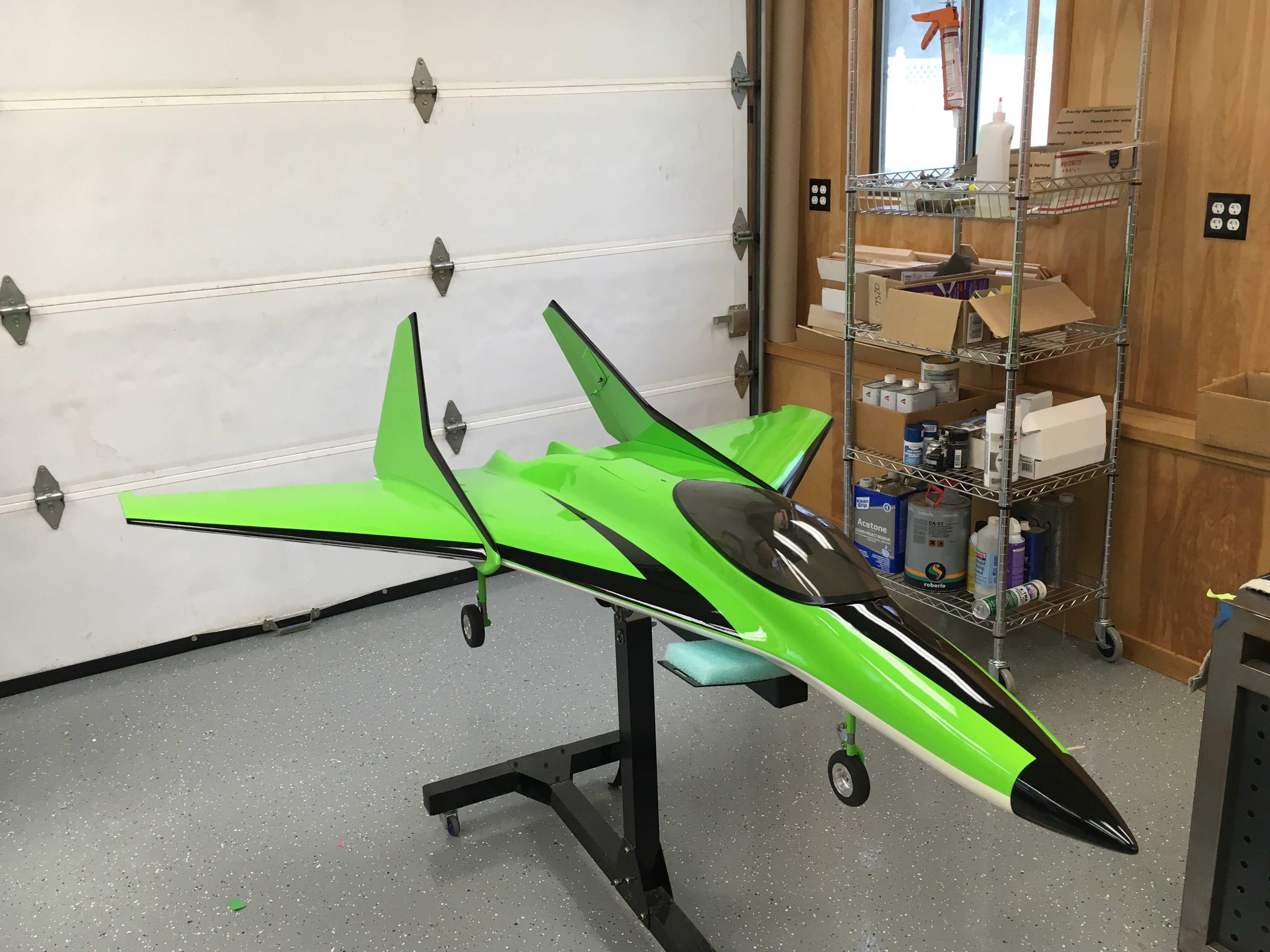

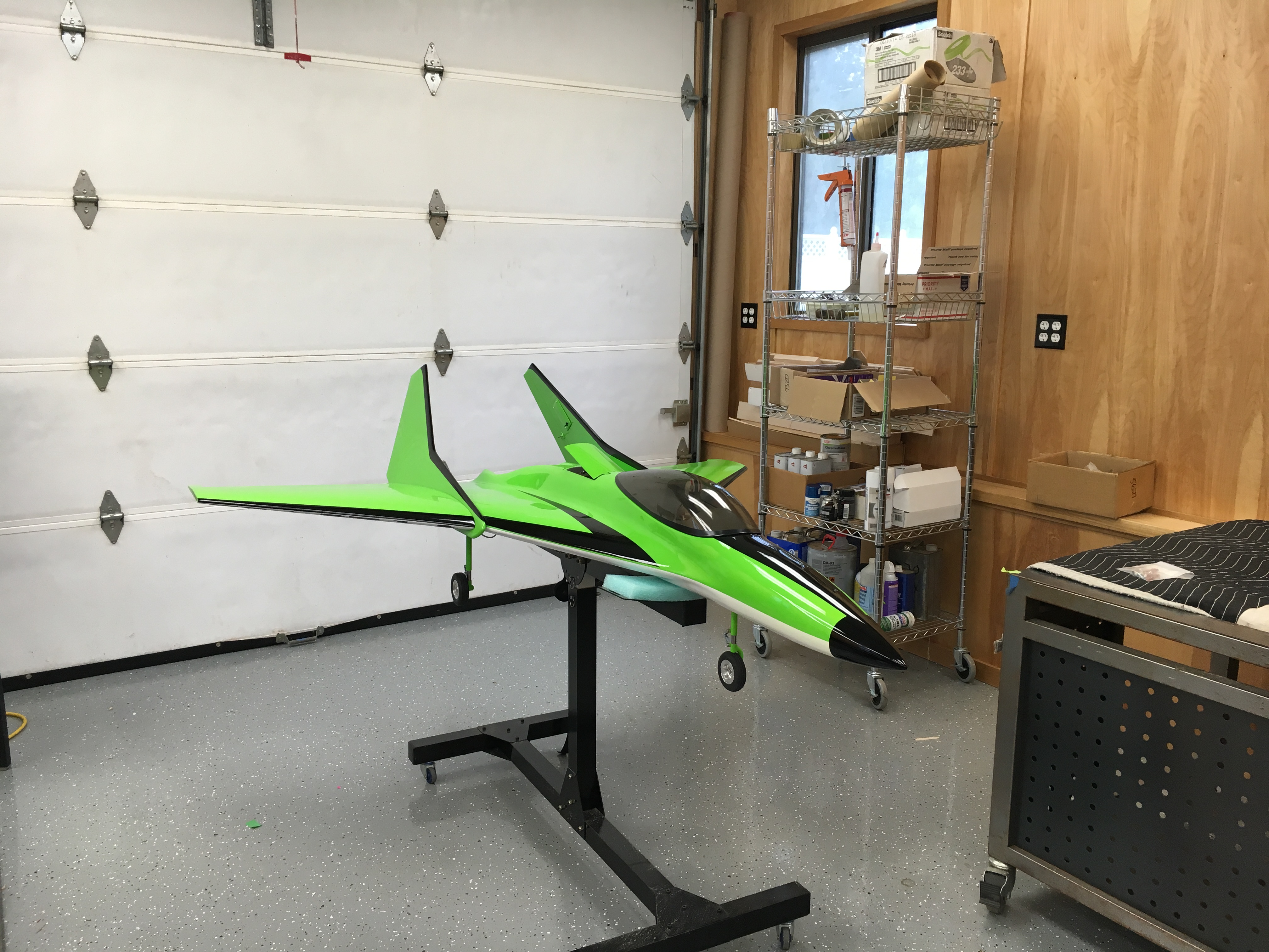

The Graupner Hotspot was my first jet, I guess this thread inspired me to do it all over again. My original had a P-80. The new one will have a P140 RXI with a vectored thrust tube.

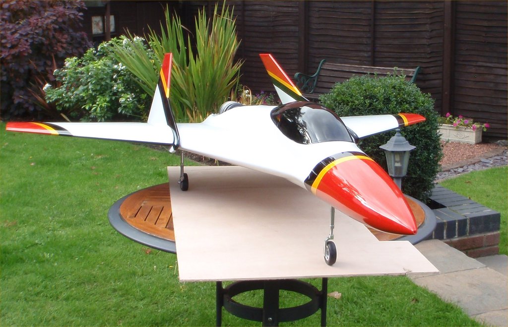

Hi Carlos
Hope you dont mind but my hotspots latest color scheme is copied from one of your hotspots!
It was shown in post #15 of this thread when it was sporting my home built engine and weighing some 9.5kg. Having lost our flying site for jets, i had to rebuild it lighter to fly at my local club field which has a 7kg limit due to proximity to an airport. Its now 6.990kg dry with a jetsmunt vt80 so still greater than 1:1 power to weight. It was quite a challenge losing 2.5kg but ive managed it with around 1.5 kg saved in the engine swap alone. New fins and canopy shed some 700g as the originals were way too heavy duty. I use a 1000mah turbine battery which is replaced each flight and the wing roots were a very thick wood which now have many holes drilled through to the foam along the entire length. Ive changed over to single elevon per wing and the braking system is removed as we fly on a grass strip which provides enough drag to stop (easily replaced for other flying sites with no weight limits).
Finish is 2 pack epoxy paint which is only just thick enough to cover so added surprising little weight.

WOW !!! Yes, I like the Hotspot that I made. It's very pretty, congrats.
