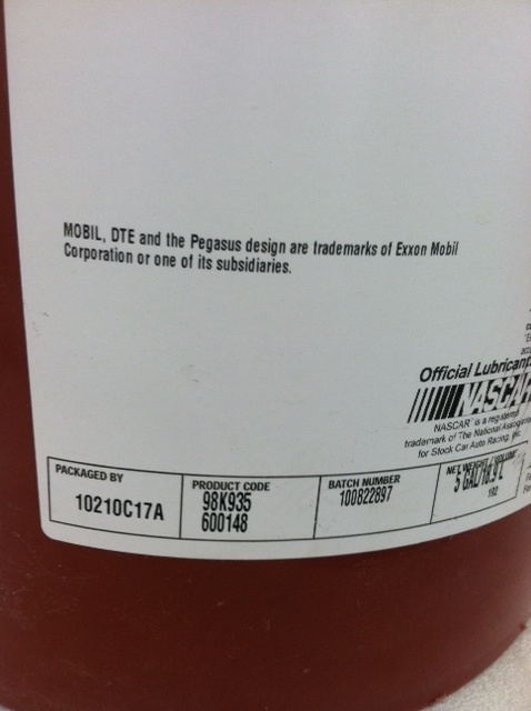

Snapped these last night from my current 5 gallon pale.
Old 01-25-2013, 04:45 AM
Wren Turbines USA
My Feedback: (39)
Join Date: Jan 2003
Location: Decatur, IN
Posts: 1,284
Default RE: DTE oil which one
ID:	1844096   Click image for larger version

I have been using DTE Light product code 98 T 887 for the last 2 years in my Wren's Simjet's and a JC 120 SE so far so good
but I just noticed that the product code is different on your Drum am I using the wrong one ?[&o]
cheers
Andy
Old 01-25-2013, 07:54 AM
HarryC
Join Date: Feb 2002
Location: private, UNITED KINGDOM
Posts: 3,672
Received 26 Likes on 16 Posts
ORIGINAL: ash 26
According to Mobil, there is only one version of DTE Light so if the tin says DTE Light, that is it. See http://www.exxonmobil.com/MarineLube...d-series.aspx# and click on the "tech details" tab
Old 01-25-2013, 07:58 AM
ash 26
Join Date: Apr 2006
Location: private, IRELAND
Posts: 427
Thanks Harry
this is the same spec sheet what I got at the time so we must be right
cheers
Andy

Yup, that's it. If you click on the APPLICATIONS tab in Harry's link you will see that it is recommended for turbine use. My pail is labeled the same asRon's.
Note that this is lubricating/circulating oil NOTHYDRAULICOIL.
Joe
