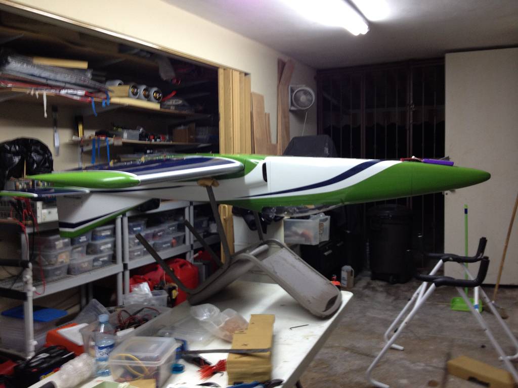

Default RE: CG Machine
a good chair will do.

Edgar, I love your chair trick... I'll sure use it.
Thanks.

ORIGINAL: Edgar Perez
Edgar i like chair idea and save a ton of$$$$ in alumminun balancer, please to freaking spencer

ill do like youngguy use a chair
YES!!!!!
