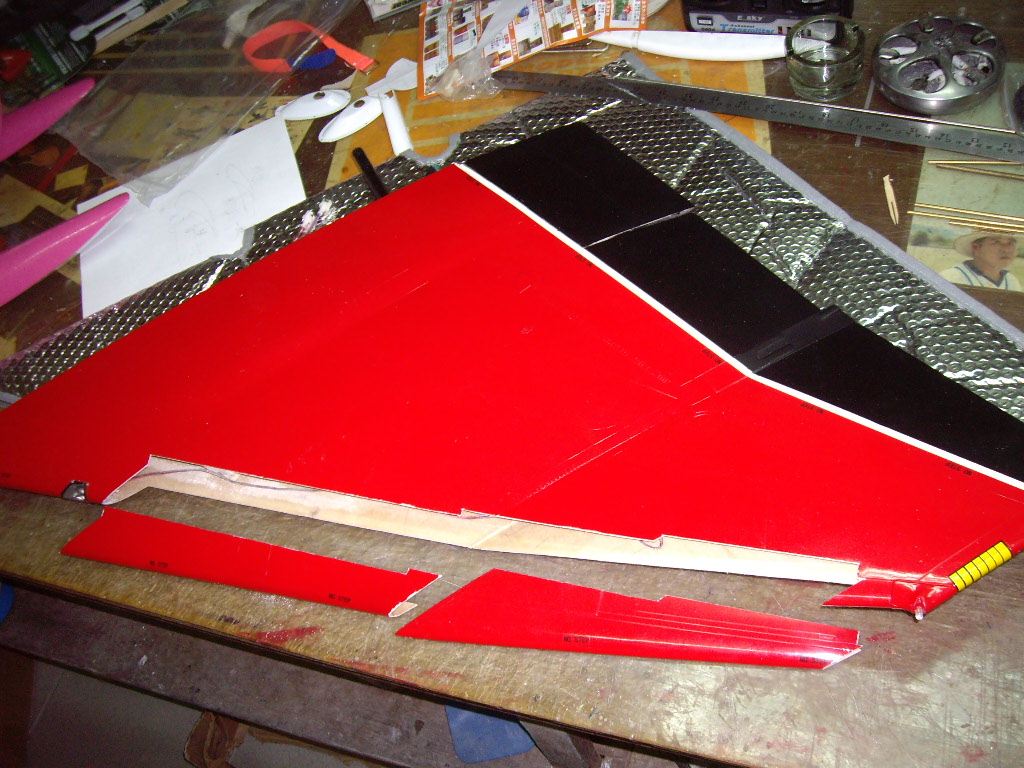

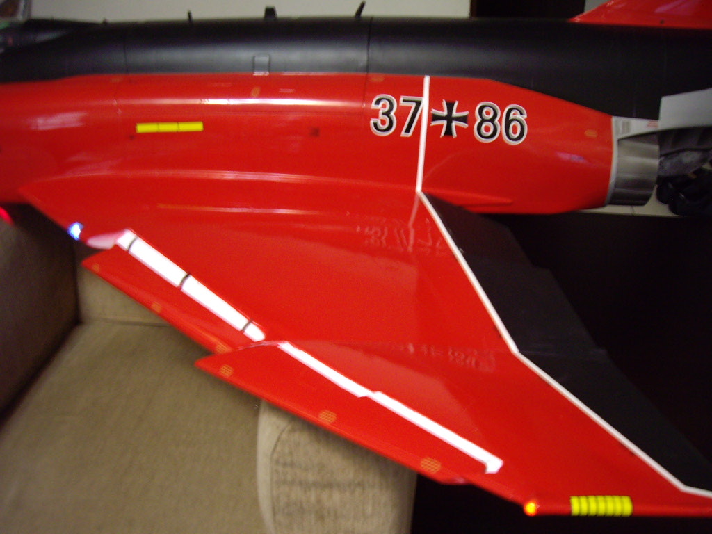

Has anyone added Slatted wings or slotted stabilators to their Skymaster or BVM F-4s? The Skymaster F-4's and all of the BVM F-4's I have seen are all "Hard Wing" and except for some early F-4Es and the current F-4EJ/EJ kai, all of the later F-4 variants had the Slatted wing (and most of the earlier F-4E's were retrofitted with the slatted wing), which makes it slim pickings on a paint scheme if you really want to make it scale.Thinking about giving it a shot with my Skymaster 1/7 F-4E. Just looking to make a fixed outer slatted wing, not a functioning one.

I am pretty sure John Redman was doing a BVM with a slotted tail, I can't remember if it was an F-4J (short nose). David Gladwin's BVM F-4J model has a slotted tail
Don't remember anyone doing the wing slats of an E model.

Lavi Rider was working on a set of slotted wings some time ago for Joe Grice but not sure if they were ever finished. I think the F4 build thread that John Redman was doing showed the slotted tail he completed.

I saw a photo of David Gladwins BVM F-4 with the slotted stabilator when I was Googling the subject. It did look nice and compared to the wing slats, shouldn't be too hard to accomplish (famous last words). The slatted wings are what have me a bit apprehensive....

The slotted leading edge on the stab is not too bad and works well in the air.
I have never tried the "soft wing" by adding the slats. A lot of work on a model today that is unfortunately a bit small compared to all others out there. The good thing is at least it is accurate in outline. Everything out of china is ridiculously wrong from all manufacturers, but most don't seem to mind.

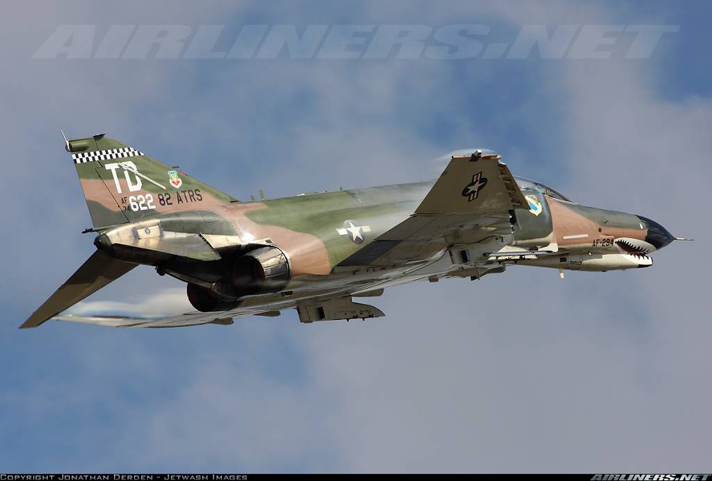

ORIGINAL: JackL
The real ones were fixed too, not moveable, so your fixed ones will be scale.

Incorrect HarryC. The slats were fully operational on the soft wing.

ORIGINAL: John Redman
The outer panel, which is what he is showing in his pic in the op, had fixed slats.

ORIGINAL: HarryC
The outer slats aren't fixed. They are hinged at the leading edge and rotate around the hinge line, with the effect that the leading edge of the flap moves up and down. They do not slide front to back as other slats, but rather rotate around the axis of the hinge line.Here is a better shot showing the hinges at the front.

Harry,
John is right on this one. I got to fly a soft wing E a few years back and as part of ground ops you drive the slats to the out position to check them. I may have a pic somewhere. Additionally it made it hard to pull to a known G of five or so because just as you'd get to 5 G, the slats would deploy and slap another G on quick.

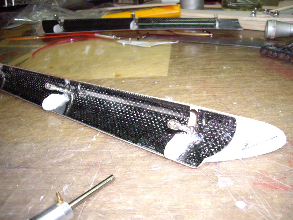

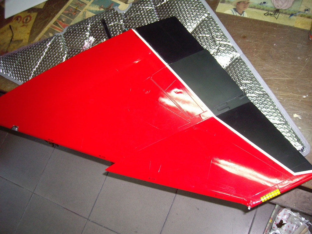

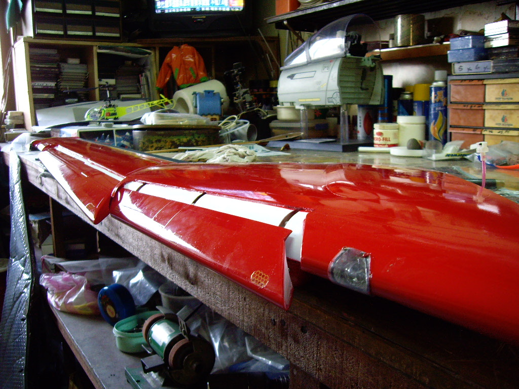

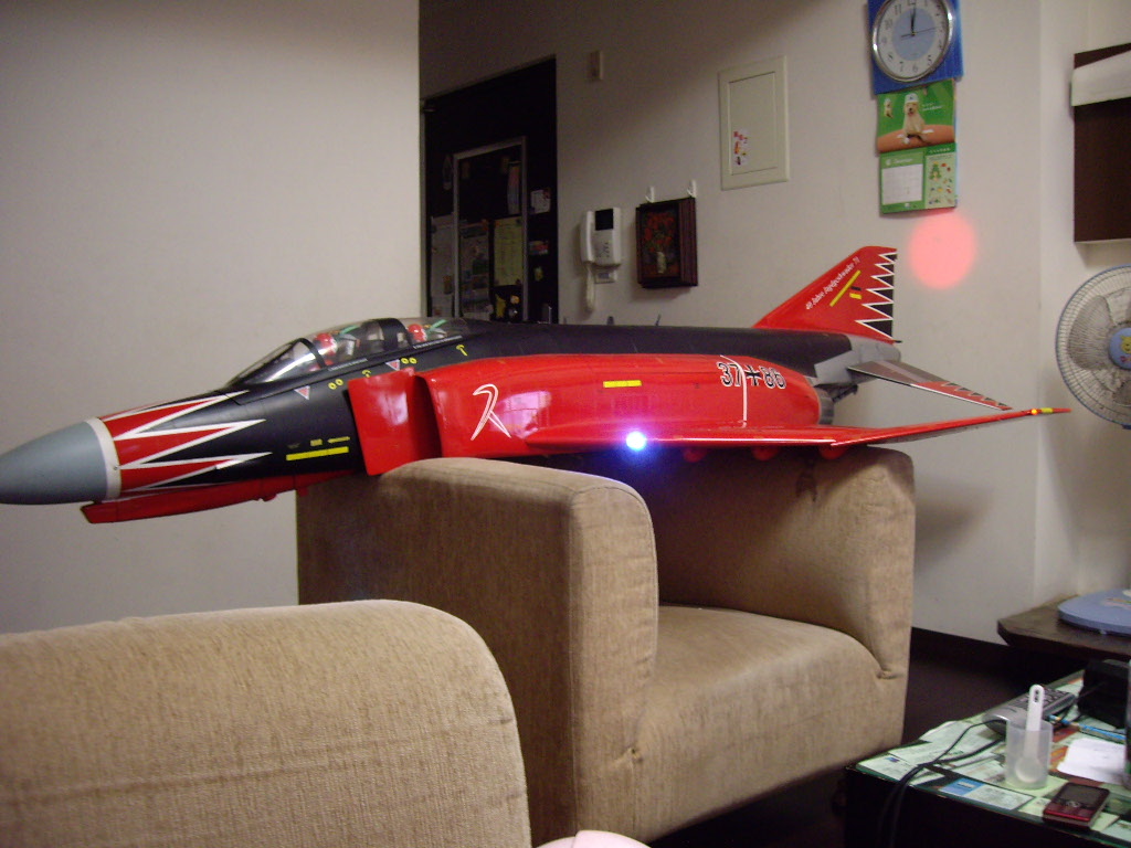

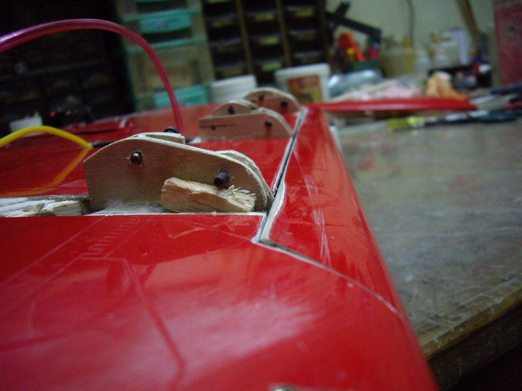

a builder of Taiwan has modify the slat for the Skymaster F-4E on two years ago, here are some pictures..

I have never had intentions of making them move, just building them to replicate the look. Moving these would change the camber of the outboard panel I believe by a fair amount. It would be great to hear from a guy who has flown teh full scale hard and soft wing to hear what teh differences felt were like.
I am pretty confident the "E" and "S" use the same soft wing arrangement.
Anton, the F-4 wing looks awesome. Only note is the slats (E model) on the outboard panel were raised off the wing and the leading edge that currently moves on that model was fixed on the full scale.
Looks cool though.

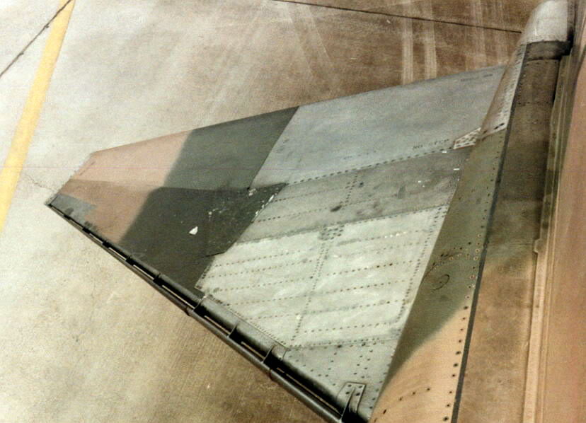

Thats right I should have been more specific. The inner slats deploy up and forward increasing the slot dimension between the slat and the wing. The outer slats pivot changing their AOA.
The net effect is the F-4's stall performance is improved so as Sluggo said it could turn around and see who is shooting at it... Thats funny but wouldnt it be shot down long before it had to turn because of the black smoke trails? []

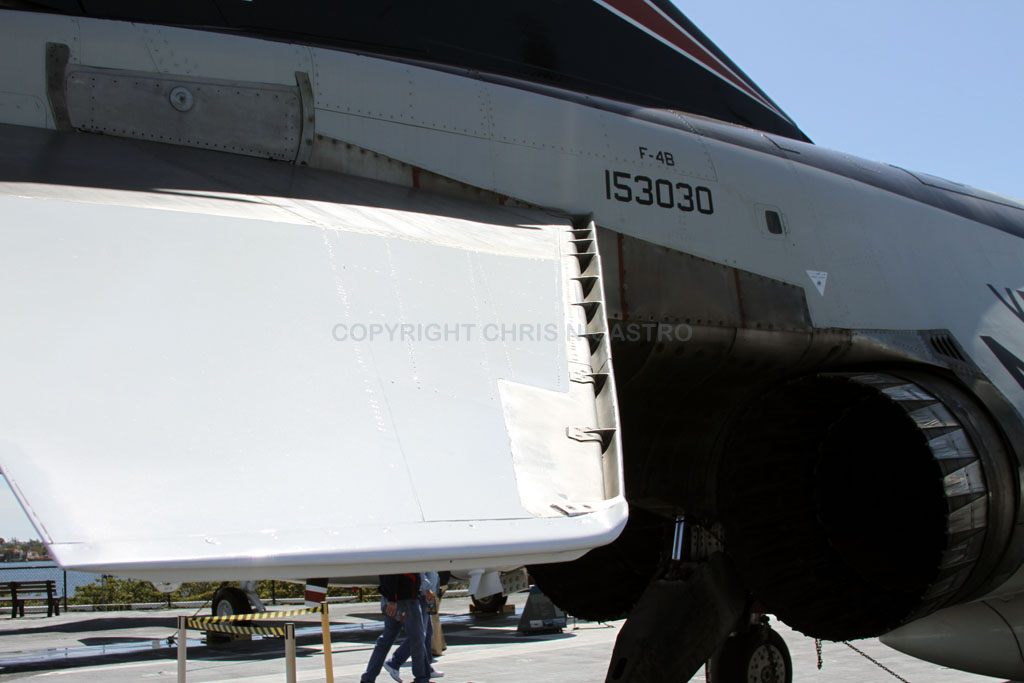

Here are some photos I took of the slats on an F-4 on display aboard the USS Midway in San Diego.

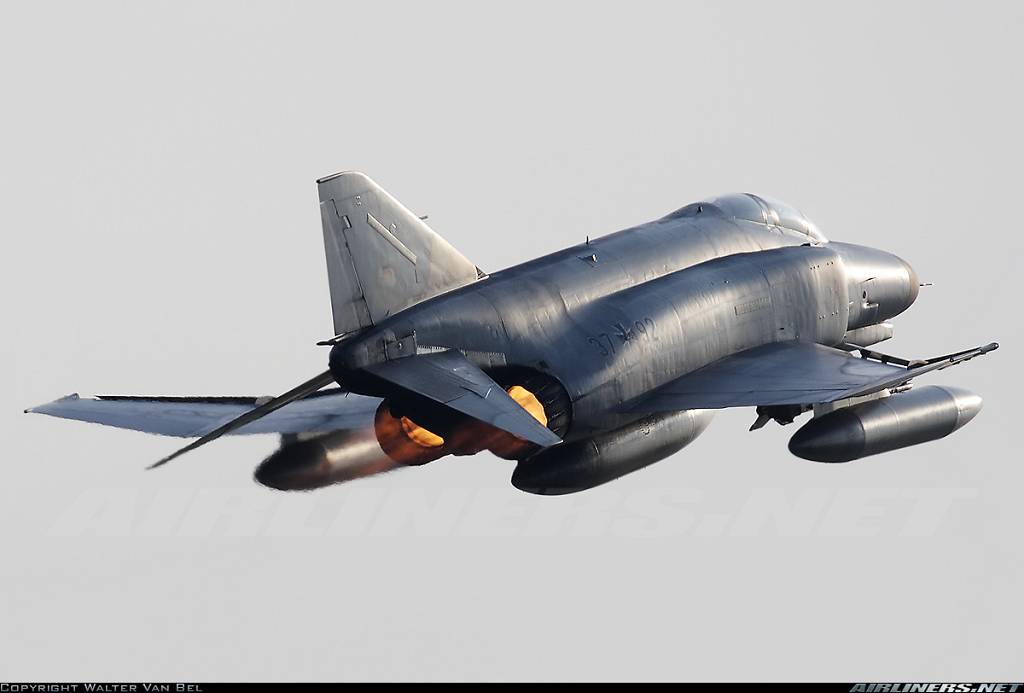

Here is a good one off of Airliners.net that shows the range of deployment. Also added some others for ref.
