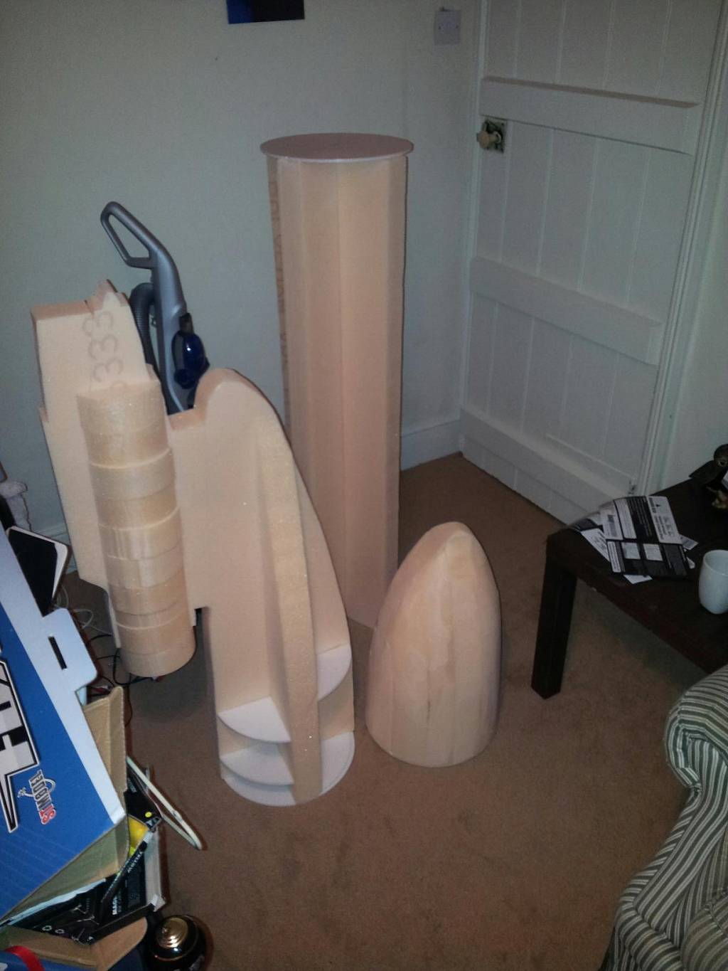

Hey guys,
I thought I would try my first build thread on RCU

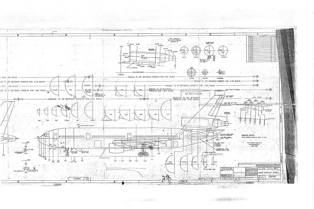

For a while I was very keen on a DC10 mainly because it could be run using 1 engine in the rear, well I got in touch with Butch and he sent me a plan which helped but was unfortunately too unclear to make good use of it to convert into CAD, long story short, I modified an old 3 view and blew it up on the printer ready to cut out on foam to make a complete fuse which I will then make a mould of for improved weight etc!
Anyway, here's a few pics of the build soo far!

Don't comment on the messy room! We have a 5 bedroom cottage and seem to just throw junk everywhere, including a useless sofa that the cats like to have a play with (claws, teeth, you get the idea!)

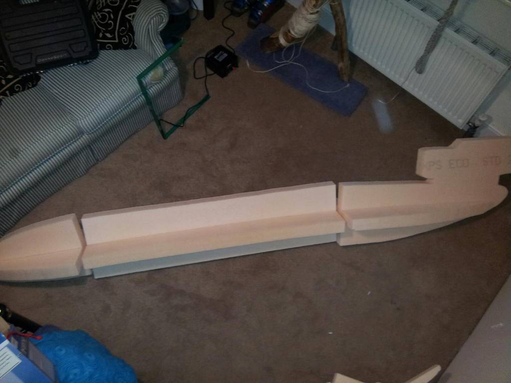

I hope to have a fully made fuse by close of play tomorrow evening. It's designed in 3 pieces for ease of transport! I'll hopefully start making it as a kit in the near future

That's the one Butch!
I'll be using your plan for the wing ribs as the other plan I made didn't have much detail (had to load it into autocad and modify everything)
As you can all see, I've been quite busy today seeing as the weather was pretty rubbish here!!!
I'm using Knauf space board which is the same structure as Dow styrofoam but cheaper! At this rate I should be done in a week, the hardest part is the sanding! I'll be adding the rivet and panel lines hopefully next weekend if I'm keeping at the same speed.

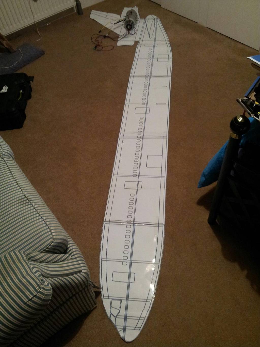

It's now the weekend for me! Early finish today so I can crack on with the build, Ideally will have it laminated and in primer by sunday evening!

Slow progress soo far but I'm sanding this beauty down as we speak!
The center fuse has been laminated with 3mm depron so the finish is perfect and will only require a coat of epoxy and cloth to then add the panel lines etc!
