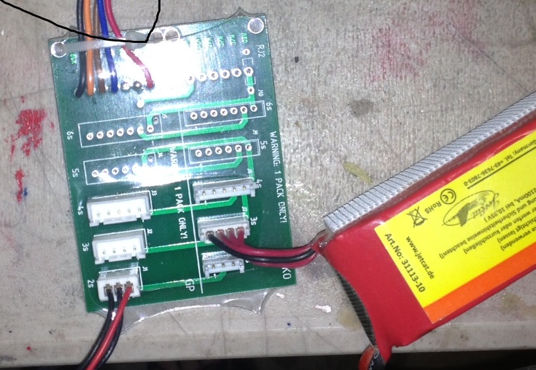

Hi,
I am trying to find an adapter so that I can charge my jetcat battery.
I have a picture attached of my cellpro board and the 4 pin jetcat plug.
I previously bough an adapter from jetcat but it still didnt fit the board that I have.
Is there an adapter that will fit the jetcat plug and fit my cellpro board?
Dave

If you are careful, you can grind the plug a little bit and just use the standard JST-XH board. The pin pitch is the same
I guess I should say, only do this if you are comfortable with balance harnesses and their polarities etc. I make my own so, its no big deal to me.

Tried that directly to the charger - no match.
Thanks though!

From cellpro, buy the KO (kokam) adapter it is the correct one for the Jetcat plug. I just purchased it and it is correct.

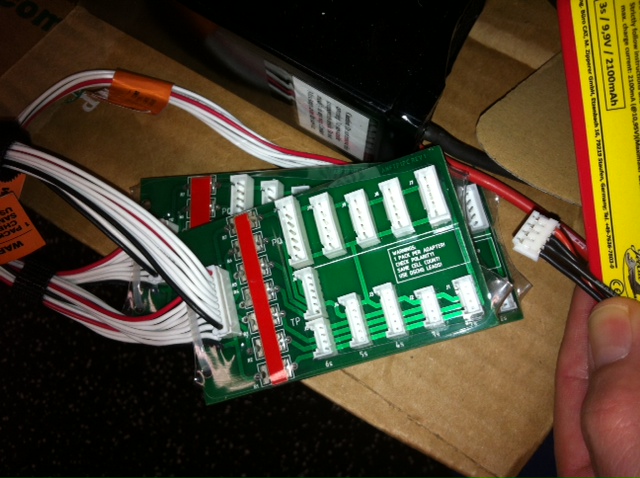

JST-EH is the same at KO according to FMA direct. The board they sell is the GP/KO adapter board for the cellpro 4. It plugs directly into the balance lead on the battery.

Jetcat doesn't use A123 packs (in the UK at least). They use LifePo4.
It's already been stated what the plug is - it's a JST EH (which FMA call the KO).
The link that I posted above shows what you need. It is a new board. You could probably get a cable from somewhere (or make one) but the boards are cheap and if you ever get a pack with a different number of serial cells you won't need to buy another cable.
