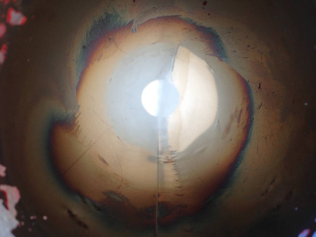

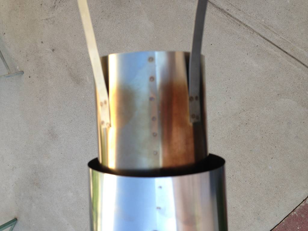

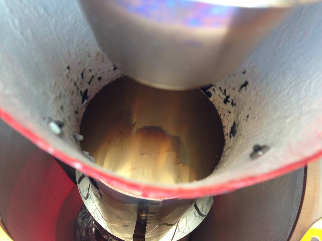

All this talk about collapsing pipes got me paranoid. I had a hot start on a bandit with a p100 on a brand new bvm pipe. What do you guys think about the color? Am I still ok? Flame was not blue.
ID:	1881237   Click image for larger version
ID:	1881238   Click image for larger version

Another pic

Here are some pictures of subsonic transverse injection and shocks created in a wind tunnel test.
Dr.V. It's about time to replace that. The pipe had already discolored on the outside, so it has become more brittle and lost 1/2 of it's strength. The welding spots at the mid section seem to be pulled apart. Most of the pipes are over engineered so they will hold for a while but why take chances when you know the risk has formed.
Mike

ORIGINAL: mikedenilin
Mike
Well, this pipe has been ran only once. The engine has been started only once. I primed it without taking the fuel line out and was not fast enough to stop the flow of fuel. It was brand new from bvm. Hot start was 2 seconds or less. Amber flame. The weld spots do not pull apart and not soft at all. The pipe is very solid. Some of those purple spots are my finger prints so the picture is deceiving.

Default RE: Tailpipe Collapse
DRV
The best way to test it at home is to press it lightly and listen to the sound. It should feel solid and no buckling sound, then it's fine. If you have repeated hot starts a few more time, and press the pipe again, you will feel the difference in sound. It will become brittle over time. Just inspect it before each flying day.
Mike

DrV, I'd hit the rear of the bypass with some additional ceramic paint though. clean it up and brush some on there. my2c.
