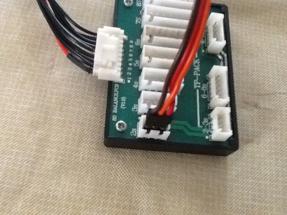

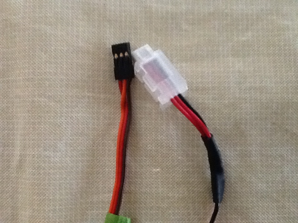

I have a Thunder Power 820CD that I would like to use to charge my A123s. My batteries all have a JR connector balance lead as I have been using a Celpro 4 charger. The TP charger will allow me to balance the batteries when I need to. I have thus far been unable to devise a way to charge the batteries using the 820. I build a lead that would plug into the 820 and that didnt work. I then used the main leads just a I would with a LiPo battery...that didnt work. Called TP and they couldnt help. Anyone have any ideas?

Bluebus...got a link to the hobby king extension. Does it plug into the 820?. Built an extension from the 2 S port on TP board to the JR charge connector on the battery. Set up the 820 for LiFe 2S and just get error messages from the 820. 1 picture is worth a 1000 crossckecks.

Not at my computer now, but I'm guessing if ur adapter extensions are built & soldered well & your getting an error message than polarity is probably incorrect

You have two options. You can take a 4-6 inch extension and reverse the polarity on the signal and the positive. You can also splice a jst-xh connector with the correct polarity to an extension as pictured.
