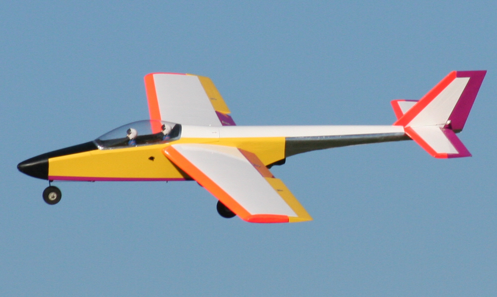

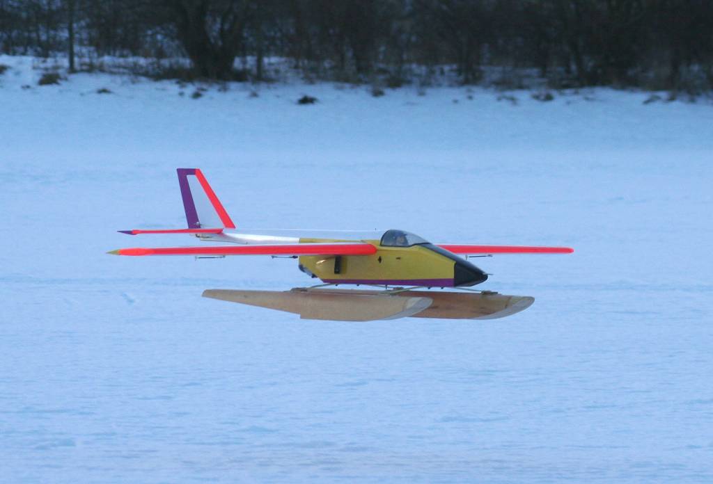

However, for years I have been promising a drawing to Tony Stephenson, boss man of Traplet Publications who publish Jet International and R/C Model World.
I really must get on with finishing the drawing and writing an article to go with it. I am sure Traplet will do a laser cut wood pack if, or rather when, I get round to it.
I will start a thread on RC Universe to celebrate (didn't mean to hijack this one, sorry).
P.S. it looks good and flies well on floats too.
