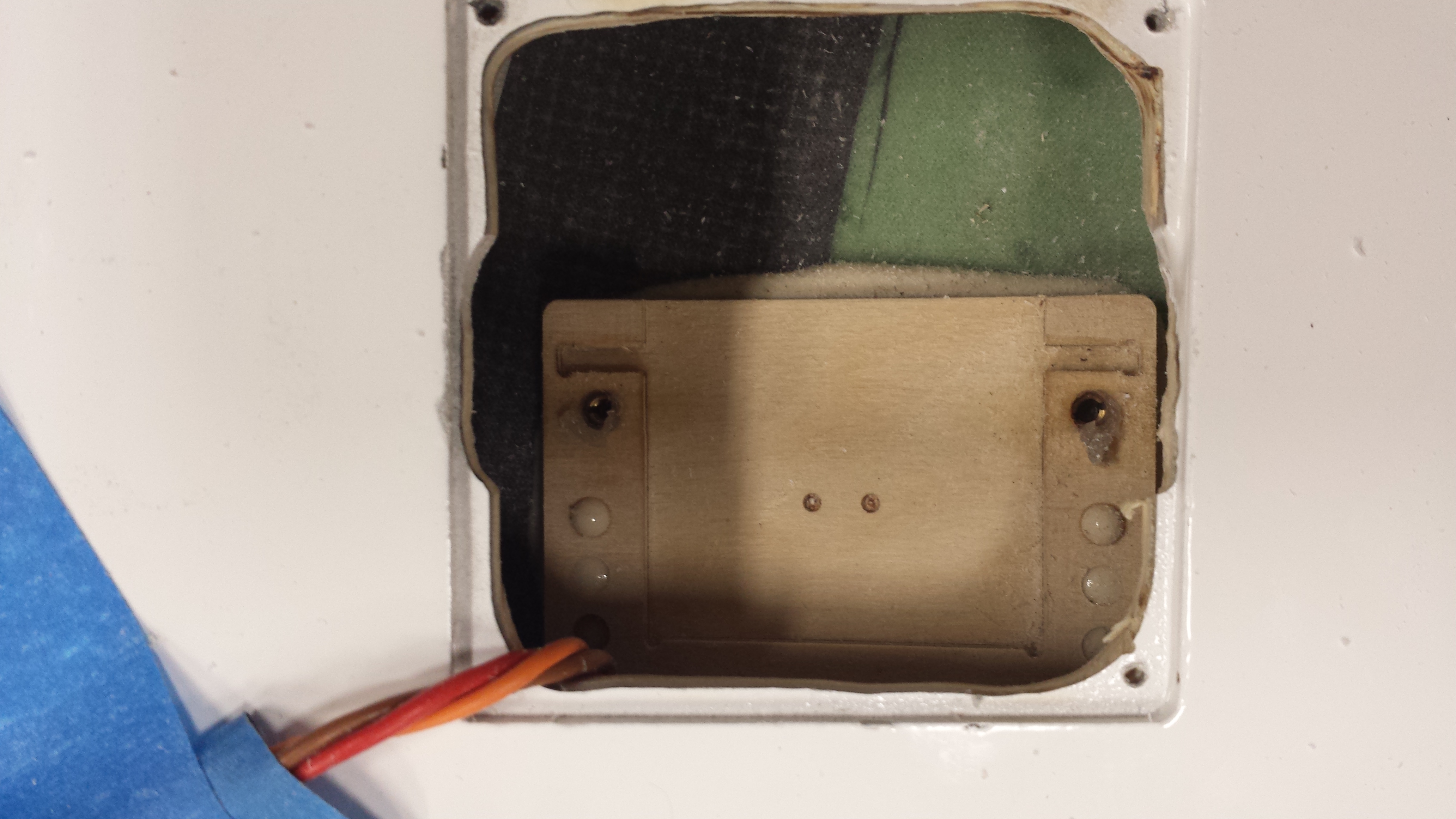

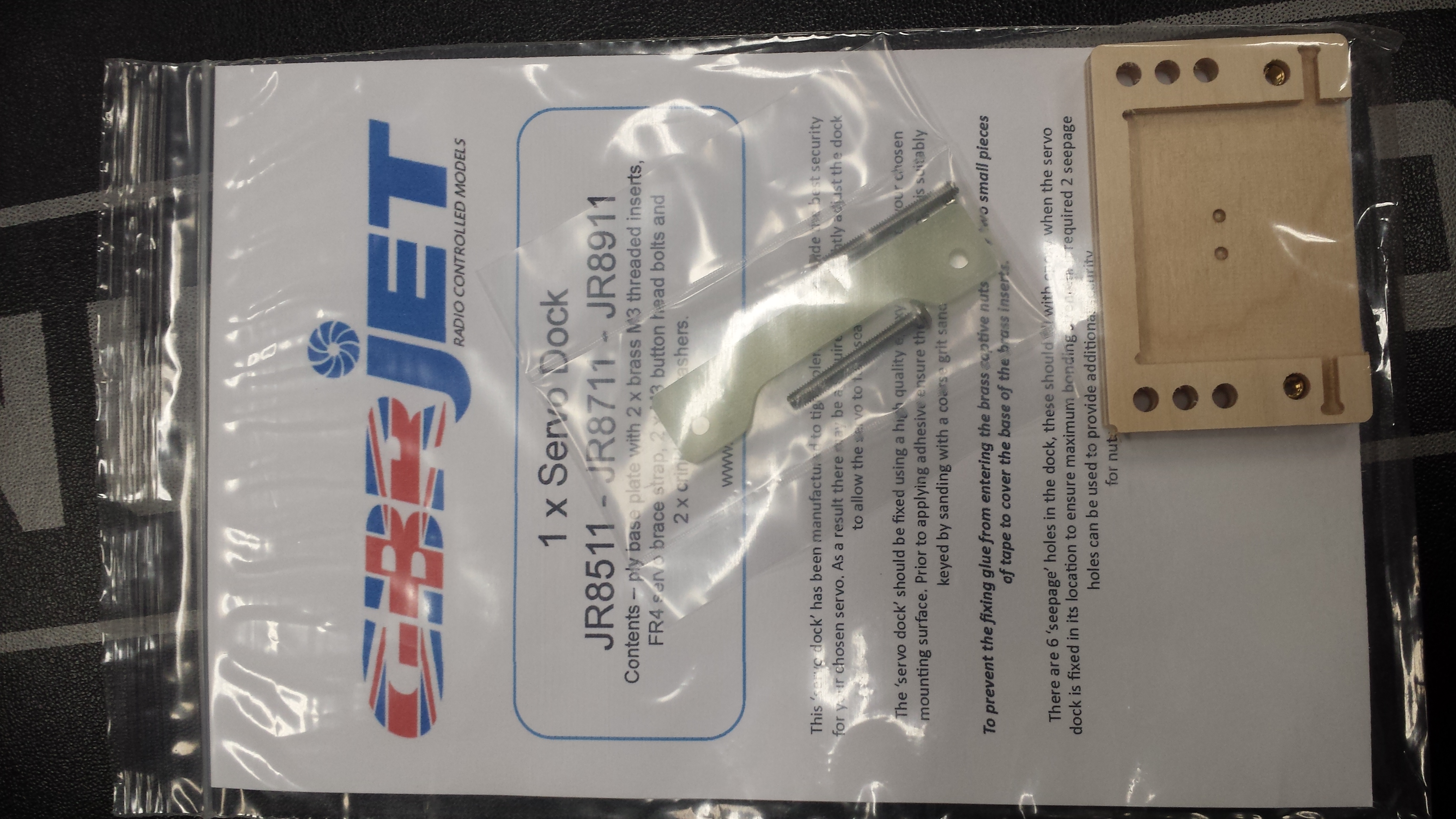

My Feedback: (48)
First of all a 8711 will not fit in it. Made for a 8411 possibly? One broke in my hand tonight just examining. So maybe they can do 300 in a super Phoenix but there not ground taxiing or mounting 8711's in my Diamond! I would never mount a servo to plastic! Minimalistic approach might work for 15 yrs and 1 day. There are much better systems than this 15 yr old one.
scott
scott

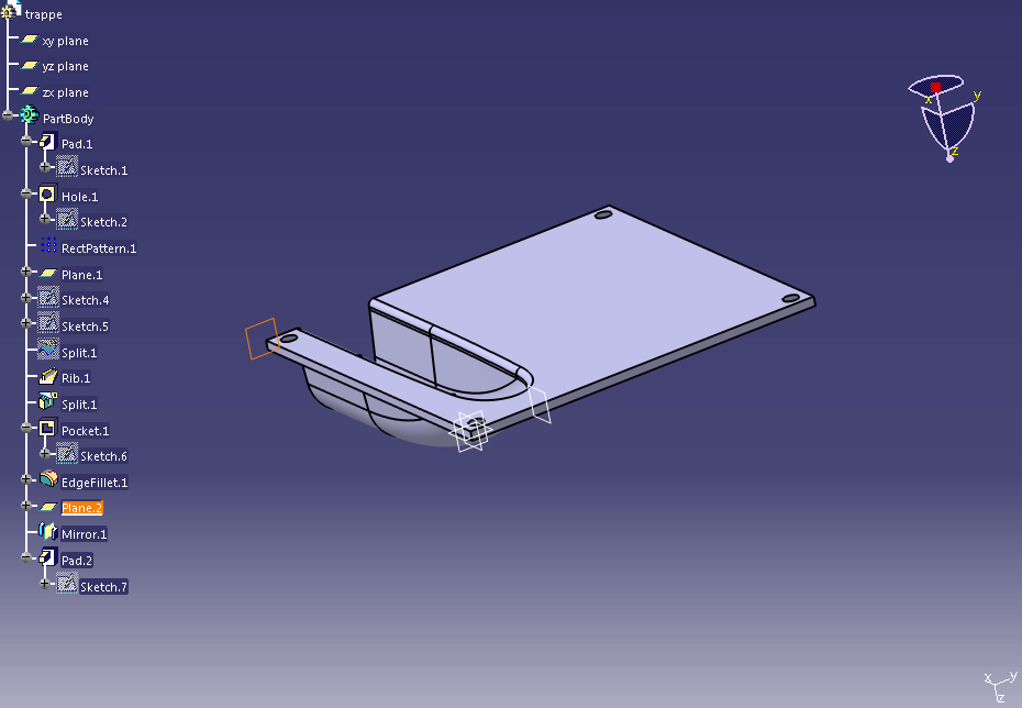

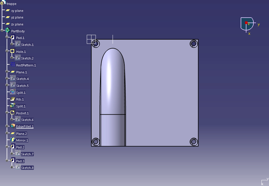

One first consideration that came to me is that due to the aerodynamics design, the flight controls require very little deflection for the flight. 10 to 15 degrees is the maximum deflection required. This is unusually low and requires a specific geometry design to avoid using the servo at a low ATV rates and stall them due to overstress ( bad mechanical advantage ).

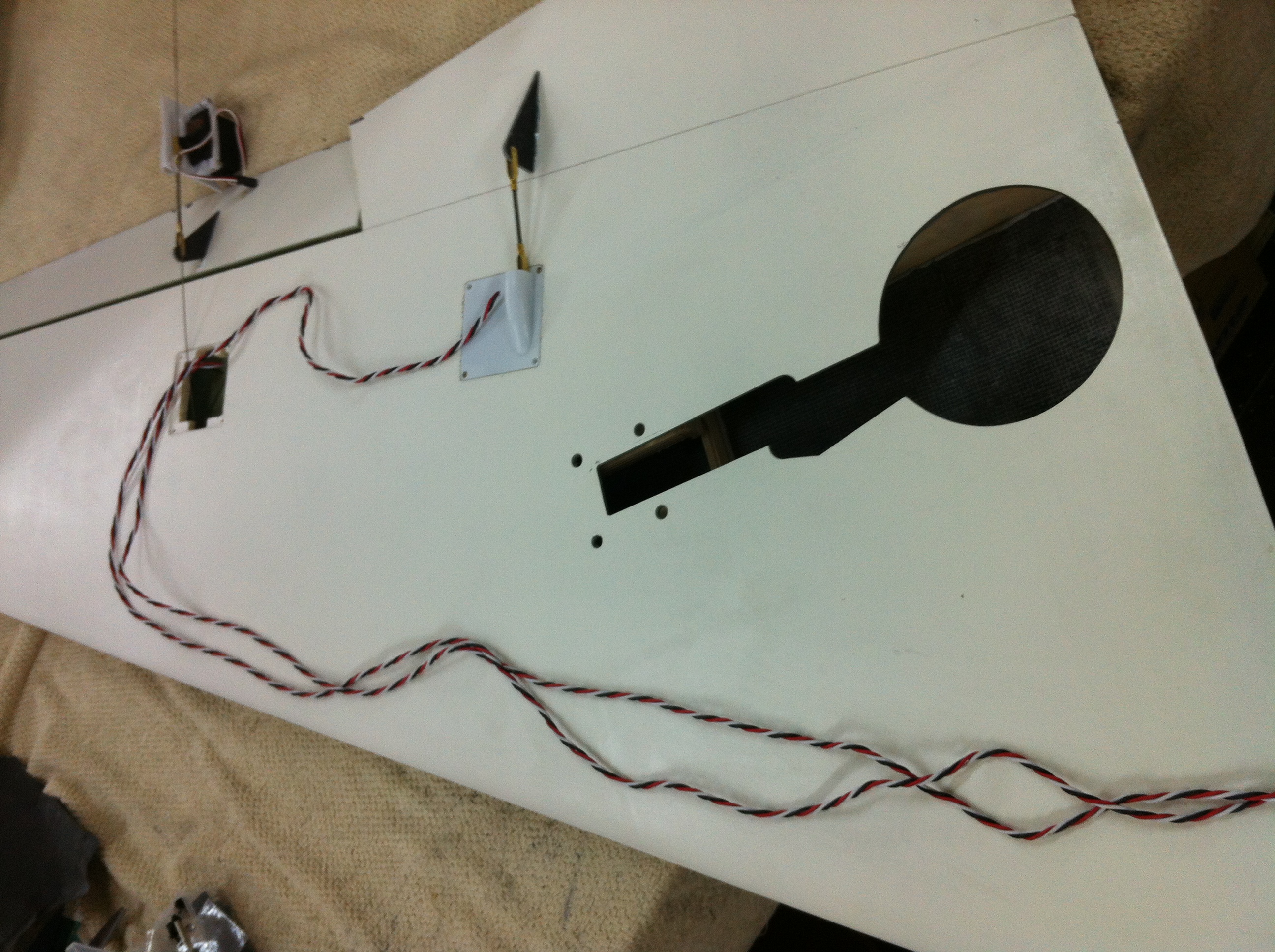

To setup the controls there are two options; use the provided ABS/ carbon covers or make integrated control links. Both methods work fine. We have used the ABS covers in all our planes for 15 years and they perform very well at speeds up to 300 mph with the appropriate geometry. The pushrod force transferred to the cover should not exceed 20 lbf though.
Each method will require a different setup for each flight control. This is because the covers place the servo high in the surface, whereas the integrated controls method would require to place the servo low in the surface on a glued servo tray.
The ABS covers require to have a fairly long control horn to place the pushrod in the appropriate angle relative the cover opening. You will also notice on the sheet that the servo offset is entered accordingly.
Elevator:
The control horn length is 45 mm and the servo arm 9 mm.
A 100 oz.in servo is enough on this control due to the specific geometry.
The pushrod force is less than 8 lbf, which makes the ABS covers suitable for the job as well as Gold Clevises from Sullivan in 4-40.
Aileron:
The control horn length is 45 mm and the servo arm 12 mm.
A 170 oz.in servo is enough on this control.
The pushrod force is less than 9 lbf, which makes the ABS covers suitable for the job as well as Gold Clevises from Sullivan in 4-40.
Rudder:
Note that the rudder is the main control that requires the highest torque due to the size and deflection.
The control horn length is 4 mm and the servo arm 11 mm.
A 220 oz.in servo is required on this control.
The pushrod force is 14 lbf, which makes the ABS covers suitable for the job as well as Gold Clevisses from Sullivan in 4-40.
Flaps:
Flaps require a very careful setup. They are very large and need to be deflected to 70 degrees for landing to provide enough drag.
That make the control need a lot of torque for the landing position.
Here is the simulation of the maximum torque required to extend the flaps to 15 degrees at 126 mph. Max extended speed is 116 mph with the recommended servo.
The control horn length is 40 mm and the servo arm 26 mm.
A 300 oz.in servo is enough on this control due to the specific geometry.
The pushrod force is 32 lbf. The ABS covers are not suitable for the job, neither are the Gold Clevisses from Sullivan.
Large ball links with dual horn required on this setup.
The maximum speed for the landing position with a 300 oz.in servo is 70 mph:
I am making specific full carbon fiber servo covers/ support for this setup.
I recommend the excellent Futaba S9156 for this setup, or higher.

Here is a screen capture of the CAD file for the carbon fiber servo hatch:
The aluminum mold will be CNC cut tomorrow. I should have the first prototypes by the end of the week.
I am working on the Diamond loom right now.
It will be available as an option, just like for the Scorpion Mk II.
Emcotec EWC 6 and EWC 3 industrial quality plugs, MIL spec AWG 20 PTFE/ silver servo cables, MIL spec kevlar protection sleeve, Latched polarized servo plugs...
The picture below shows where the loom passes by in the wing.
