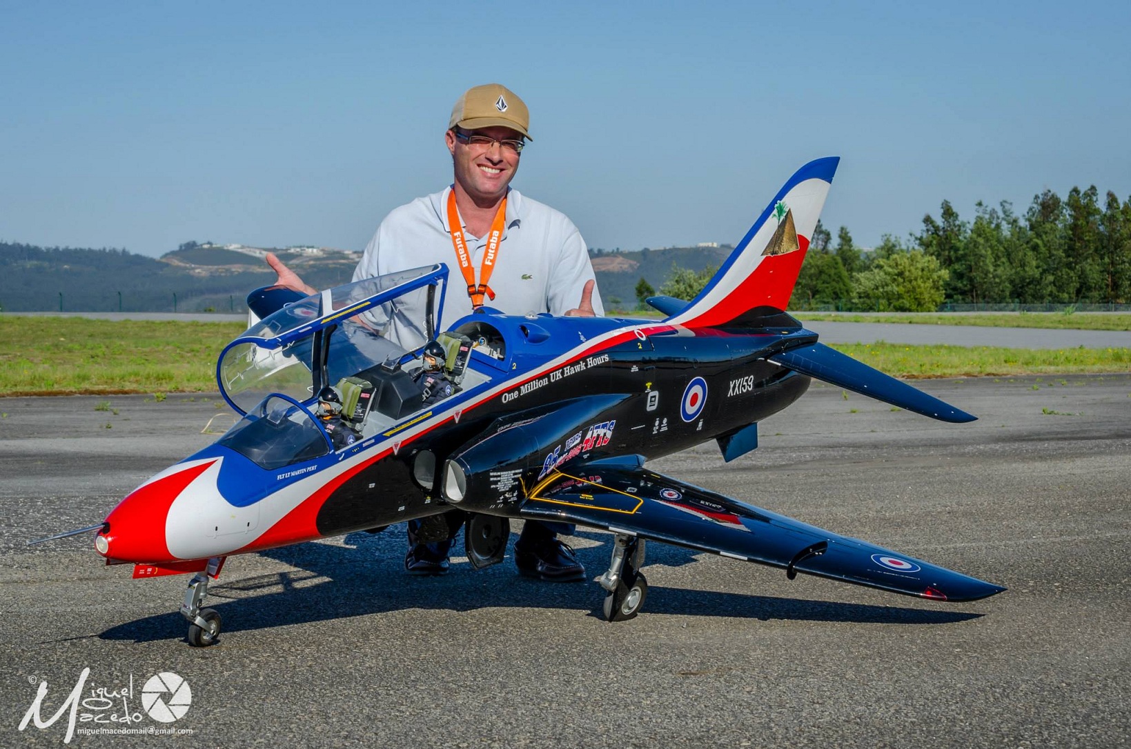

I have modeled my plane after this one. I did not found in any pics from the real plane with a rear anti-collision light. So I have a total of 5 lights
1 head light
2 position wing lights (red and green)
2 anti collision lights in top and bottom fuse
If there is one in this bird, my controller is for 5 lights anyway......
This plane was also modeled by Vitally for WJM in 2007 after a Airworld kit. From my research there are several demo Hawks that don't even have position lights.
Malcom-what is your colour scheme?
Regards
