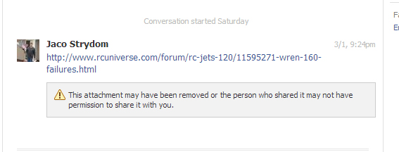

Dear Mr Strydom, I do not know who you are, or why you have sent me a SPAM message via FACEBOOK. I Do NOT own or never owned a Wren 160 Turbine.
Having taken the time to read this forum and the posts you have made i have come to the conclusion that your efforts here are nothing more than HARASSMENT of Wren turbines and their friends by a Narcissistic Bully.
I have filed a report with FACEBOOK A screengrab of your message sent to me yesterday is displayed here.
I trust you will refrain from contacting me again.
In accordance with the Protection from Harassment Act 1976 here in the UK if you choose to further contact me again you will leave me no option but to put the matter in the hands of the UK police.
If you believe you have a legitimate grievance with Wren Turbines then may I suggest that you follow civilised procedures via an attorney or lawyer.
I will of course be reporting this forum thread that you have started on the basis that you are now engaging in a manner of conduct that is Harrassing to those un-connected with Wren Turbines.
