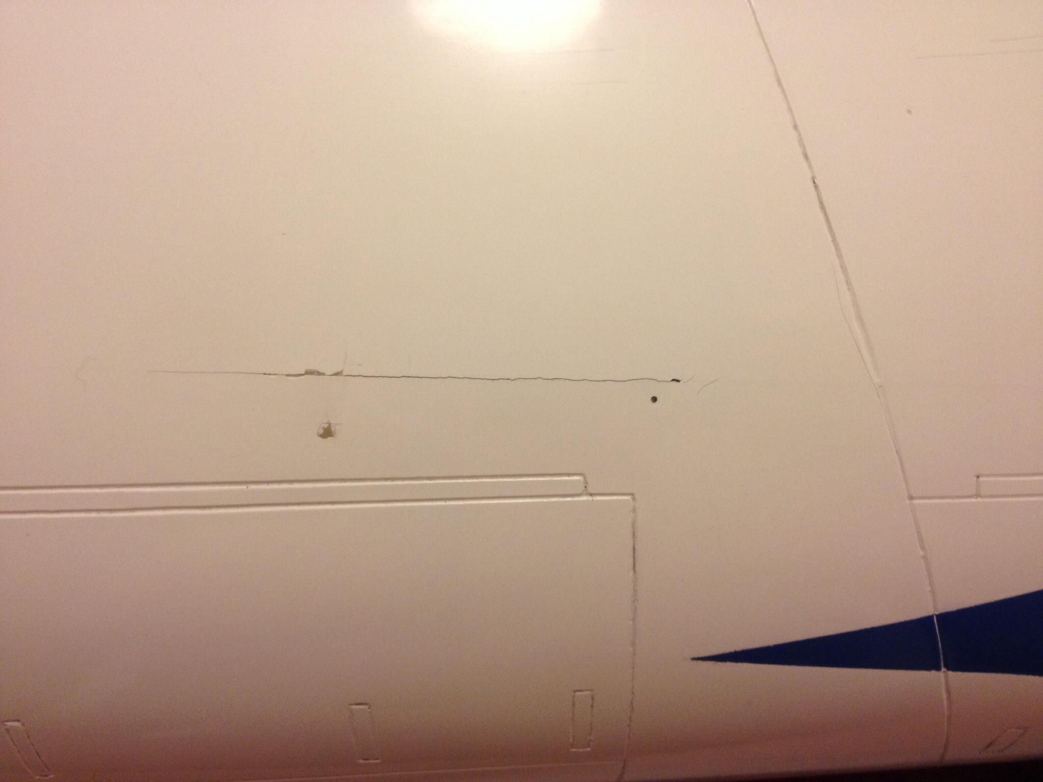

Hi everyone
I'm restoring and re furnishing my jetlegend f-15c and ATM it's in bi centennial colours which I'm not a great fan of
is there anything on the market. As in paint stripper I can use to remove the old paint ?
not only will it help me find areas that may need work but gives me a fresh canvas so to speak

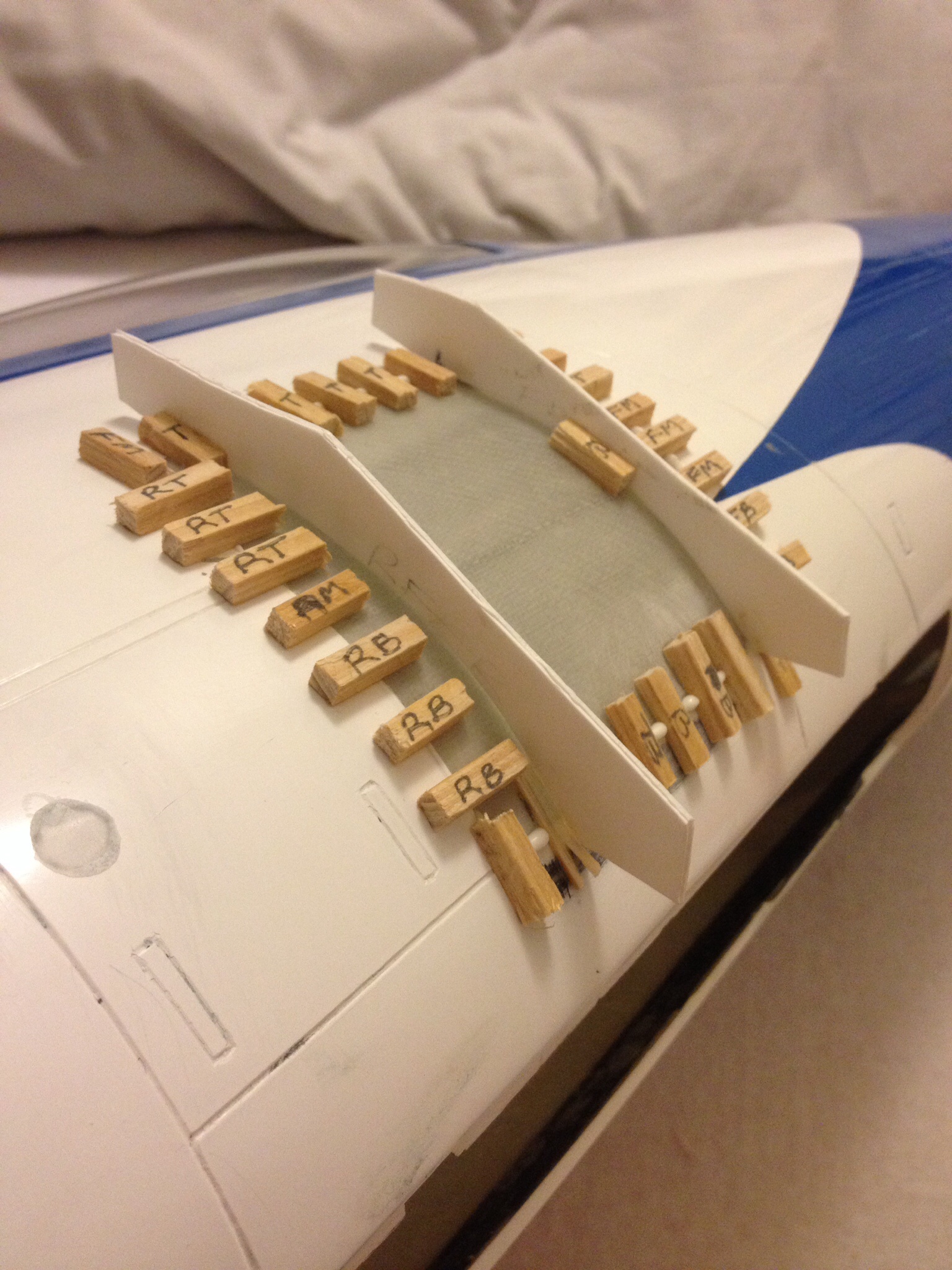

Hi all
yes it was painted in the mould but. , the previous owner must of had a hard landing and the gear gave out & cracked the fuse
He repaired it really badly and I was able to remove the repair without tools ! Luckily or unluckily ...?
so I've repaired it properly with carbon fibre and carbon kevlar reinforcement along with some thin pre made GRP
& now it's structurally sound
It was done very similarly to the picture I supported a thin piece of GRP either 0.37mm or 0.50 mm thick in place with CA glued wooden spars which are sanded to follow the bend of the fuselage the two white formers are to hold the GRP to the correct curvature of the fuse until the epoxy based resin & carbon fibre or glass fibre cures holding it in shape..
anyways along with this he decided to paint over the really bad repair with some really nasty paintwork which fills panel lines so they're invisible
so this is the paint I wish to remove firstly to get rid of it but mostly to check there are no more botched repairs underneath
soon as I final finish the repair with some epoxy based filler consisting of glass balloons and silca I can take it to the paint shop and have it primed ready for me to weather and paint
And get her flying again
thanks Anthony

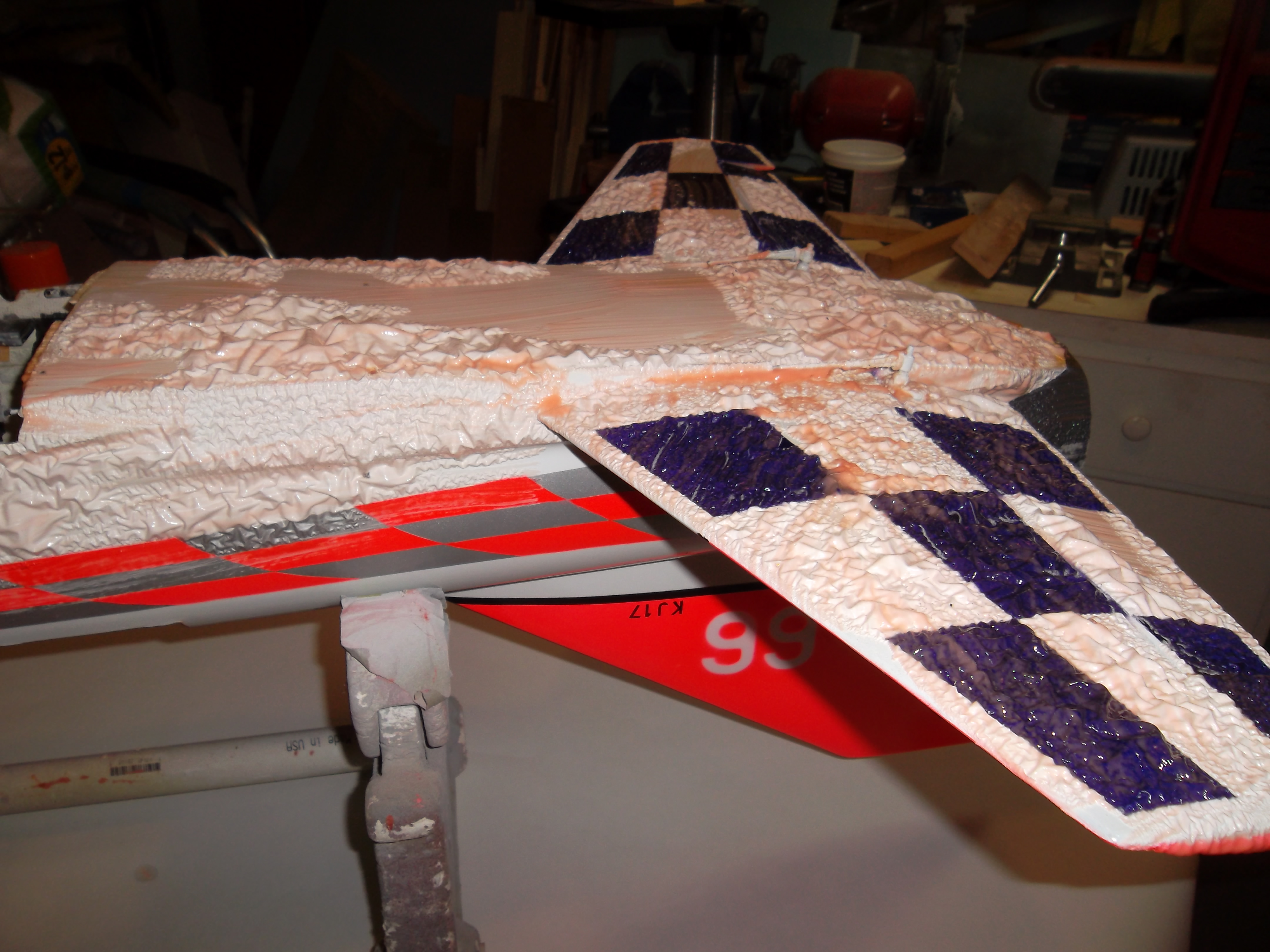

ab007:
I do not know if you can get it in the UK but here in the states we have a non toxic paint stripper called Citristrip (http://www.wmbarr.com/product.aspx?catid=36&prodid=63). This is really great and I have used it to strip polyurethane from my BVM Maverick and am now using it on a Viper I am refinishing. I apply it and it must sit for a few hours to a few days depending on what kind of paint you are stripping. If it is something like a rattle can paint then it will lift the paint off in about 6 hours. If stripping a catalyzed paint (auto paint) then I have applied multiple coats over a two day period. The nice thing about this stuff is that it is non toxic, does not affect fiberglass covered wings. I let it wrinkle the paint, then scrape off as much as I can with an old credit card. Clean the surface with water, let the surface dry for a day or so and then begin the sanding process. Here is a link to a couple of threads on the refinishing.

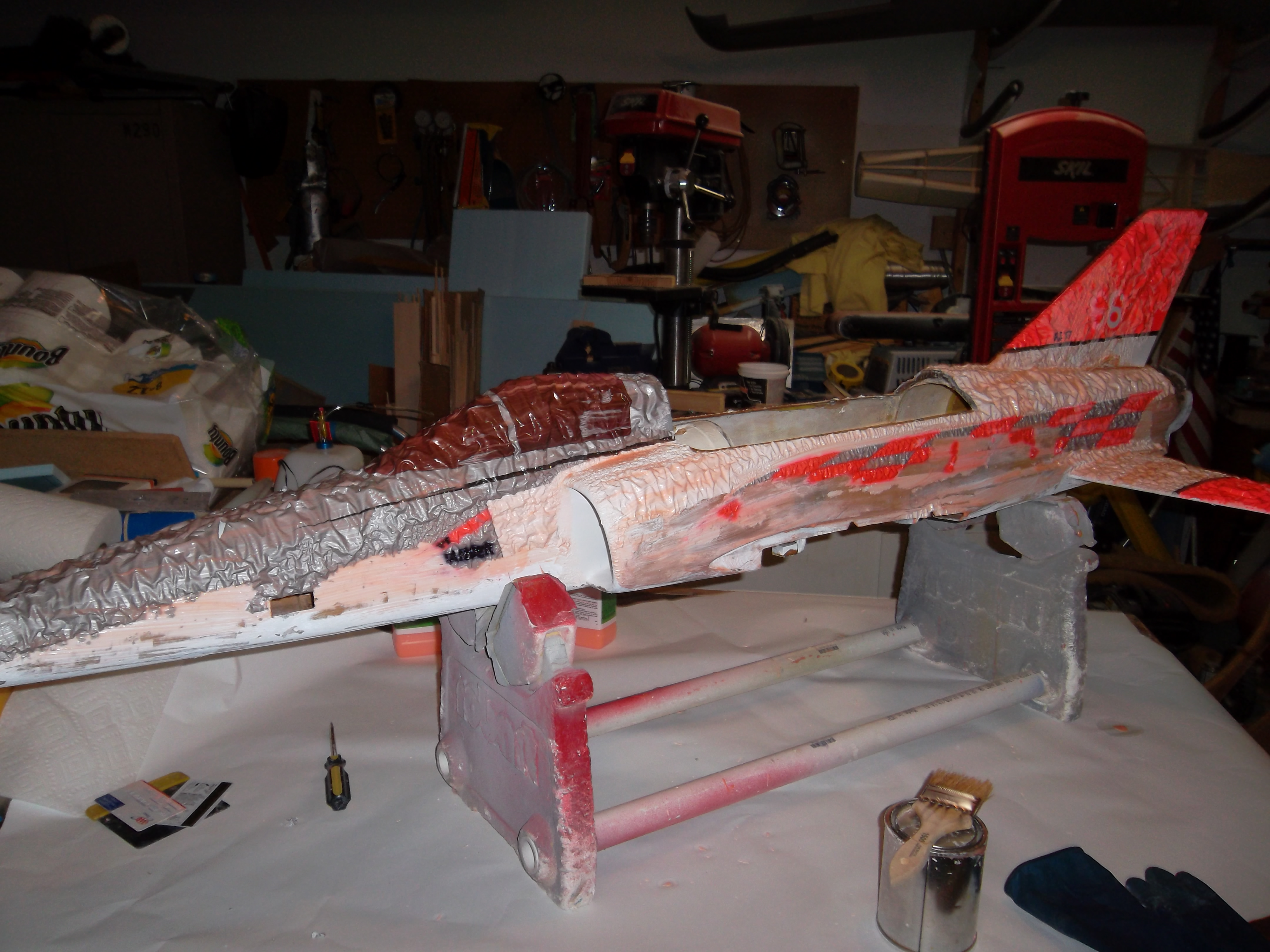

I know that you are having trouble finding the Citristrip but here are a couple of photos of what is is doing to a BVM Viper I am restoring.
Ed
