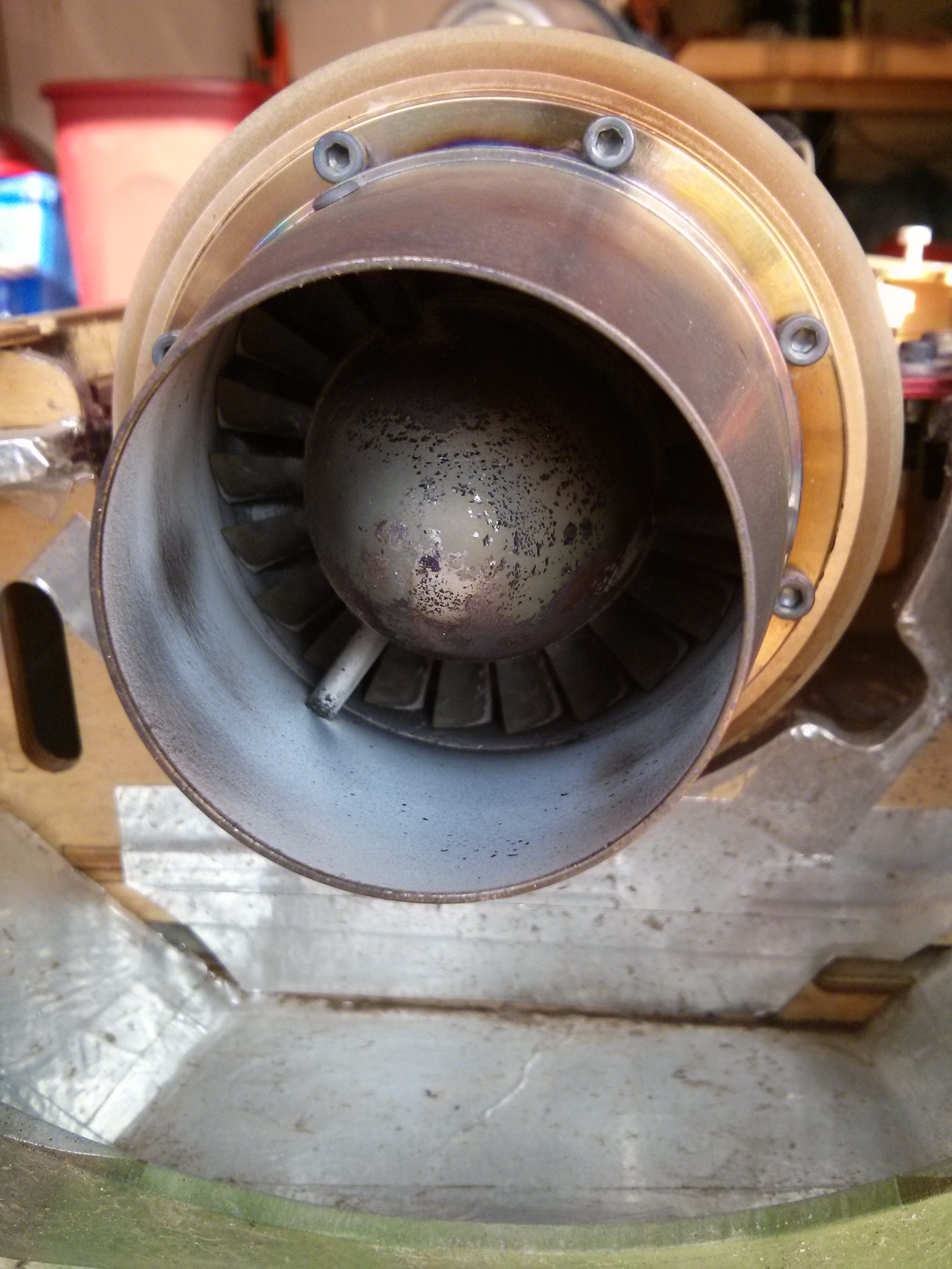

Hey Kingtech experts.. I hope you can shed some light as to why all of a sudden there are large yellow flames coming from the exhaust pipe and it is glowing red hot!! It eventually spools up and the tail cools down. This happen quit suddenly over the last 3 starts. First start was just a bit of flames... second start there was no mistaking the flames and took longer to spool. Third start took very long to spool and produced flames about 1.5 feet long. Unfortunately my GSU was not with me so no reading are available. Once fully spooled up it performed the same in the air. Seems to be a ramping issue
Any thoughts? What can I do to correct this?
Thanks!
Ps... This is on Diesel with Shell 560. 20c 10v battery

Turbine wheel rubbing? Distortion of the aft EGV causes localized rubbing, this slows acceleration artificially and the ECU over compensates on pump voltage. Once everything heats up the rubbing goes away. Does it do it on a second (immediate) start with a hot turbine?

Haven't tried starting it immediately after running. Though I will take a look at it now for rubbing while its cool.

Thanks Mr Matt... You are correct. The wheel does not turn freely so Im guessing the bearings are gone. There's no one to blame but myself as I ran 2 stroke oil early on. When the 100 first came out there was wide spread rumor that 2 stk oil was ok. Well KT never made that claim and went as far at put it in writing.. to late for me though. lol But Now I can get the upgraded compressor wheel done at the same time

I have never seen bearing wear cause flames on start up. Is the turbine making funny noises when it is finally running normally?

Yes I can see this, but in my experience anything gummy in the bearings gets washed away pretty quick. The OP says he was getting it on every start up.
What I HAVE seen is distortions in the rear bearing housings, EGV, etc or of course some schmutz that gets on the ring and starts to transfer metal from the turbine blade to the EGV ring, that gets worse and worse. These caused flames on start up.

Video on the way guys.. Its not a gumming problem. Its a serious coking problem. There is white residue everywhere. The wheel was difficult to turn at first but after about 20 turns it started to free up, so I thought Id try to start it. You can see in the video the results. Once it hit 850c I shut it down and the engine just seized up and would not go into to cool down. I had to put the blower to it and MAN does the diesel make a lot of smoke.
I just changed from 2 stk oil to shell 560 at the beginning of the flying season (3 weekends ago) and all of a sudden this!! Its a no brainier that I was better off with the 2stk oil... but it doesn't matter now as I now have 2 gallons of KT oil on hand. I will for sure be dumping fuel thats in her now.
Any suggestions guys? Should I try flushing the bearing out with fresh fuel/KT oil and try again?

aeroshell 560. Engine only has 14hrs on it. I have no doubt that the oil is the cause since it was only 3 weeks ago that I changed to that oil.
The engine cooled down again and the wheel was stiff. 20 or 30 turns again and it now spins freely.
So How do I flush the bearings.. Just stand the motor on end and keep priming while turning the compressor?

Geee!! the back end of that engine looks bad lol.. from the looks of the turbine wheel and the cone..there is now some serious rear (bearing cooking) worse it's Kero start. That means if there was repeated hot start eventually the rear bearing is going to bake. My friend have the Propane start version so it less heat on start up.. I wouldnt start it again, time to send it in.

That looks more like the EGV and bearing retainer is distorted from over heating and the rear bearing is hosed.
Aeroshell 560 did that?? I find that incredible.
