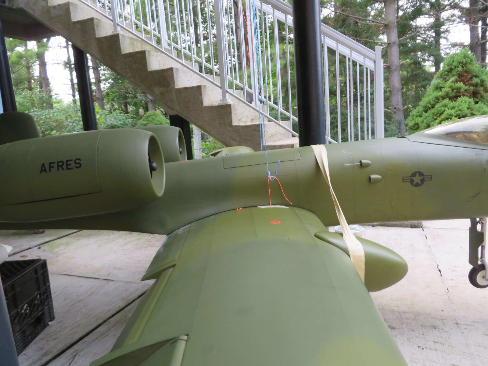

Like the pic, works.
Rcpete

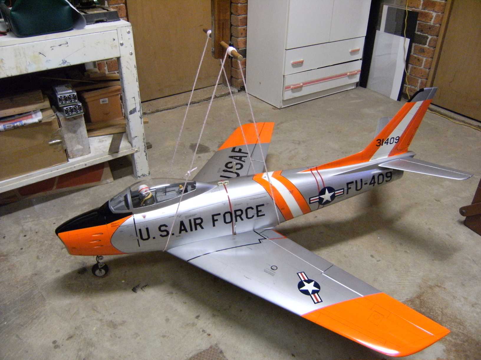

Vanessa rig for me to. - John.
