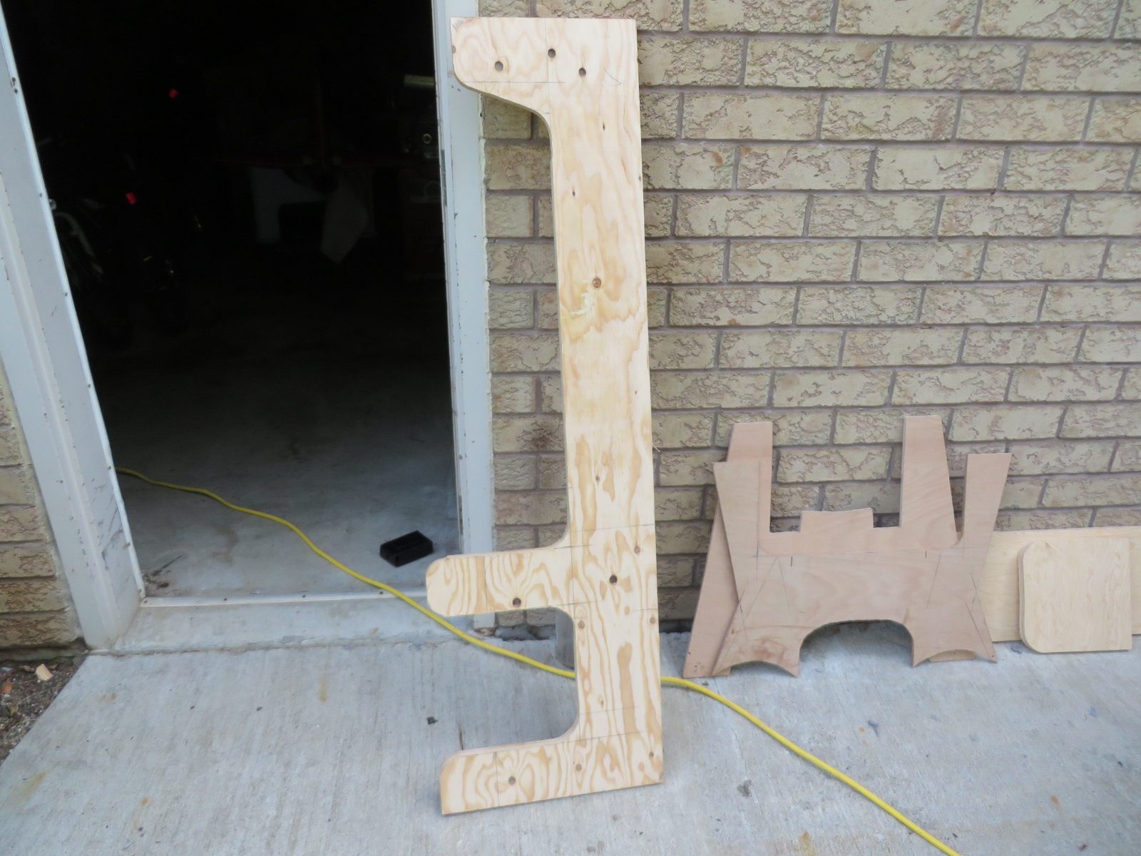

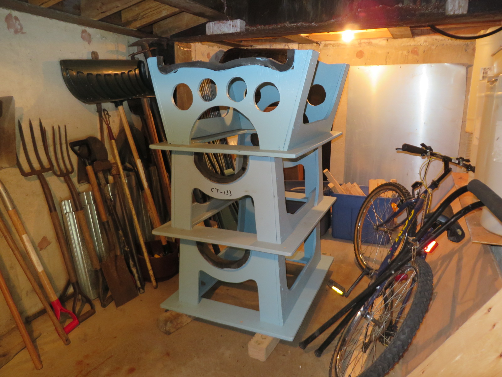

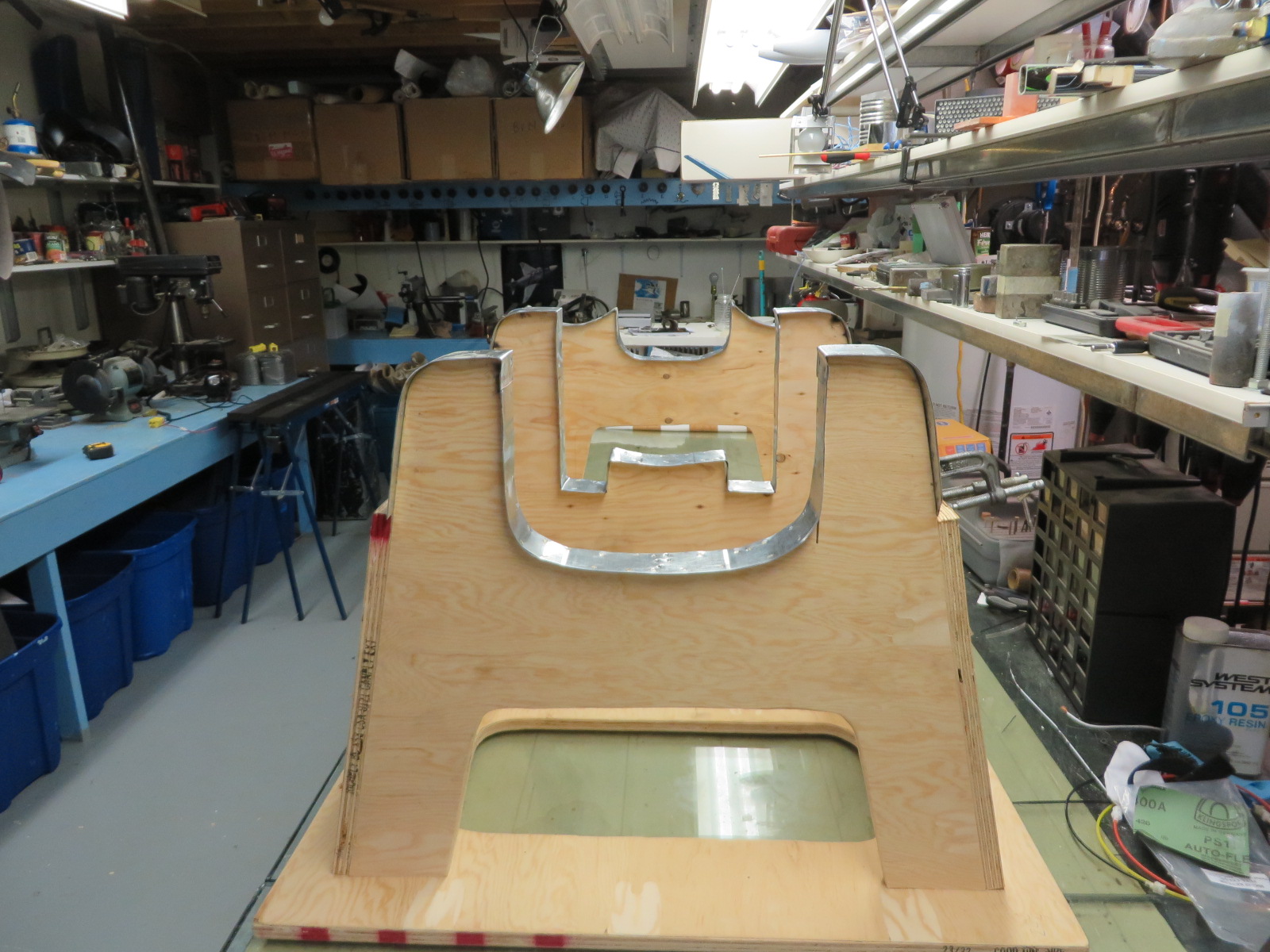

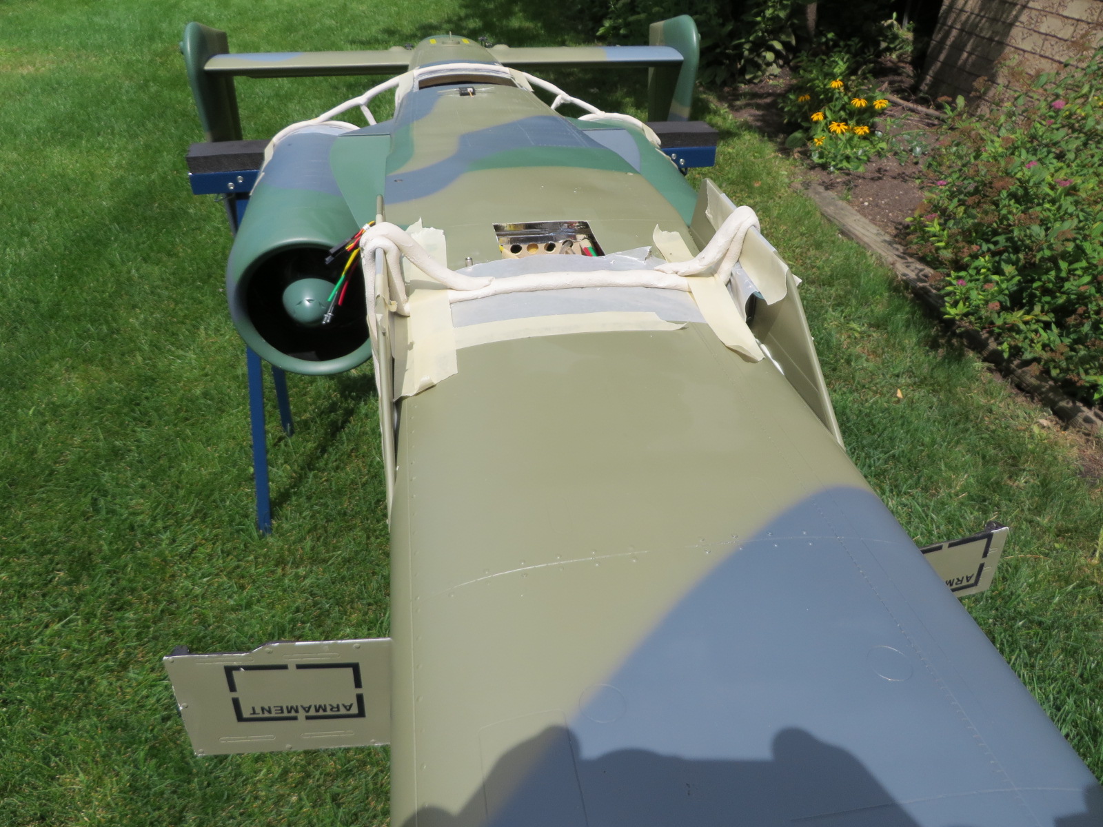

HI all, I am just about to build another stand for my lastest jet, a Skymaster A-10. I have a stand for all my jets, which has worked out well for long trips, no damage ever.
I'll start from the begining of the build, for others to pick up some pointers, if they ever decide to build one for them selfs.
First pics are some I've already built.

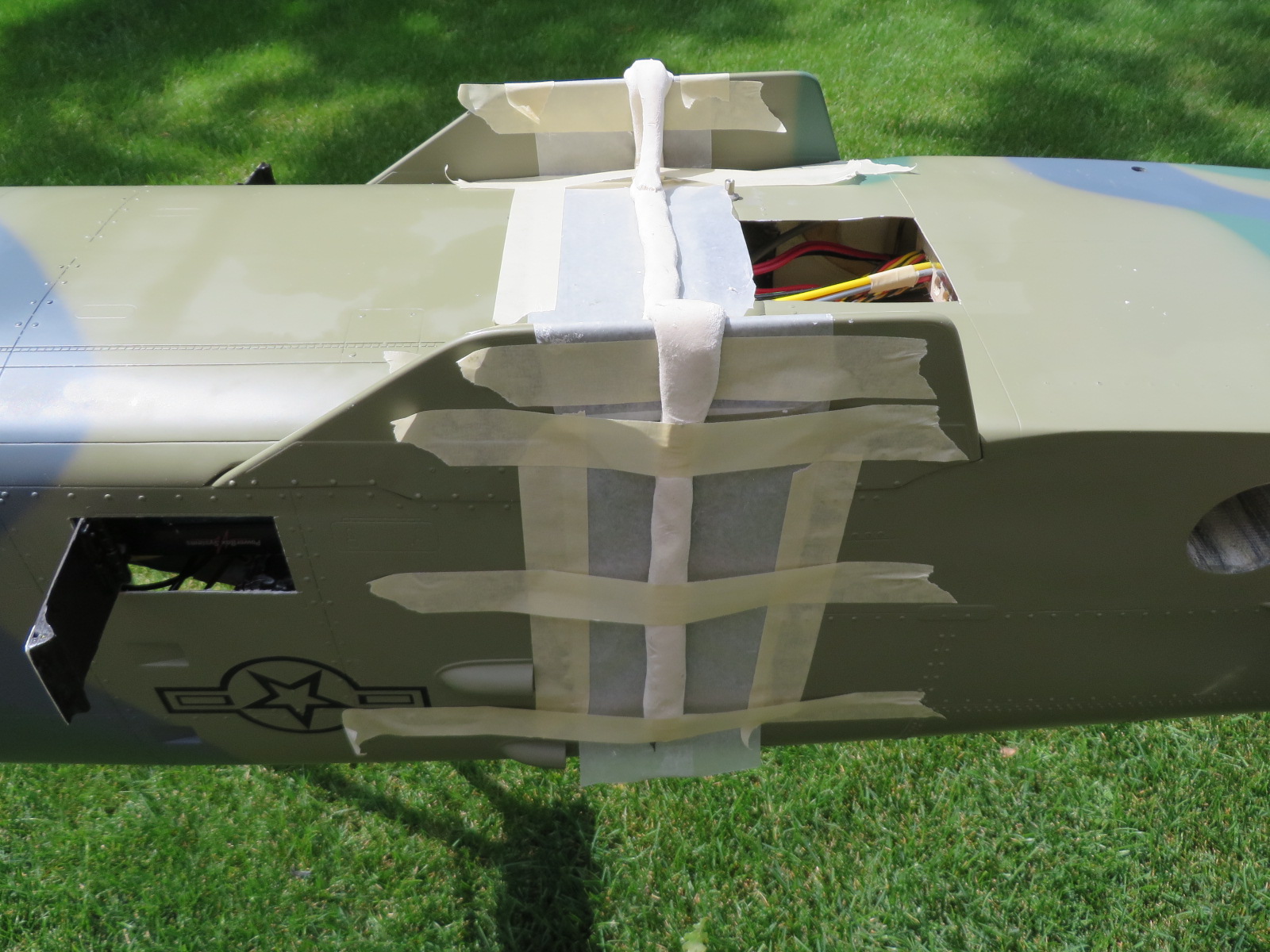

Next pics are the start, I am useing a really cool idea I got from Len Mcintosh of NY., It's bought in a craft store, see pic.
Next is to buy some plywood, more pics in a few days.
Rcpete

This is grate idea with the clay template .

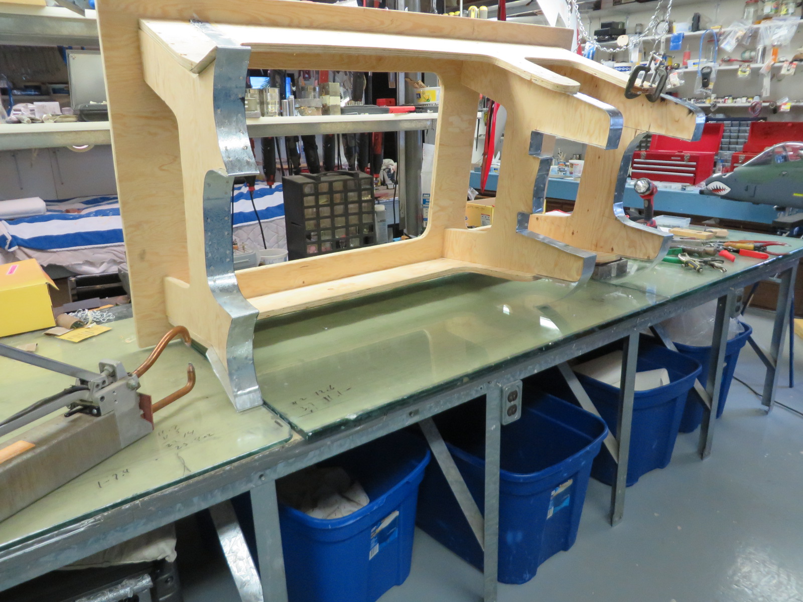

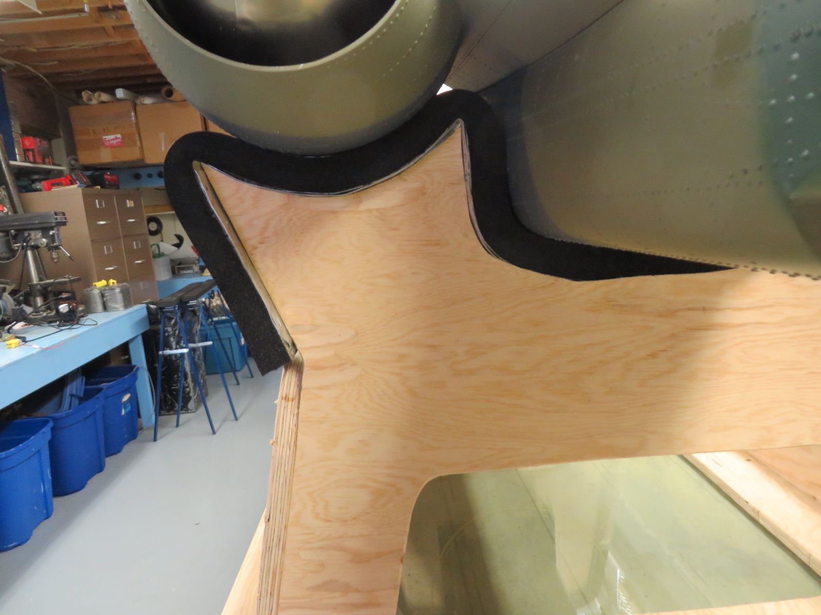

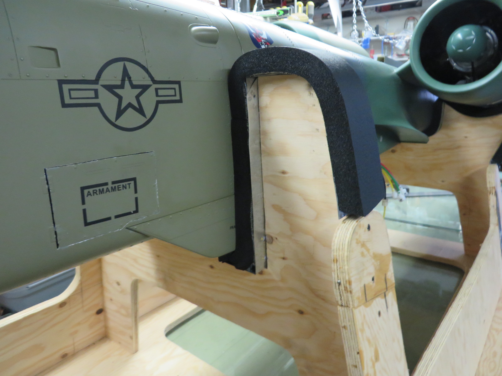

HI guys, picked up 1 sheet of 3/4'' good one side plywood and went to town, spend all day today on the stand. On this stand, I changed from fiberglass support to metal, which was much quicker. The 1''foam is called Rubatex,it's used in the Refrigeration industry, i used self adhesive.
Just need to paint it now.
Rcpete
