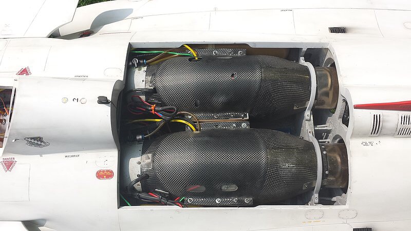

Go with k-210 or the jetcat 200 sx the kingtech it's lighter and grate service ,I have two super eagles 60 lbs thrust and this is to much ,I think Jac Diaz using two k-180 g this is just crazy .
