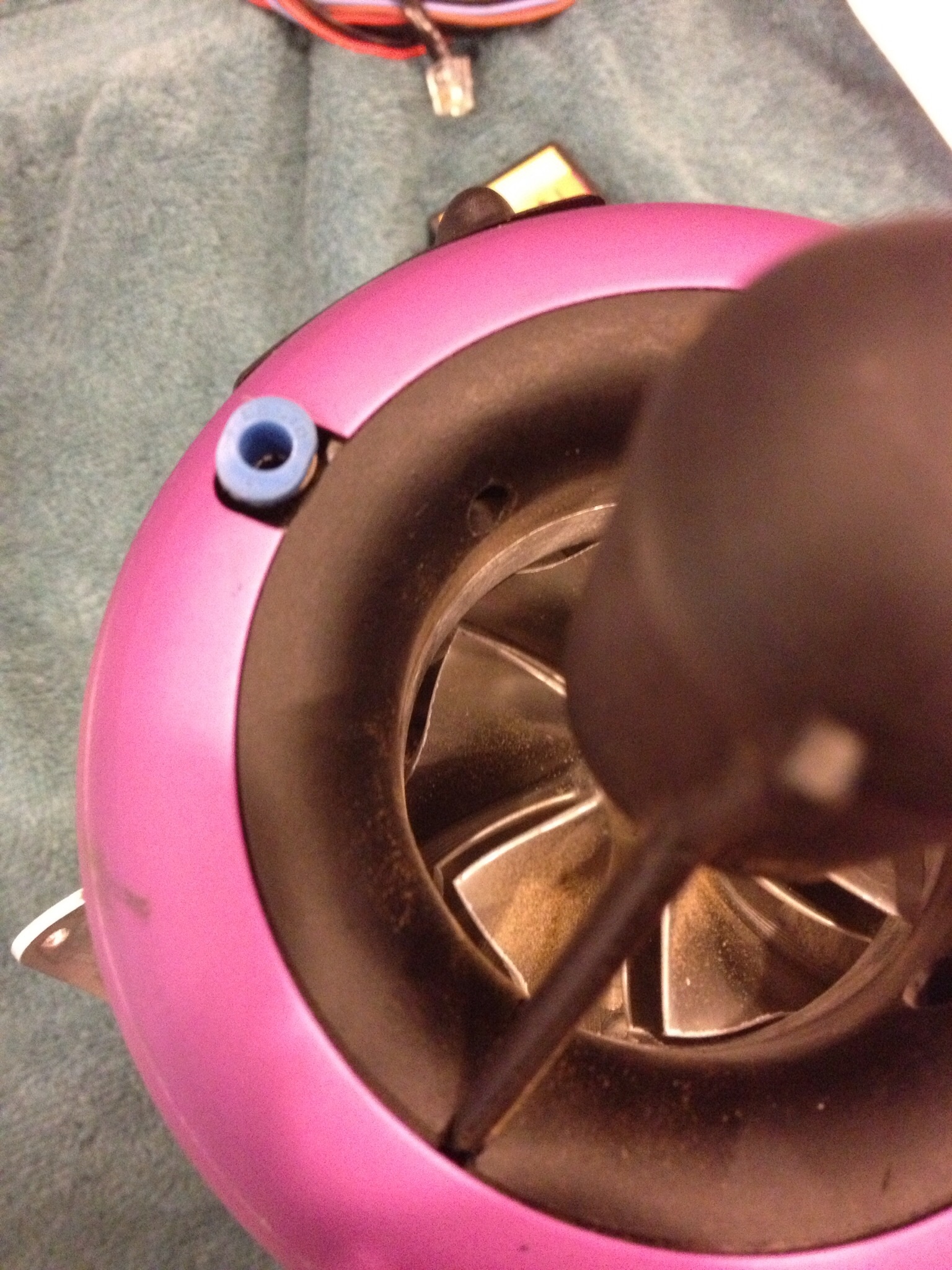

I did this to one of my JetCats.
Bob Wilcox sent it back to me with a clean bill of health. Thank God for FOD screens.

Here's what it looked like underneath:
With so much debris underneath the FOD screen, I though for sure I'd damaged it.
After coming back from JetCat after some cleaning, there was no damage.
Certainly, this kind of repeated treatment is not recommended by any turbine manufacturer!

Originally Posted by essyou35
And then the mythical question is, how do you know if there are vibs? I've tried the screwdriver thing but I can tell you on a turbine with failing bearings I felt nothing with a screwdriver. I think that is a myth.
Well think what you want it is not a myth, it comes with experience, the kind of experience that is difficult to gain by typing gotcha posts on RCUniverse. :-0

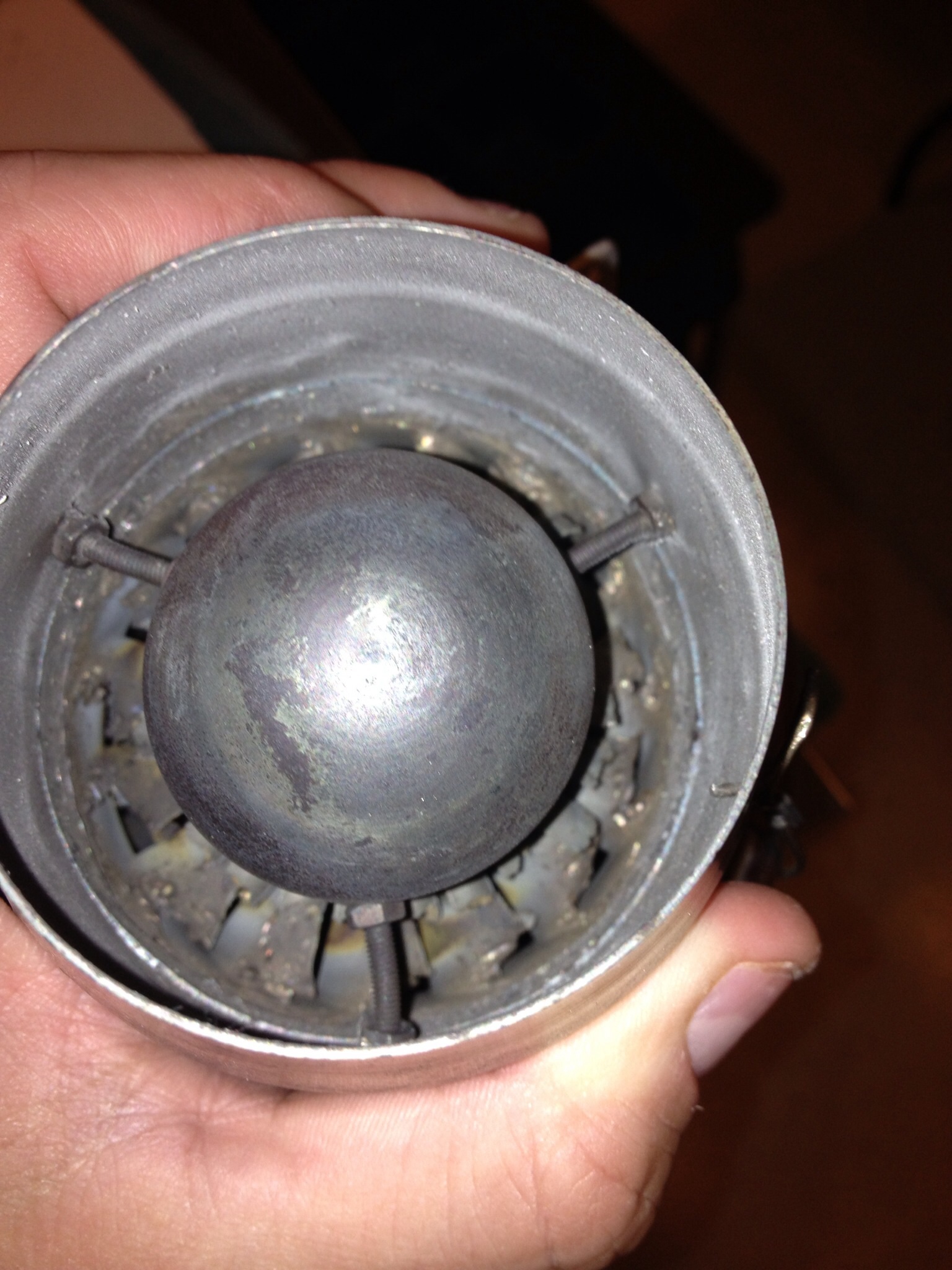

Here is one of mine. It locked up while at full throttle in the air. No signs or any issues prior to this flight. You can see where the back fan welded to the housing.
ID:	2042961   Click image for larger version
