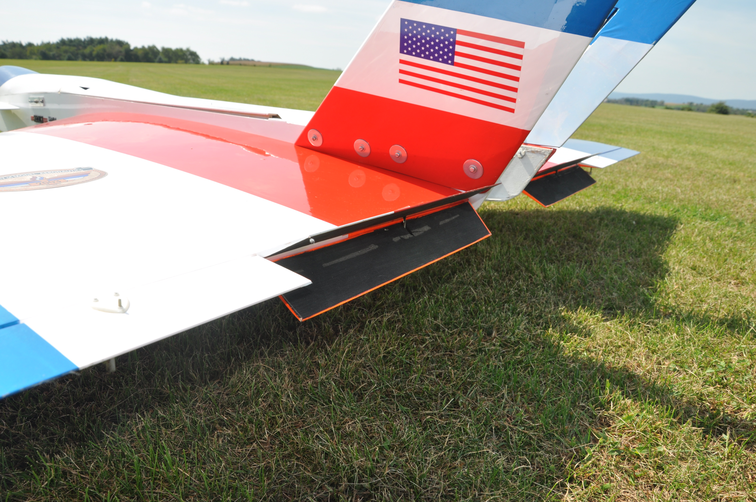

My friend had given me his Super Reaper with a Simjet 13lb turbine. Knowing the airplane had a reputation as a floater, he engineered a split-flap speedbrake for it. I have flown the airplane several times with the Simjet. There was adequate power but make no mistake, the airplane is a major floater. The speedbrake helped. More importantly, the little Simjet had very little residual thrust which is a big plus, making it easy to slow down. Between the low residual thrust and speedbrake I was able to routinely fly the airplane off of a grass strip about 600 feet long.
Since then I installed a Kingtech K100. I put one flight on it. The airplane flew like a homesick angel but on landing, even with the speedbrake open, I floated down the runway and wound up doing a few hops and busting up the nose. Pure pilot error. If you build a Super Reaper with something like the K100 you will have to count on pilot technique rather than flaps or a speedbrake. I realized after the flight that I needed to fly the Super Reaper like I do my Hotspot, namely slow it down, get the nose up and establish high alpha flight before starting the approach. I thought the speedbrake would save me but it didn't. The K100 at 22lb of thrust is probably too much residual thrust for an 18lb airplane. I bought it instead of the K80 because it was the same size and I figured I could always use it in something else.
I emailed Mick Reeves about the speedbrake idea and he thought it was pretty neat but to my knowledge has not incorporated it into the kit. He offers a few other ideas for speedbrakes in his info.
If you build a Super Reaper, don't count on the speedbrake or flaps. The speedbrake on my Hotspot is basically useless. Pilot technique is the most important part of flying both models.

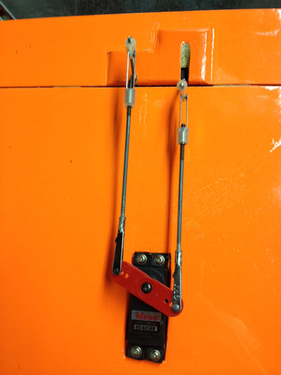

The Super Reaper in the video had the Simjet 1200. As you saw, I came a little too hot! I should have slowed it down even further. If you search YouTube for Super Reaper videos you will see that most guys make the same mistake I did, they come in way too fast. I found one video; however, where the guy brought it in at what seemed like a walking pace! The landing roll was about ten feet!
If you do the speedbrake mod, you only need one servo for each speedbrake. Just run a threaded horn through a hole in the lower half of the speedbrake. Hook up pushrods to opposite sides of the servo horn. When the servo turns it pushs one half of the speedbrake up and pulls the other one down! I wish I was the clever rascal who engineered it, but it was my dear friend, master modeler and flyer Joe Weizer.
I like the Super Reaper too. I believe the kits are only about 400 bucks, you can probably build one in a day. I am frankly surprised I don't see more of them. Mine is the Mark I, the latest one is the Mark II which looks a lot better. Once it's up in the air the Super Reaper is definitely one of the cooler looking model jets around.
Here's the speedbrake setup:
