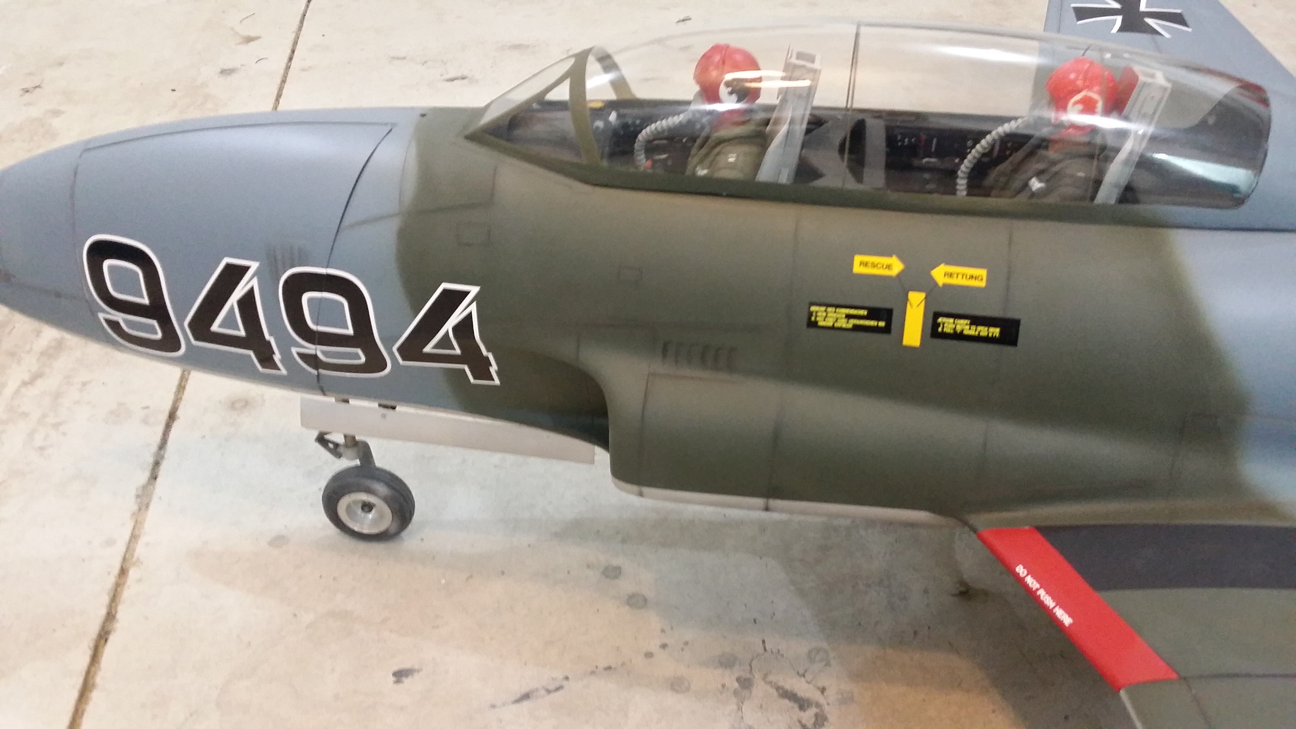

Put together BVM T-33 and painted it in Luftwaffe scheme. This is old kit that that still flys great. Was in primer for 10 years!

Great job!!! I have a skymaster F86 coming in the same scheme

Looks awesome, nice work! What paint did you use?

Used Krylon rattle can 'dull aluminum' for bottom as almost perfect match for the silverweiss. Used Krylon spray olive Green and Testors Modelmaster spray navy ww2 medium blue grey for top. Used 'Chrysler engine orange 'in spray can for orange stuff. Weathered with pastel chalk

Without using an airbrush how did you get the "soft" lines on the camo??

Hi Vince,
In the 'picture hanger department ' of Home Depot or Lowes there is removeable picture hanger material that comes in a celephane pack that looks and feels like silly putty. It is blue. It comes in squares. It is sticky but no residue. Roll it into long skinny worms about a 1/4 inch thick. Take thin poster paper, cut out camo designs, place on plane, put the sticky blue stuff under it about 1/4 inch from edge, press down then spray. You have soft edge!

If its the original BVM T33 don't forget to fill in the undercamber of the wing root section.
The "cusp" of this area makes it VERY prone to tip stalling and spinning. Been there done that !
I am told the fullsize could be quite exciting at the stall !
Filling in the cusp totally eliminates this problem and it becomes a fine flying machine.

Ditto what David said about the "cusp"-It WILL bite !
And the most aggrivating thing is it's not consistant; ie you might get a couple of great landings and then BAM it will fall like a rock. Been there and done that too !

Vin,
I don't want to hijack this thread but I used 3M foam tape to get the soft edges. It is the round foam with adhesive
on one side. When painting a car it is used for the door jams. It works great. Mike

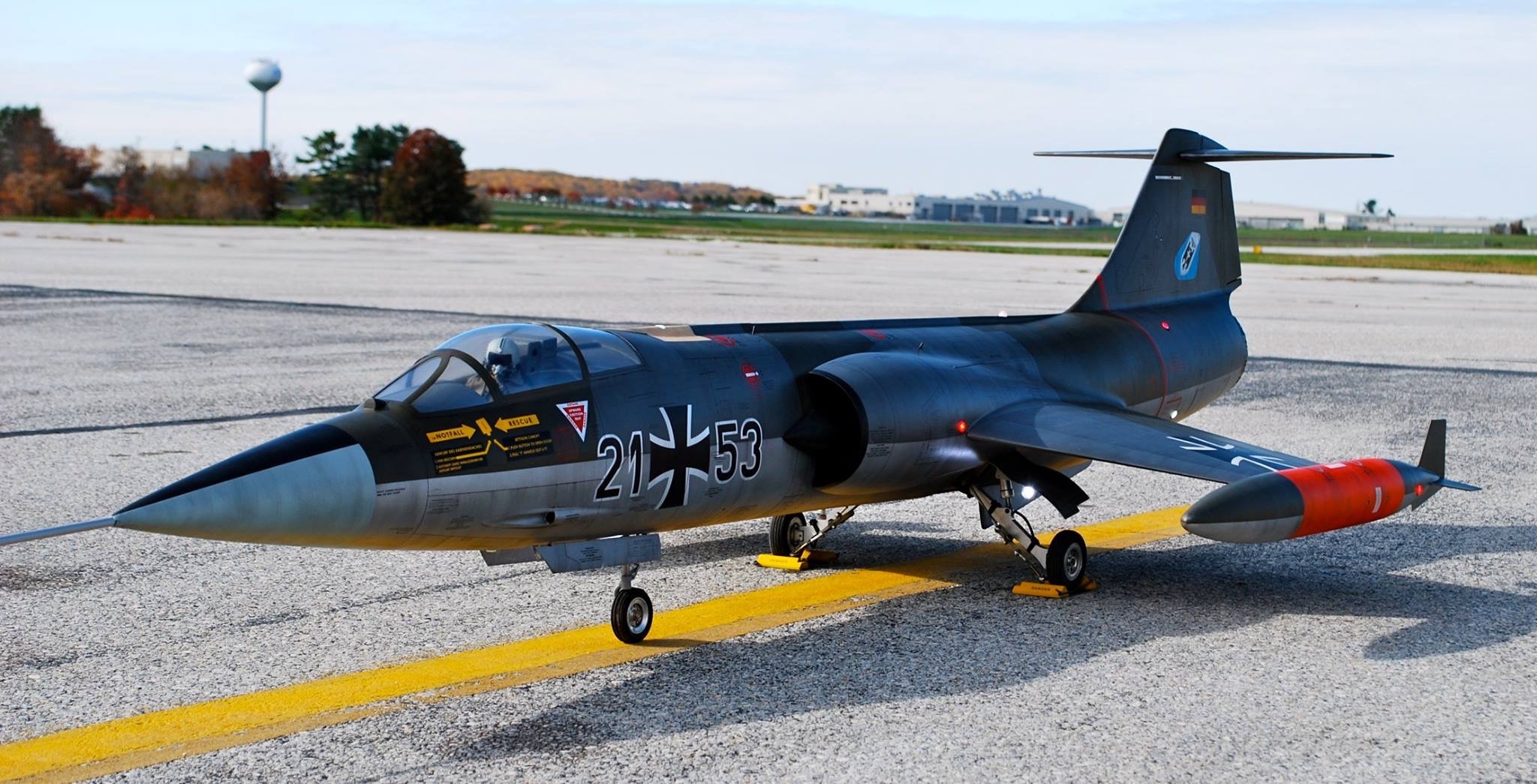

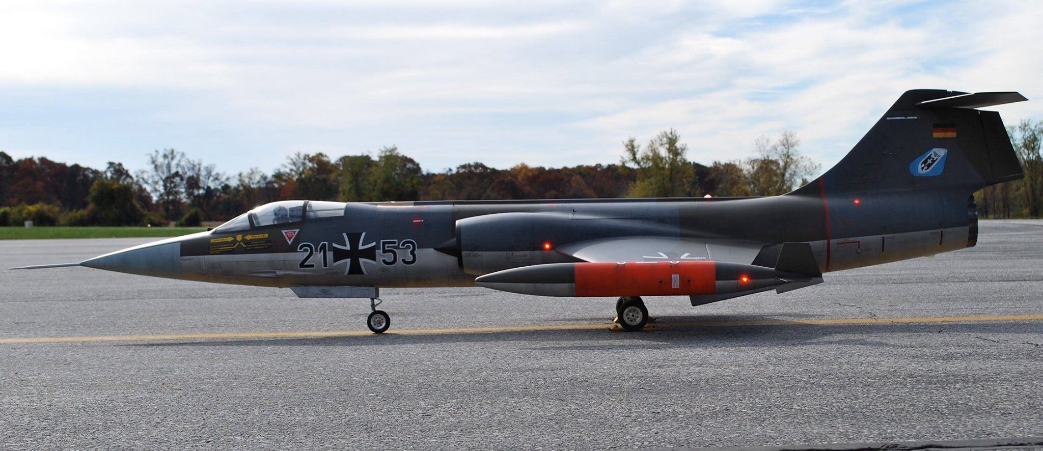

Nice job and tip regarding the soft edge! Unique scheme on the T-33. I did a similar scheme on my F-104.

What type markings did you use and did you clear over everything??

Hi Vince,
made stencils for for the black and white crosses, had local Sign-0-rama make the numbers for $ 5 dollars and he gave me scrap red, yellow and black to make tail markings. For tail sheild and fuse warning marking I blew-up plastic model decals with MS Paint program and printed out correct size markings on white decal paper. I cleared everything with Krylon's new Matt Clear. It's gas and kero proof, but not hot nitro proof.

Sean,
