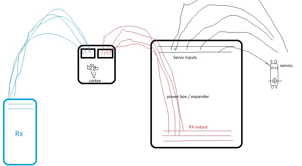

I recently got a unit, although I don't really see whats the big deal with gyros on jets I am willing to give it a try, does anyone have install instructions in jets? Also how are people dealing with high power servos, are you splitting the signal between the gyro and powerbox or having the output go to gyro and then to the rx?

I think its wired this way, basically between the rx and the power expander.

Lol… What an amazing diagram you made!! ;-) Cannot resist sorry…
