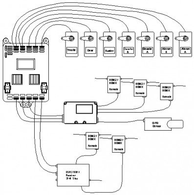

HI all,I have several questions on the setup of a I-gyro with a Power box Royal (non SRS) and a JR 1221 receiver.
1- in this setup, is it true I only need one remote for the I-gyro
2-What is Digital out from the receiver to the I-gyro
3-Is JR remotes the same as Specktrum remotes
Thanks if I can get these 3 questions answered.
Rcpete
PS. if someone could do a scketch, that would be great.

@rcpete: normally our support is in our forum, but for now:
You need at least 2 satellites. You can find a schematic here: http://forum.powerbox-systems.com/vi...chematic#p1516
This is a S-BUS output. If you have a SRS PowerBox you can use this output to go with 2 wires in the PowerBox
Yes, but as mentioned in the other post: donīt mix up DSM2 and DSMX
@JIM: I try to give answers in our forum in less than one hour and also on saturday and sunday. If your manufacturer of the other product does the same - be happy!
I looked for your post, if it is this one, no idea why I missed it- sorry: http://forum.powerbox-systems.com/viewtopic.php?f=13&t=1360
Your answer is posted- this information could have been found in the manual as well.
Also I have seen some earlier posts from you: my answers came on the same day!

HI Richard this schematic is not in the manual, this makes it much more easy to install.
The I-gyro manual has
1-Specktrum system without PB
2-Futaba, M-link, Hott and Jett system without PB
3-Any radio system with PB ( this schematic showsDigital out from I-gyro)
4- and the last one- any control system with SRS PB.
So I see you have 3 remote satellites in your http://forum.powerbox-systems.com/vi...chematic#p1516, so is it 1 or 3 remote satellites
Are you calling I-gyro -- remotes, and receiver---satellites ?
Rcpete

Hi Richard, one of the main problem with the manual is it unintentionally confuses people the way it is written.
The schematics run on to the next , they are not numbered, one does not know which paragraphs belong to which schematic.
Sorry
Rcpete

Hello Pete,
"Remotes" and "Satellites" is the same, just another naming. Spektrum calls them "Remotes" most customers say "satellites"
We take 3 satellites to the iGyro because this are the main functions: Aileron, Elevator, Rudder
