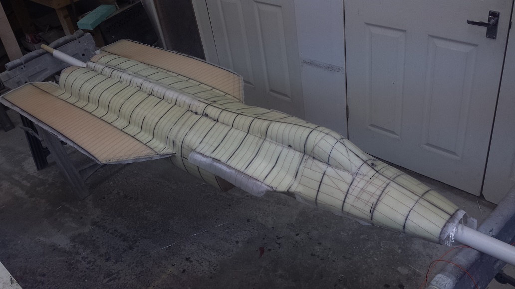

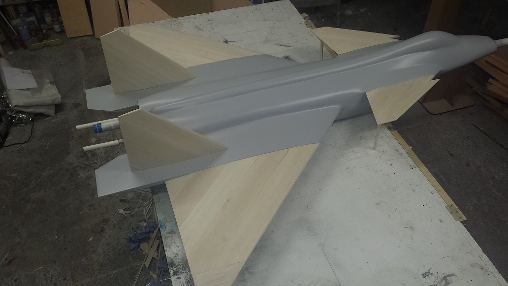

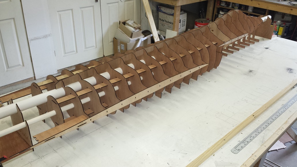

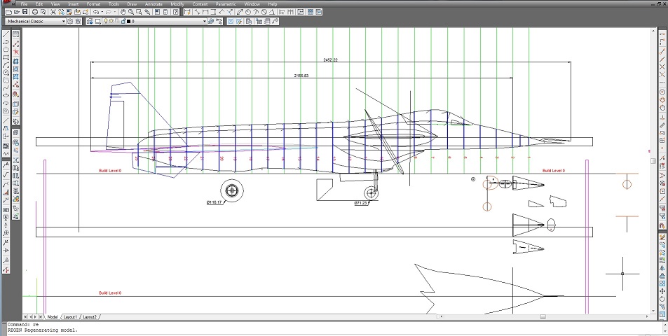

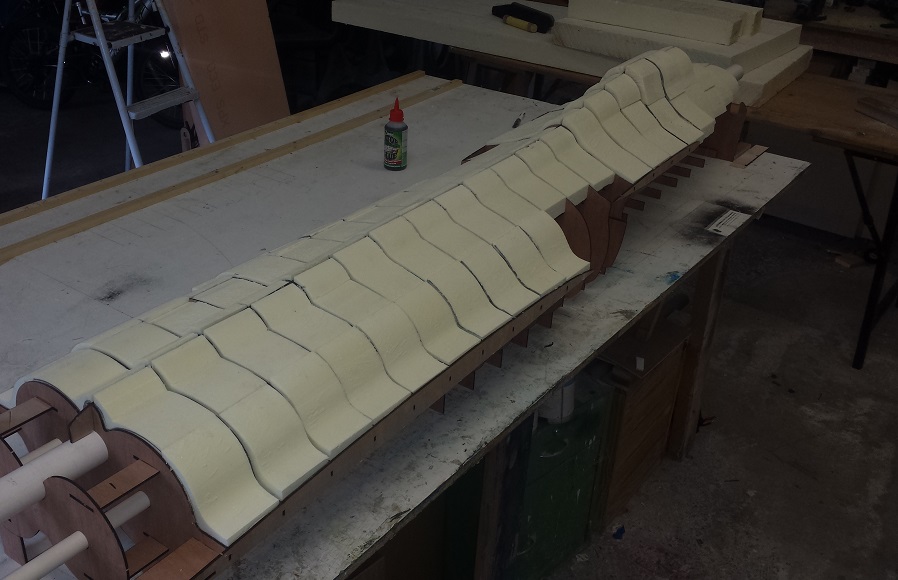

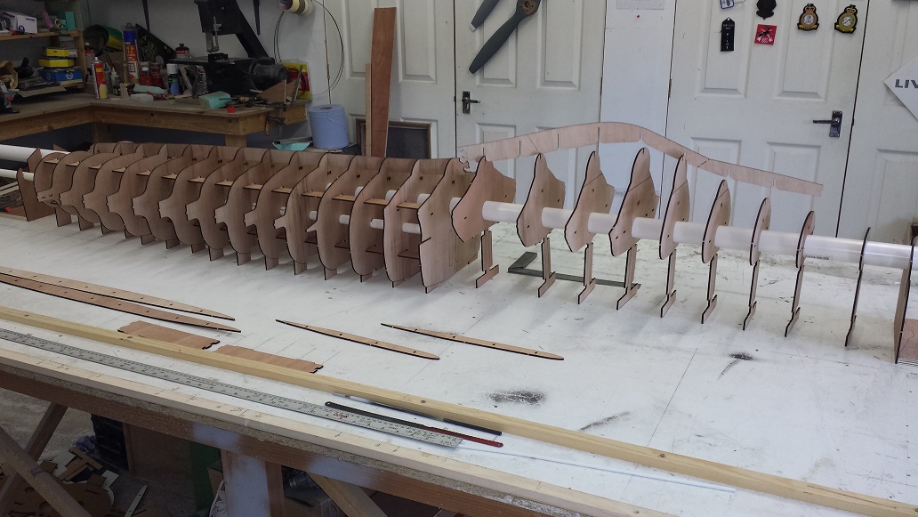

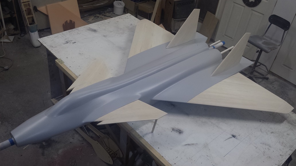

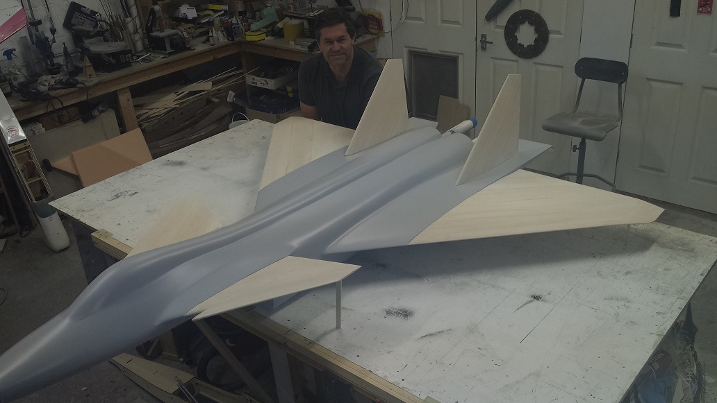

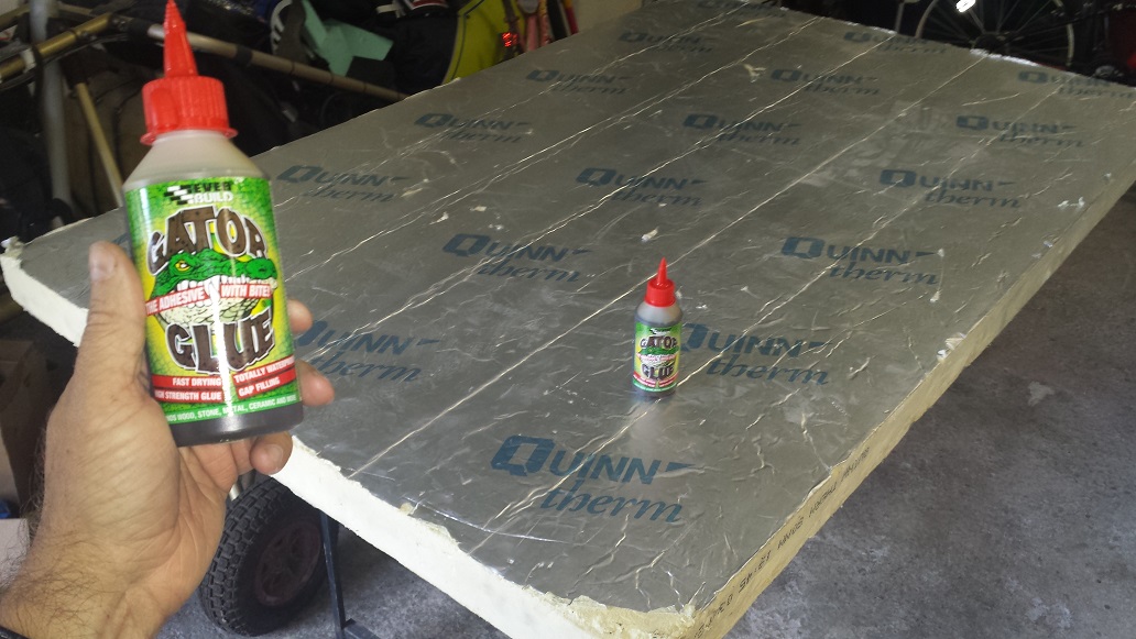

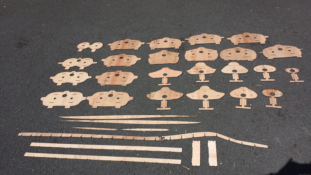

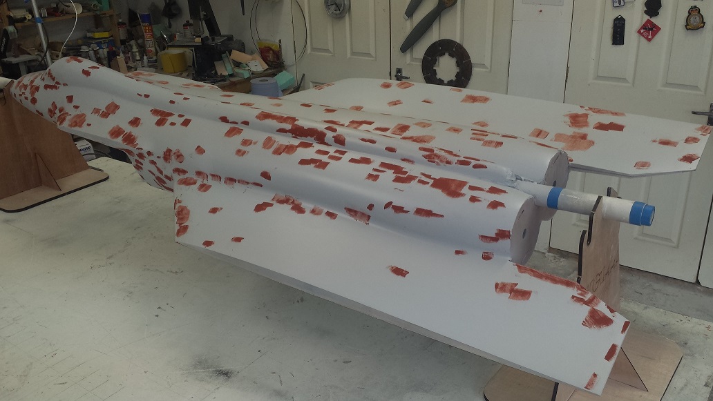

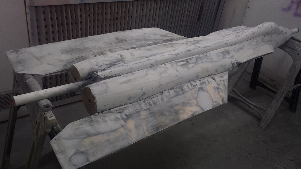

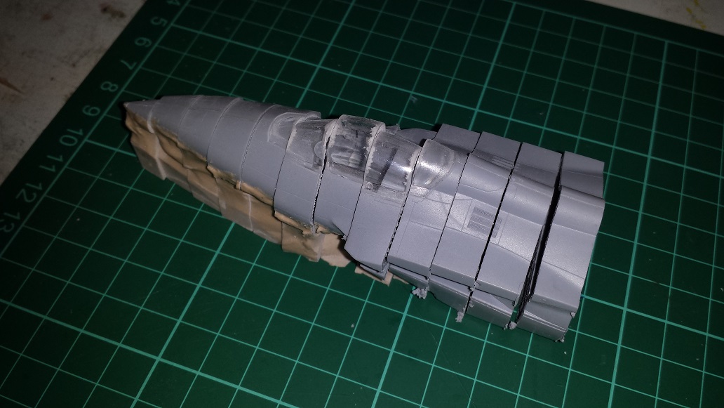

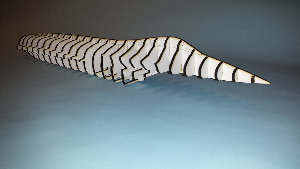

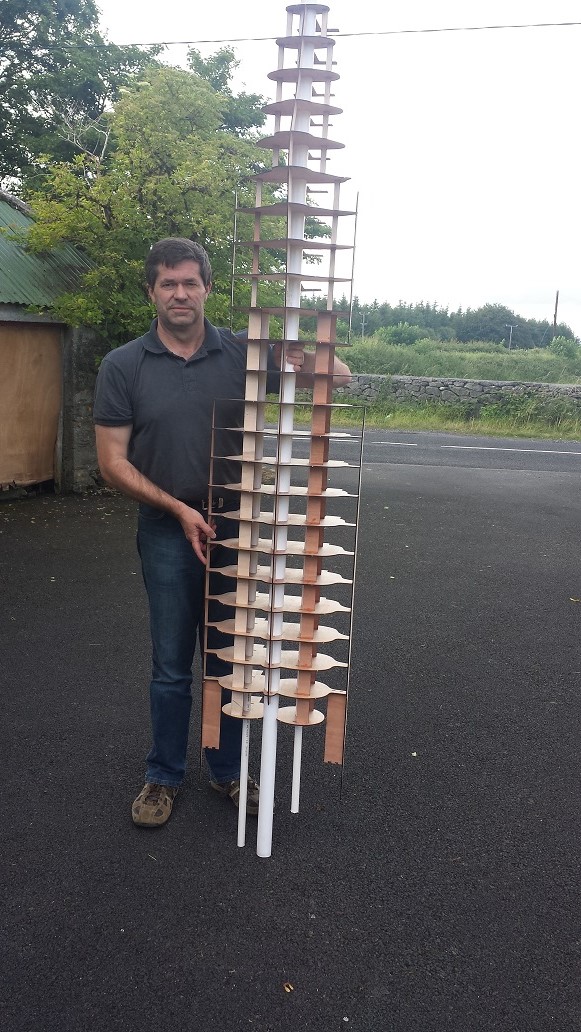

Hello everyone, Seasons Greetings to you all.
I would like to introduce yon to my scratch build (in progress) of the MIG 1.44.
I have designed it at 1/8th scale so it will be able to fit into an estate car with ease. Attached below are just some of the pictures from this past year. As you can see, there is lots more still to do and I do hope you enjoy this as I move on with this project.
Some videos of the build are here on my Youtube Chanel with more to follow as I go...............
https://www.youtube.com/playlist?lis...lLn2--6wIh1Czo

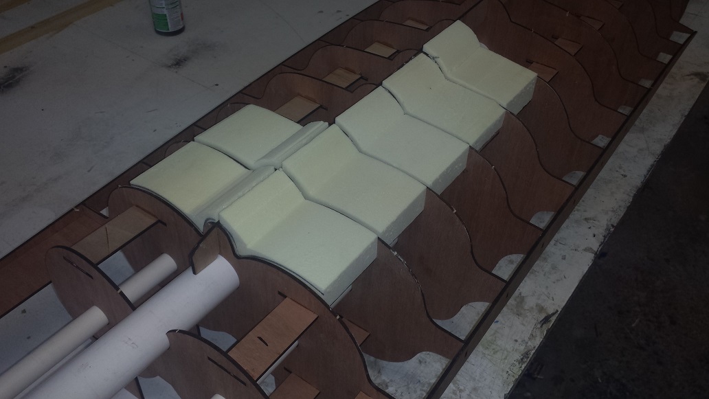

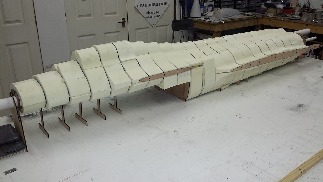

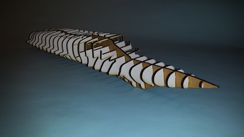

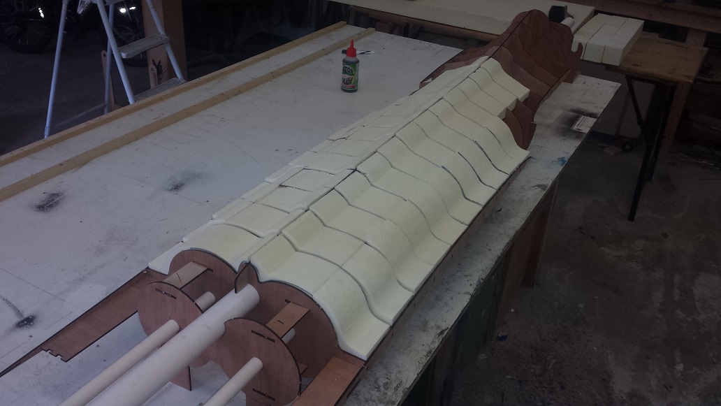

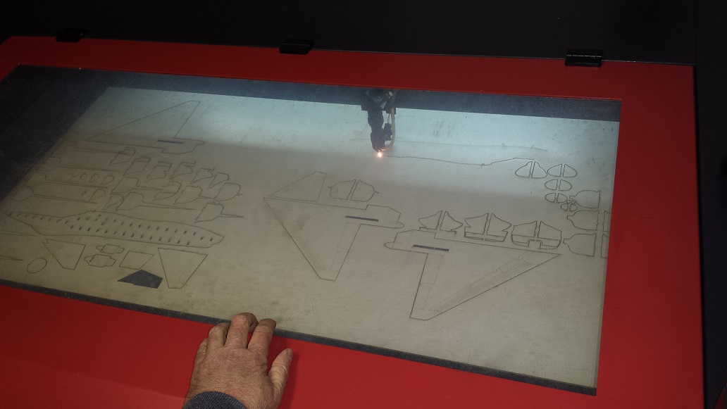

This maybe of some interest on this project.
Video number 2 http://youtu.be/46KRKihvluk A day lasering all the fuselage parts
Video number 3 http://youtu.be/pwCikFfKsfo Adding the foam to the top of the fuselage.
....and so on

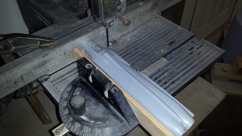

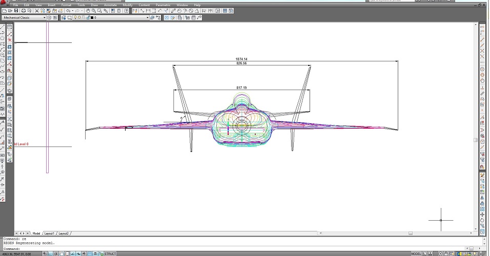

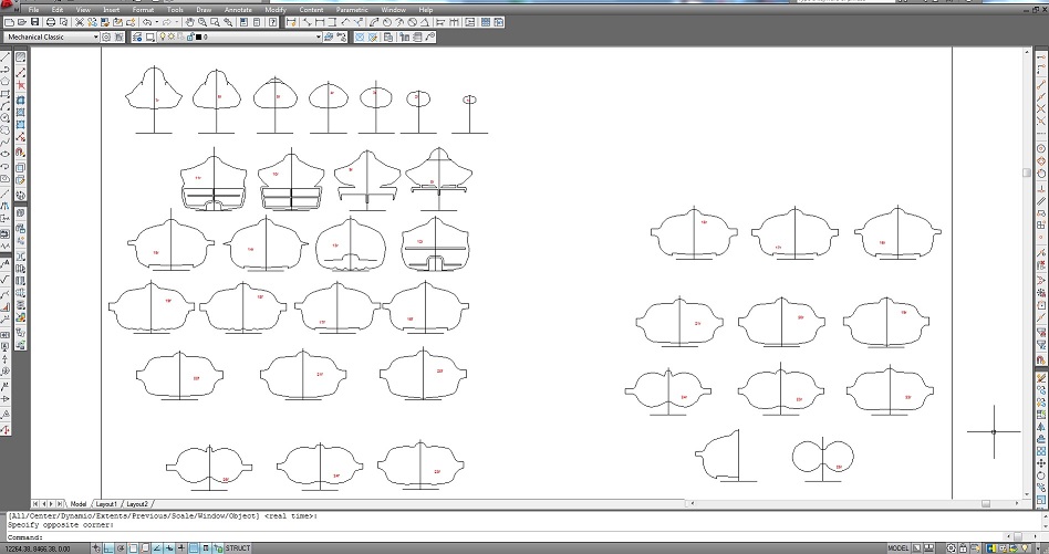

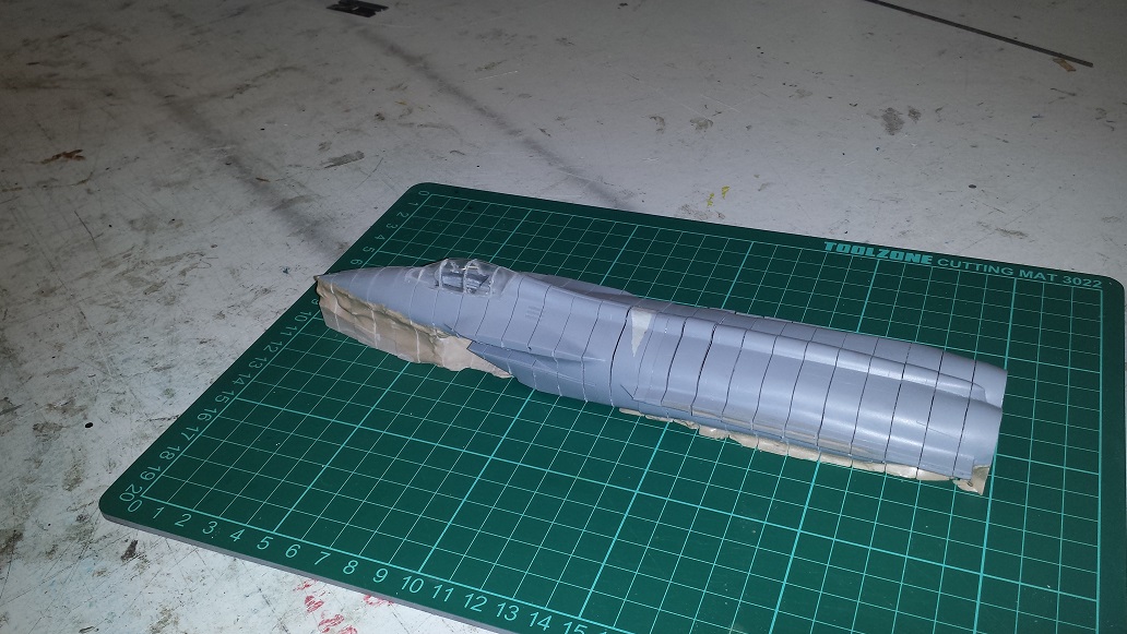

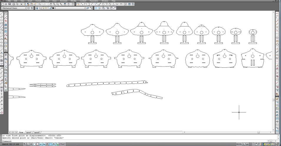

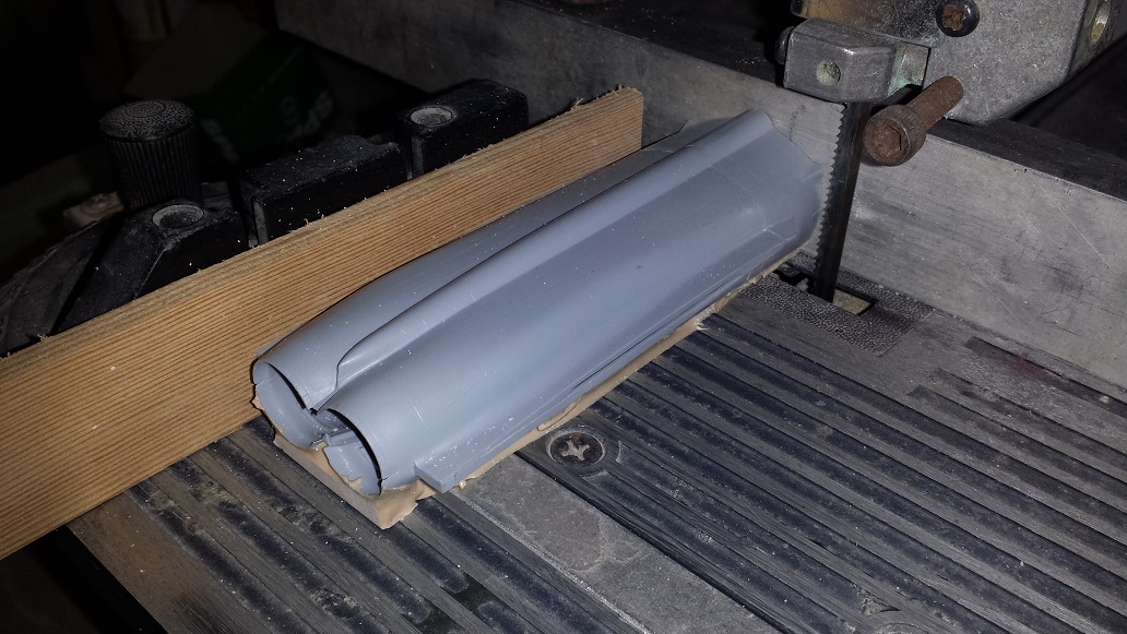

I would like to attempt something like this with a MiG-29. I have a plastic model like you used for yours. After you cut it into pieces how did you input the parts into your cad program? I was also wondering which cad program you use?
I have watched all of your videos. They are an excellent way to see how the whole process is done.
I am looking forward to seeing the progress.
Hal
Old 12-24-2014 | 02:03 PM
dav.ie's Avatar
Joined: Mar 2010
Posts: 68
From: The Workshop, US MINOR OUTLYING ISLANDS
Erbroens, thanks for the post. Happy Christmas to you.
Hal, Thank you for your post too. I scanned all the cut parts in imported them into AutoCAD and InventorPRO. Glad you liked the videos. An again Happy Christmas to you.
Old 12-25-2014 | 09:46 AM
Joined: Feb 2003
Posts: 538
From: Jackson, MS
Dav.ie
Once you have scanned the cut parts into your computer how do you align them with the cad program? I have worked some with cad but I'm not a real expert.
I hope you had a Merry Christmas.
Thanks for the help.
Old 12-26-2014 | 06:04 AM
dav.ie's Avatar
Joined: Mar 2010
Posts: 68
If you note I placed the model on some ca-rbody filler before I cut it up on the saw. This acted as a datum line. When I scanned the parts in I had a ref level and known sizes to scale from. Also then merged with a few 3 vie drawings to see if it all matched. Once that was don, I hit it all with a lot of extra cad work to get the bits needed for final cutting of parts.
